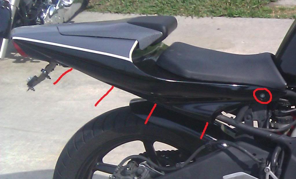

u didnt screw ur rear fairings into ur bike?

The circle is the only bolt, the lines are the little push in type "rivets" that you get at AutoZone.

oh ill looks for thos and yeah i was curious how far up u bolted it in and i got an undertray for the tail for 49 bux on ebay

Sweet... It will make it SOOOOOO much easier on you. Just figure out where you want it, secure the under tray, and set the tail on it. 2 screws, 6-8 rivets, and BAM... All done.
