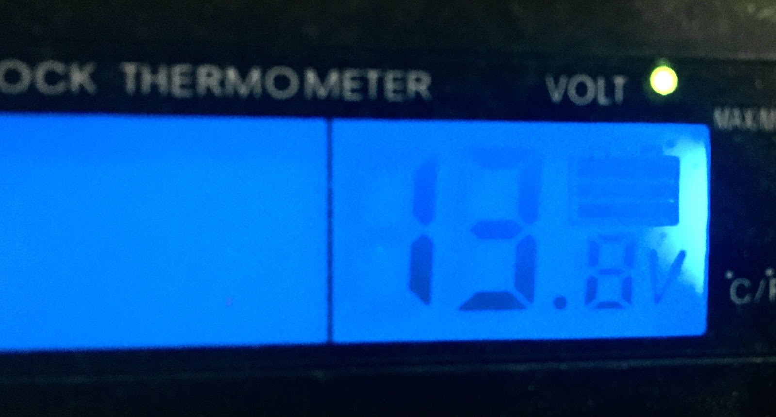

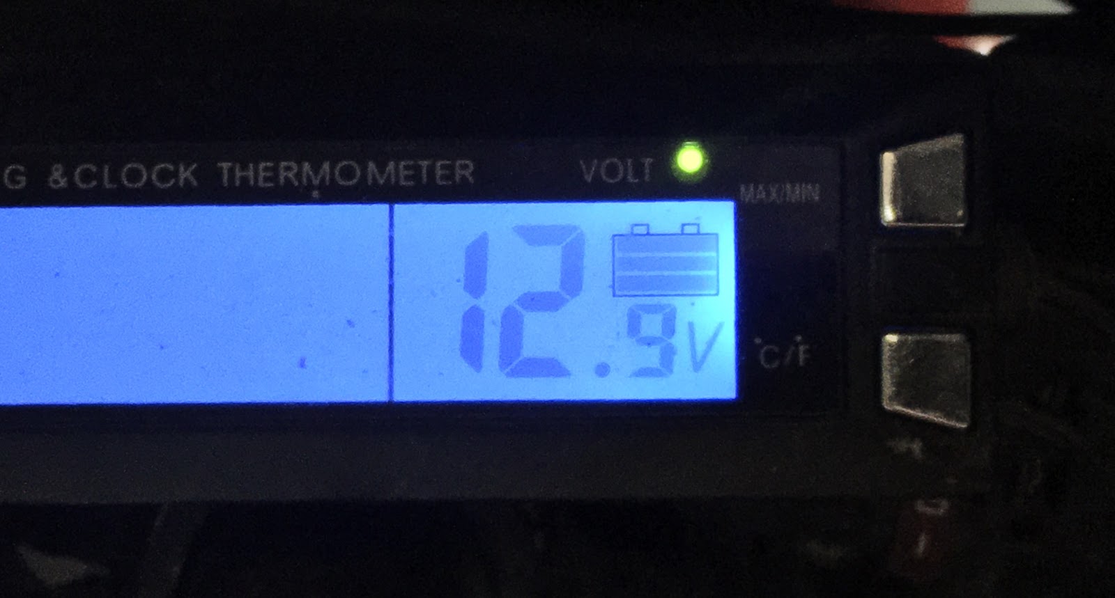

No, still dead battery. When cranking, starter is robbing all available power, dropping voltage severely and leaving nothing to power ignitor.
Measure car battery voltage before connecting to bike, it’s probably dead too. Or your jumper cables are busted. Connect car battery back to car by using jumper cables between battery and battery cables. Then measure do those same 3 tests when starting car. What’s #1-3?
