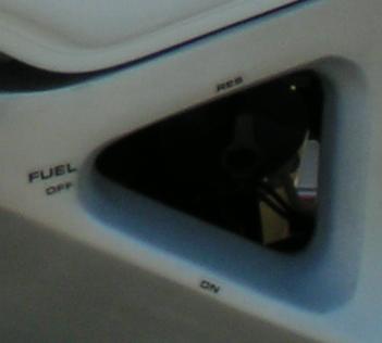

hi so i know that when the switch is parallel with the ground it is off but is up on and down is reserve or is down on and up is reserve. 1996 cbr 600 f3

Arrow up = Res
Arrow forward facing left = Off
Arrow down = On
That is off a '94 CBR 900RR, but it is configured the same as your bike.
