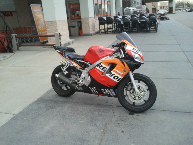

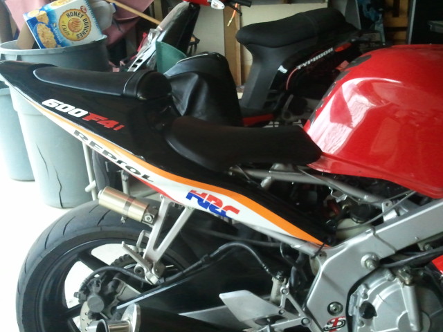

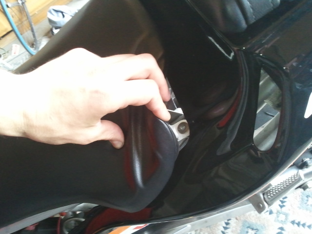

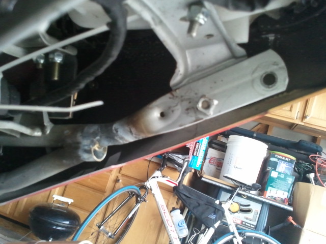

Here are some pics and of the 03-04 600rr tail swap on my F3.
You will need
- Someone who knows how to weld/bend steel (not me)
- 1.5" by 8th inch steel
- 600rr Passenger seat latch hardware
- Nylon spacers
- Velcro
- Tail light
Took me about 5 hours.

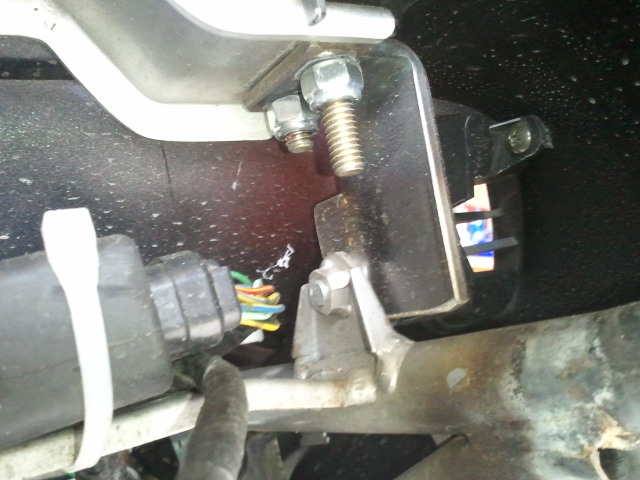

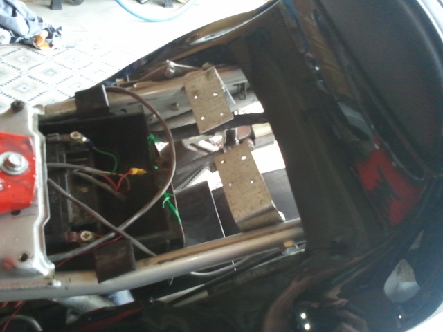

The first thing i did was take a piece of steel that was shaped in a L with a lip on the top so that the mounting was moved back a bit less than a inch. the easiest way to do all this is have a friend hold the fairing where you want it and then take some measurements. I used the same mounting holes that the f3 seat screws into.

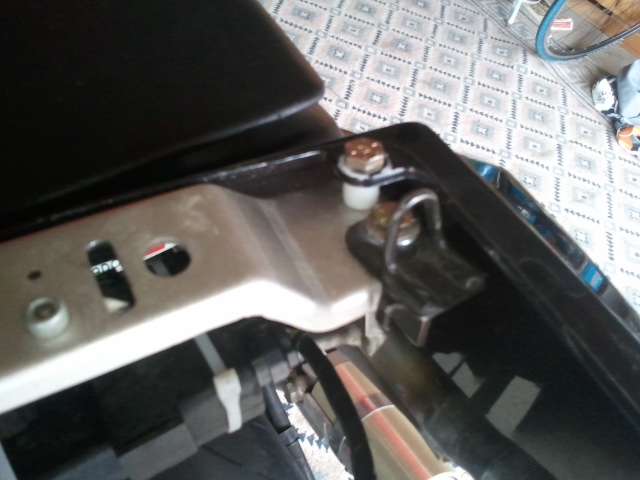

Note the nylon spacers between the bracket and the fairing. You must have these or else the seat wont sit flush

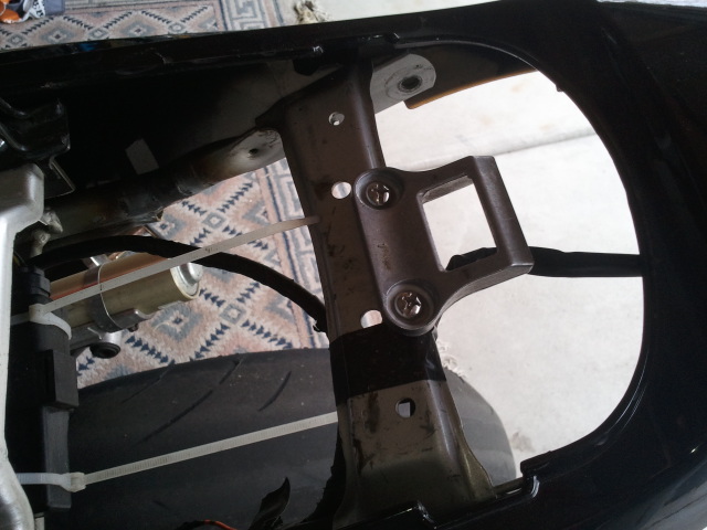

After this I heated and bent up the rear of the tail, I got lucky and was able to use this piece for the latch that the passenger seat hooks into.

The rider seat luckily has these mounting tabs underneath. I slid/wedged this tab under the fairing and it was surprisingly sturdy considering I bought the cheapest fairings I could find on ebay.
I also took some L brackets from the home depot and drilled into my frame to add extra support

The 600rr seat isnt as uncomfortable as I thought it would be, the longest ride i have been on so far is about a hour and a half and my butt didnt go numb or anything. It does feel like its at a quite an angle which makes me reconsider putting a f4i shock on the back...
