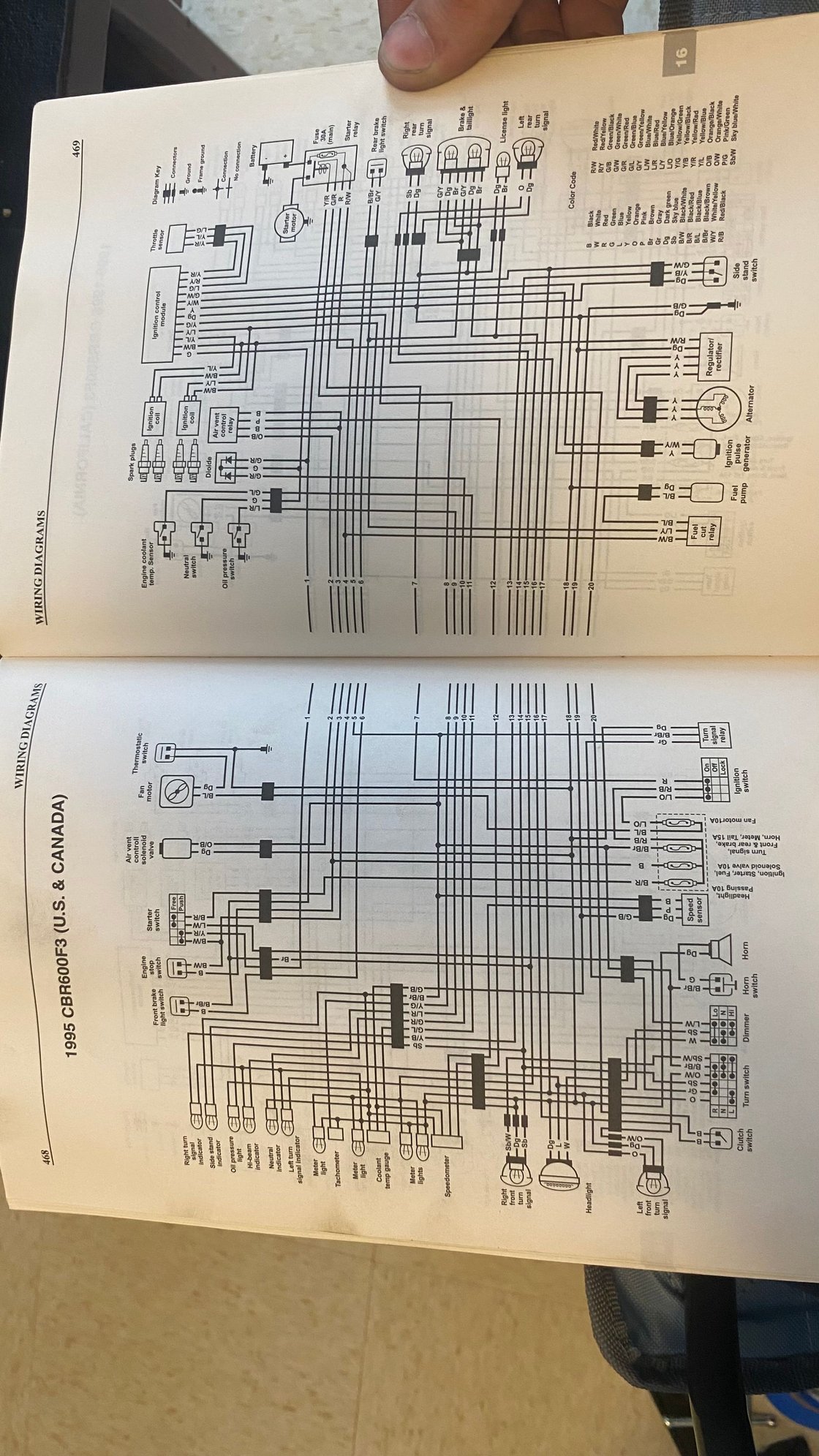

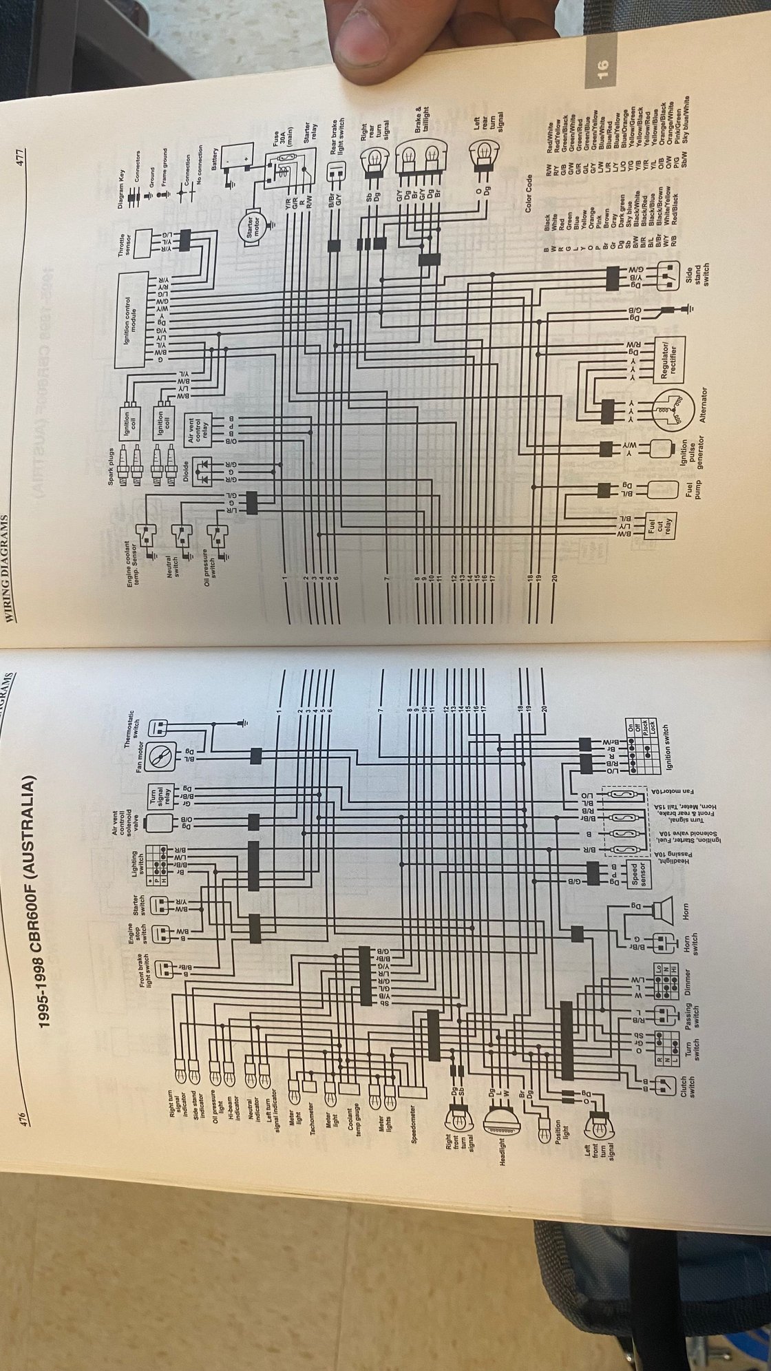

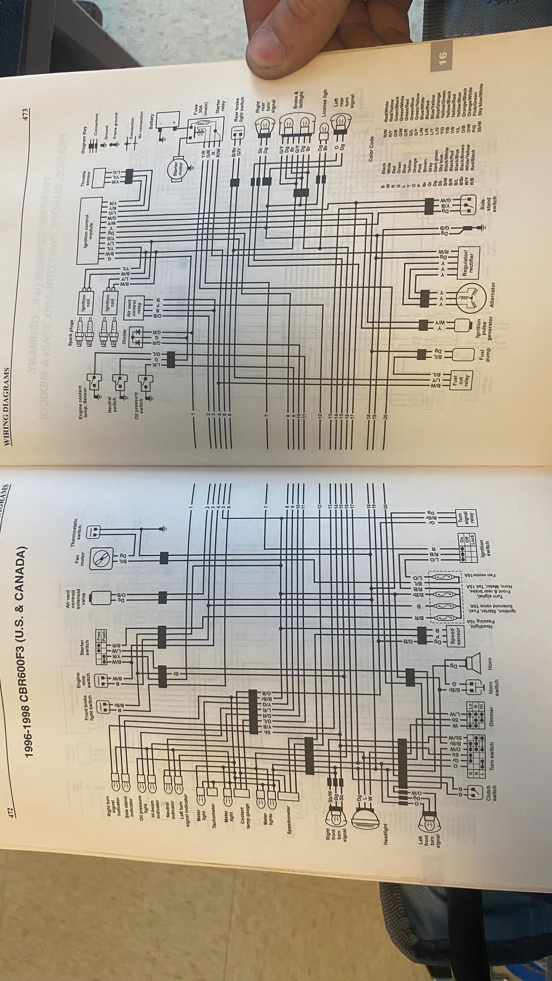

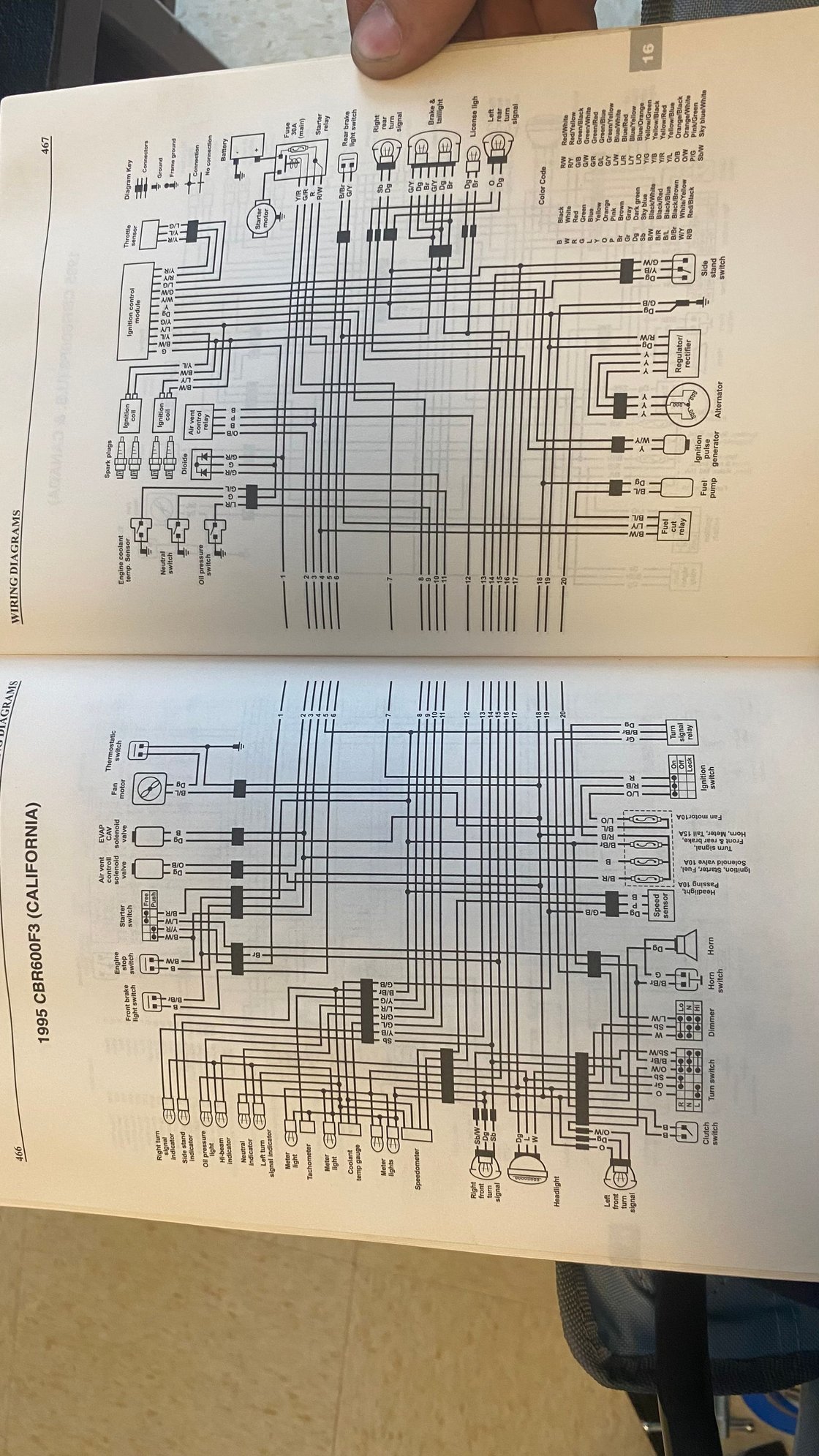

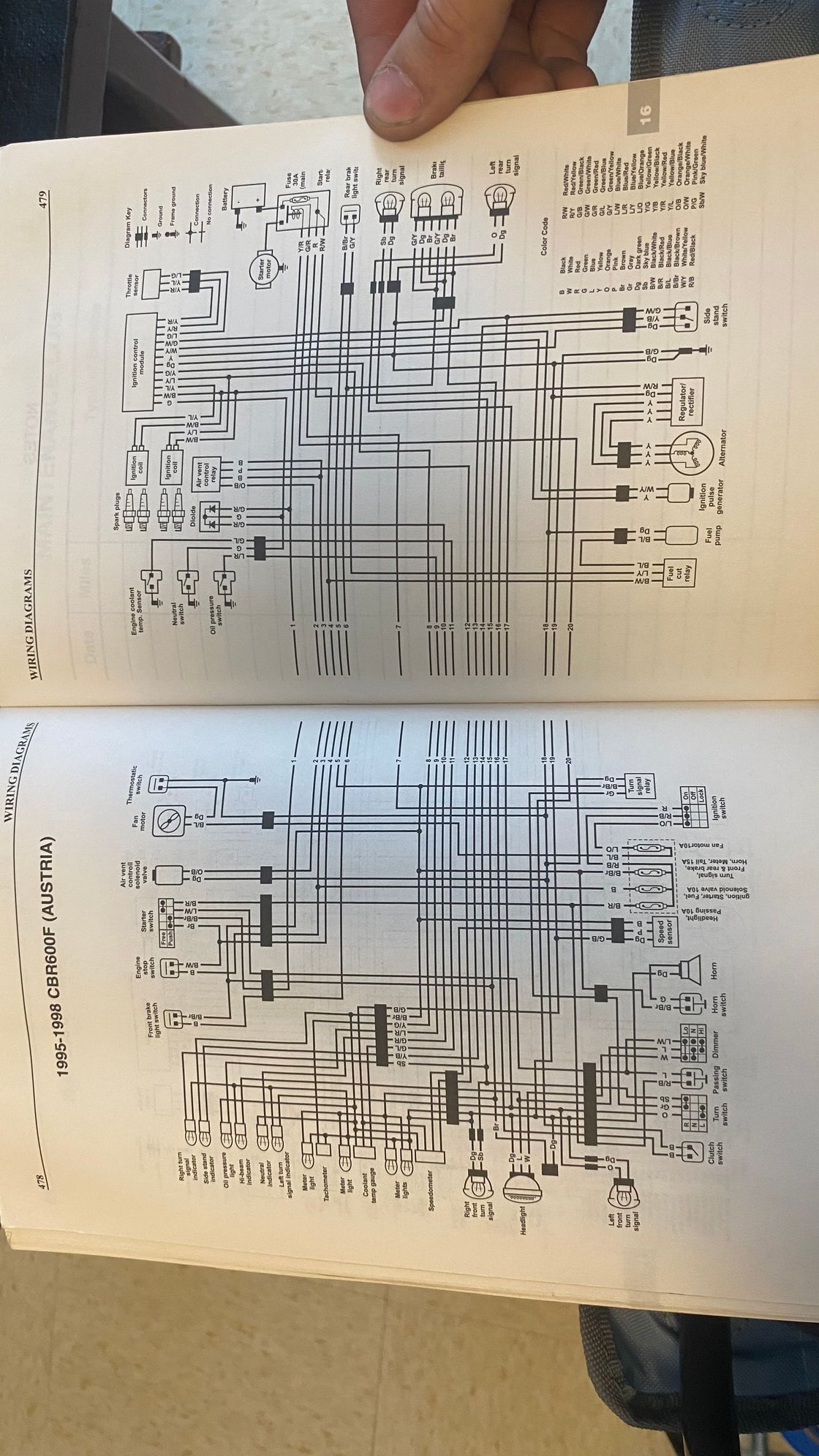

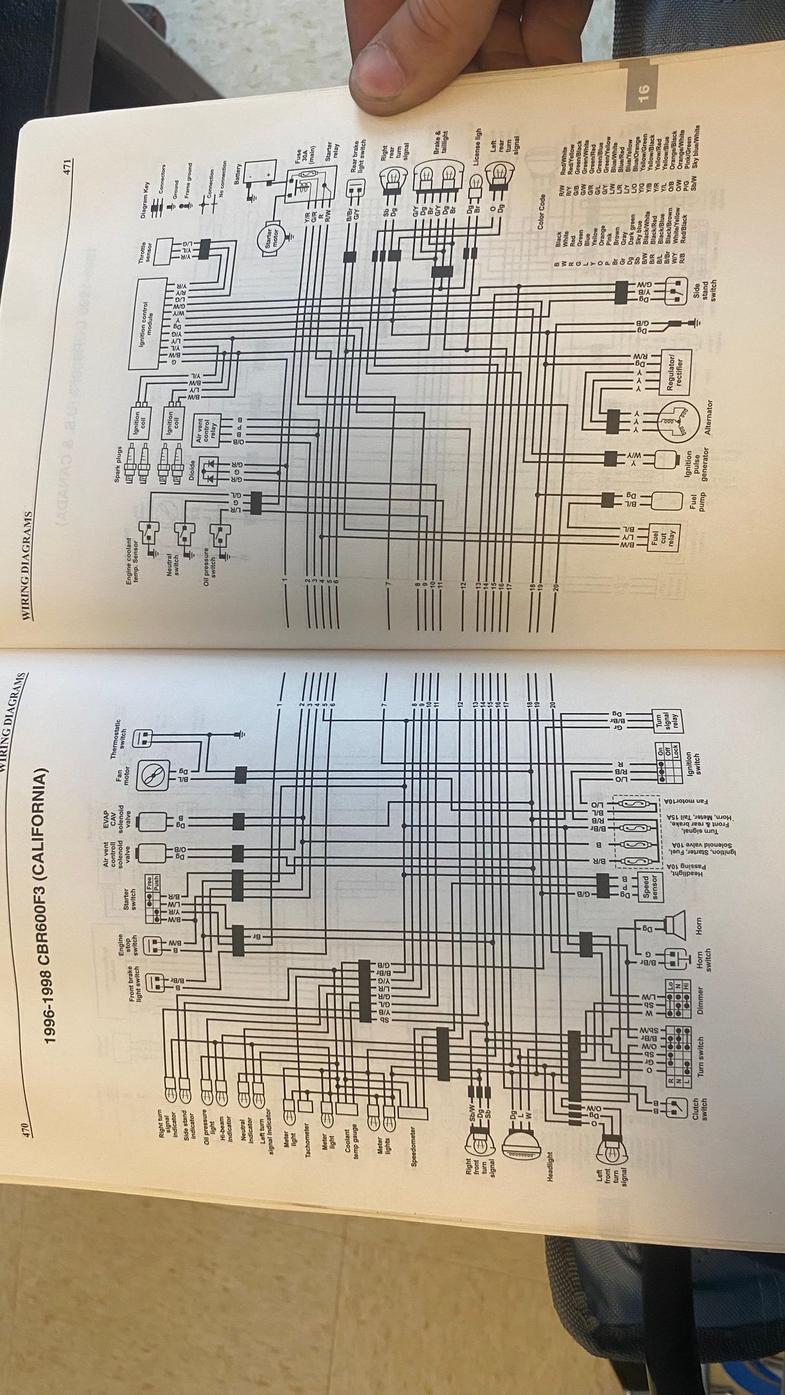

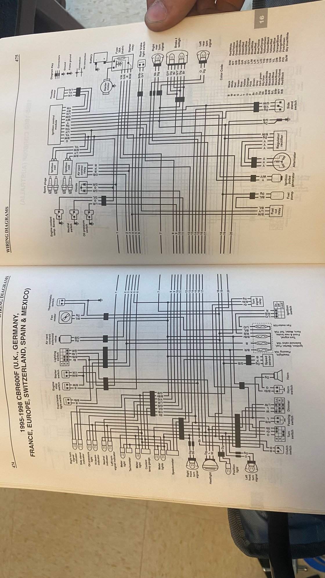

Old Feb 11, 2025 | 08:15 AM
patrick71669's Avatar
Joined: Mar 2024
Default here are some wiring diagrams for the cbr600 f3
hope this helps
