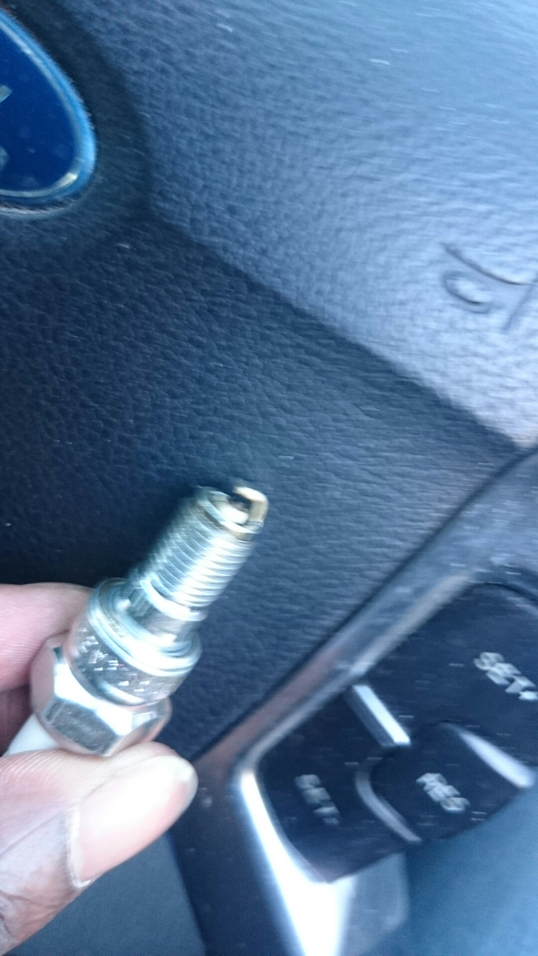

OK so the old and new plugs have spark, attached a photo of the new one. Only bought the one plug to replace the one in the cylinder as it wasn't firing. So the other plugs are old.
Can smell the fuel on the plug that I have just taken out as well.
I'm at a bit of a loss here. But wandering if it ever had all cylinders working. As I do remember it wanting to die at times previously but put it down to being cold. Then I'd get straight onto the motorway from where I was and with it being my first bike I don't really have anything to compare it to.

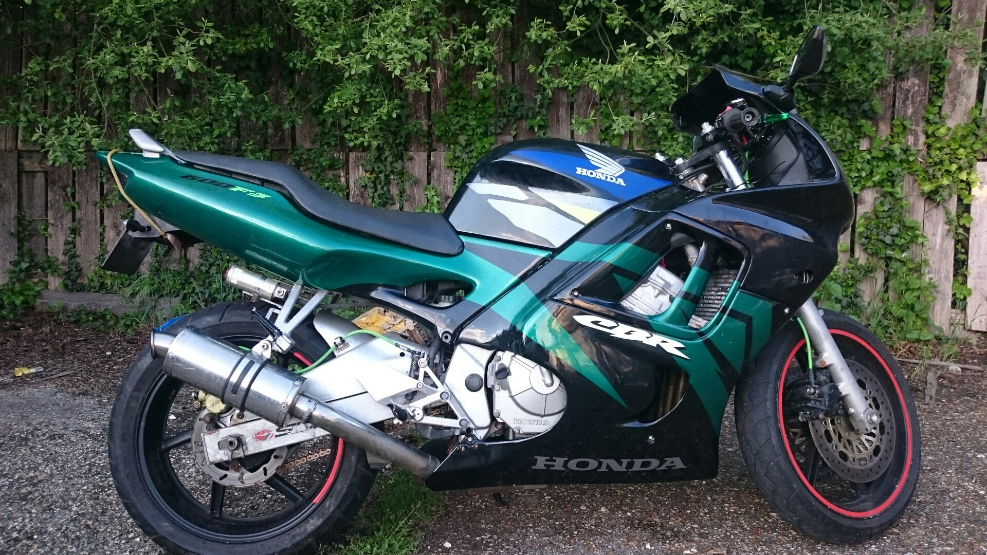

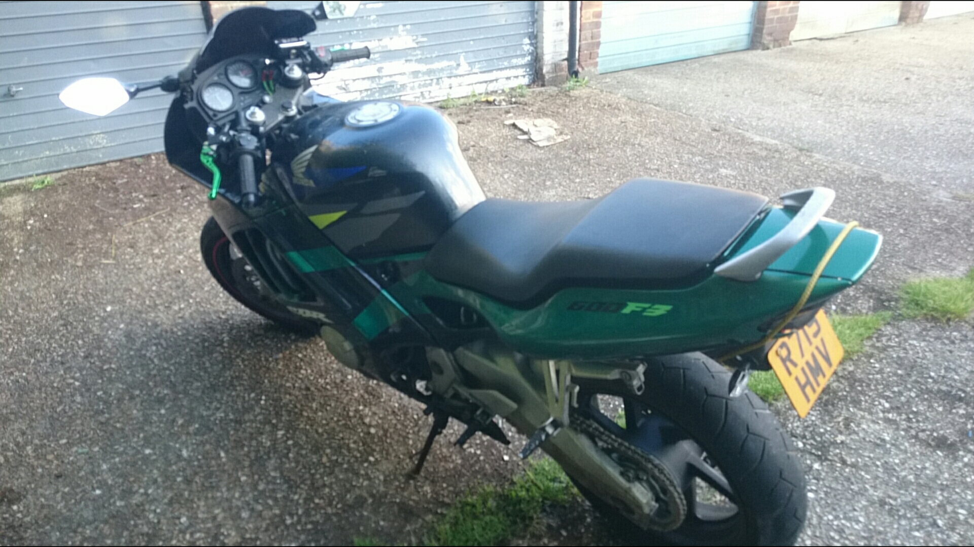

And just for fun, here she is. The grubby little mare. Need to get her MOTd so I can take her home and clean her. She's stored in a garage away from the house with no utilities at all.
