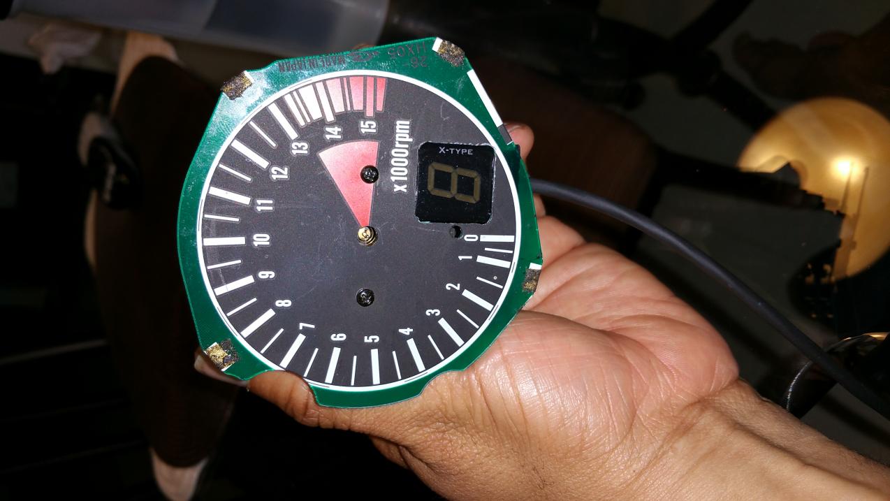

Whats up forum, haven't posted anything for awhile now but I have been working on a few projects for my bike. One of the projects have been a location for my gear indicator, I wanted to do something a little different and place it somewhere so that it looked stock. Let me know what you think.

Looks very OEM

Thank you sir. It fits perfectly under the tach face. Sorry the picture is sideways, it loaded that way and I don't know how to change it.

What is the manufacturer of the indicator? is it a Gipro?

How the hell can you wire that in? Is it automatic? Or are you drilling and tapping a gear sensor in the drivetrain?

No. Except for the cutting away of the tach face and drilling a small hole for the wire to come through, their is no drilling a tapping into anything for the gear indicator to work. You route the wire to your speed sensor and go through the gears. It has really good instructions that comes with the unit.

Yes it is a GIPRO.
