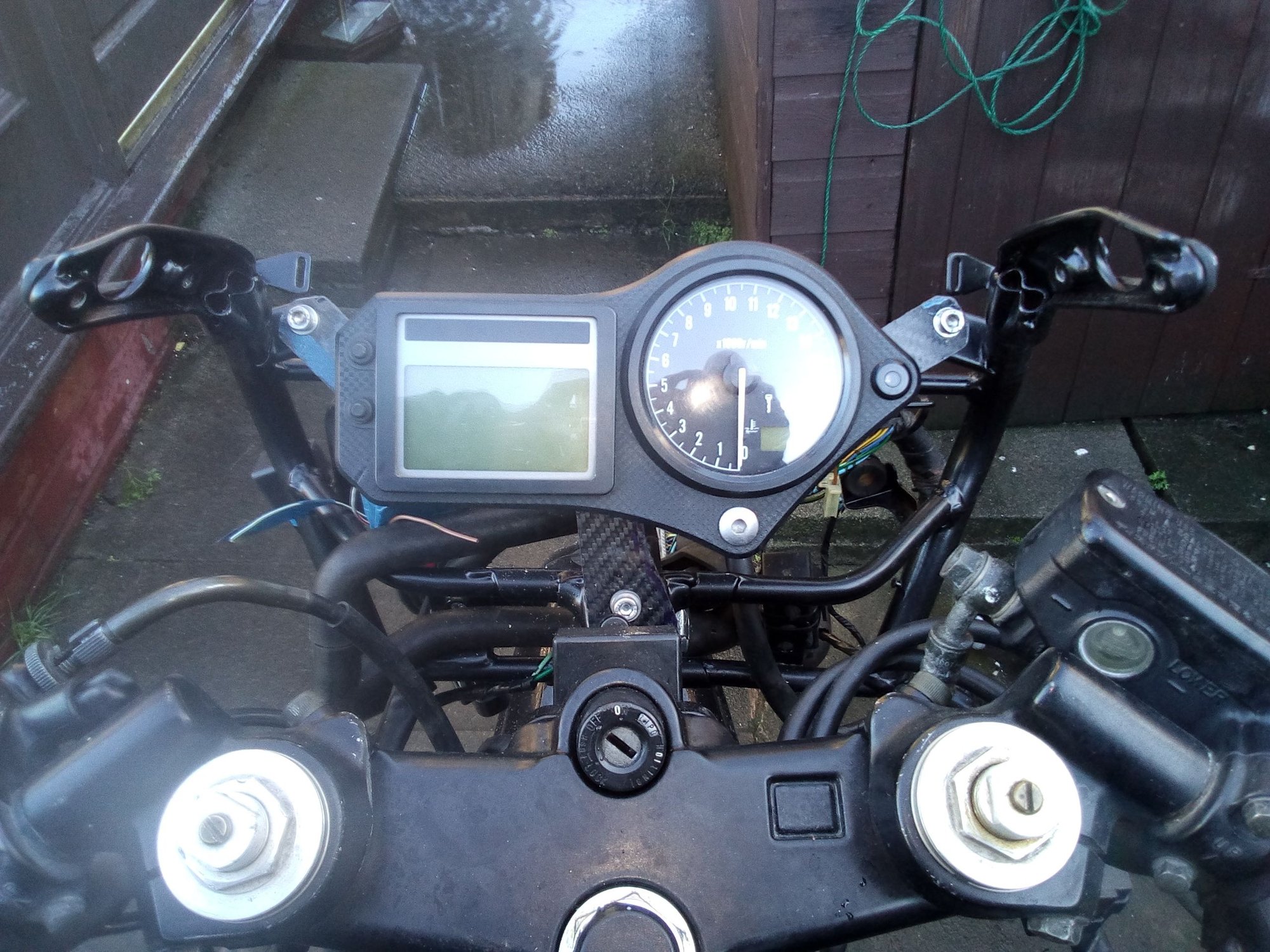

Old Jan 23, 2019 | 04:36 PM
PaulM's Avatar
Joined: Jun 2016
Posts: 25
From: England

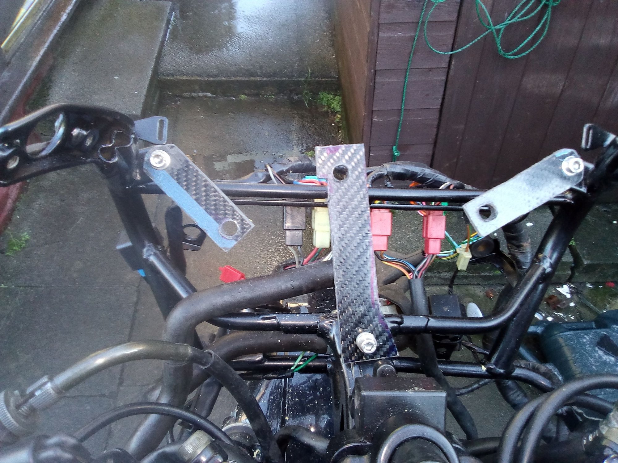

100% better looking, just making some brackets to hold them onto the original clocks mounting points
Old Jan 23, 2019 | 05:42 PM
gamekiller7's Avatar
Joined: Oct 2012
Posts: 121
Looks good! I did an RR body swap on mine and took some cardboard and fit it to my opening and then took abs plastic, copied the cardboard and that's what I mounted my speedo to
