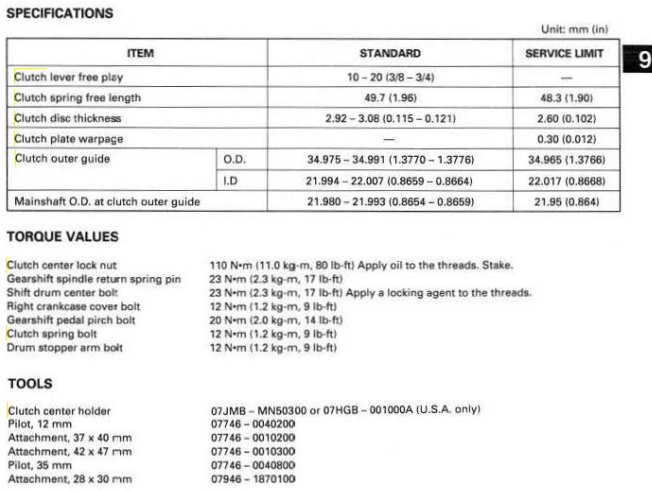

Hi all!
About to dive into changing my clutch springs as I'm getting slippage at around 10k in fourth, even when warmed up.
Plan is to scuff up the steelies, check the fibres for damage and swap out the springs. Blew most of the budget on a new headgasket, new camchain, Oil Cooler O rings and getting a ton of mayo out of the jacket last month so hopefully this little maintenance will do for a bit - I commute so I can't mothball the machine.
Can anyone give me the torque settings for the centre nut and spring retainers? Also do you take the springs out before removing the pack or take the pack out and remove the springs on the bench?
Thanks!

hey Rickee,
from the manual:
*dont forget to oil the threads on the centre nut
