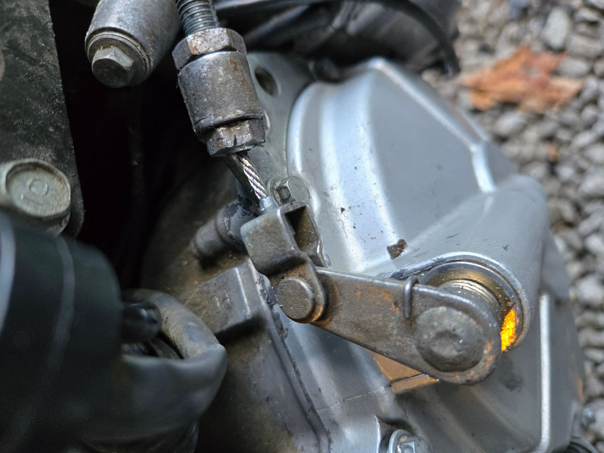

Yeah, new bolts didn't break this time, but I'm still having issue with the clutch. It feels like there is no tension in the arm that gets pulled by the clutch cable. When the bolts are torqued down all the way for the clutch springs I can easily pull the lever with my hands. (Sorry, I don't know the part name and I don't a have the manual immediately on hand at the moment.) I'm out of ideas. Me and my dad can't make sense of how this thing is supposed to operate. Are the clutch springs supposed to be bottomed out or did I get a bad set from Barnett?

Old Oct 8, 2025 | 03:32 PM
SpazmaticAA's Avatar
Joined: Oct 2025
Posts: 8
Added a GIF of the clutch arm I'm talking about.
Old Oct 8, 2025 | 03:39 PM
Posts: 7,177
Here is a link to a .pdf version of the f3 manual.
Do you see the arm (down by the clutch) moving at all when we squeeze the clutch lever? Page 3-21 of the manual goes through the adjustment process of the lever.

Oh yeah, I can see the clutch arm move when I pull the handle bar lever. I'm adjusted all the way out at bothe the bottom and top adjustments. I absolutely should be slipping the clutch if not completely disengaged.

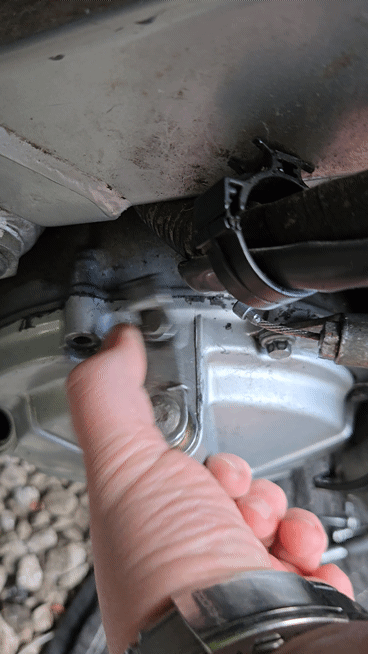

This is the end of travel at the clutch arm with the clutch lever pulled.
Old Oct 8, 2025 | 04:12 PM
Posts: 7,177
You shouldn't be able to move that arm with your thumb like that. Check the manual to ensure everything is installed correctly. There should be a spring for each of the bolts you installed. Do you have those?
