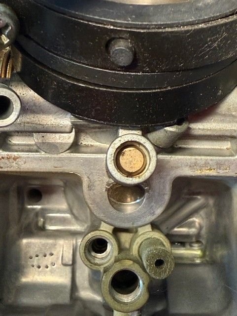

Restoring an 1996 F3 rebuilding the carburetors and could use some suggestions how to remove the jet which does not have a slot for screwdriver. Does this jet take a special tool? The rebuild kit does have new replacement jets. Thanks for any suggestions you may be able to provide in advance!

I don’t think that’s a jet, I think it’s a blanking plug covering a blind passageway.
I could easily be wrong, maybe one of the more experienced members could confirm?

That is not a jet. It isn’t removable.

that screw that looks like a circle with a flat edge to it is the mixture screw, turning it in leans out idle mixture, turning it out enrichens idle mixture.
You will need a special tool for that bit, some people claim to have luck turning it using a .22 bullet shell casing but the brass was too soft for me.
Probably worth dremeling a notch in it so you can use a regular screwdriver to turn it in the future

I do need to apologize for my previous incorrect comment. I was on mobile and didn't pay close enough attention to the picture. That is indeed the fuel/air mixture screw.
I have never seen a completely round one. That is truly odd. I don't think the d shaped tool will help, hopefully I am wrong. I can offer 2 suggestions. I've used an empty .22 rifle shell casing before. That might do it. Also, you can take a very fine-toothed hack saw blade and cut a groove in the head of it. Doing this will also cut a groove in your carb body. If you are careful, it will not adversely affect anything. If you do this, you can use a straight slot screwdriver.
When re-inserting the screw, be very careful. When you screw it in, you want the tip of the screw to just seat in the bottom. The instance you feel that, stop. The tip isn't strong. If you over tighten, you can break off the tip of the screw in the carb. When you do that, you are done. I've never been able to extract a broken tip out. At this point, you are looking for a new carb body. It's not hard to get it right, just be aware.

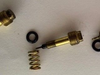

Was able to purchase a set of carb tools with two different size "D" tools for only $10 and worked like a charm. Glad I was able to get the polit screws removed and replaced as the old ones were in bad shape. The "O" rings had deteriorated and were very brittle. One of the "O" rings was bound to the polit screw.
