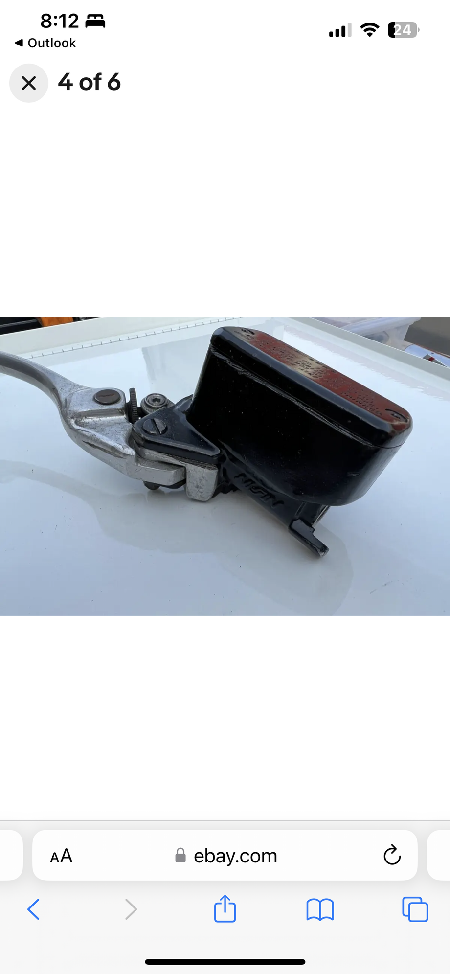

Would you suggest the culprit is having an eBay front brake lever master cylinder?
the OEM is much larger and maybe will bleed right away? All of the caliper rebuild videos move on to bleed and finished. They don’t mention the long amount or large quantity of bleeding.
I say this in dénouement of having a matching hydraulic clutch master cylinder and was defective and didn’t flow. This front brake lever has never had issues.
Old Jul 5, 2023 | 05:49 AM
Posts: 2,568
Shouldn't really be an issue. If it was working ok before then it should be ok for now.
I suppose it would depend upon how far back the pistons have been pushed back that would determine how long the bleeding would take.
Some folk also use pressure bleeders to carry out this task so may be easier than manually doing it.
