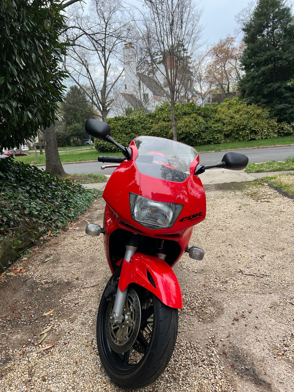

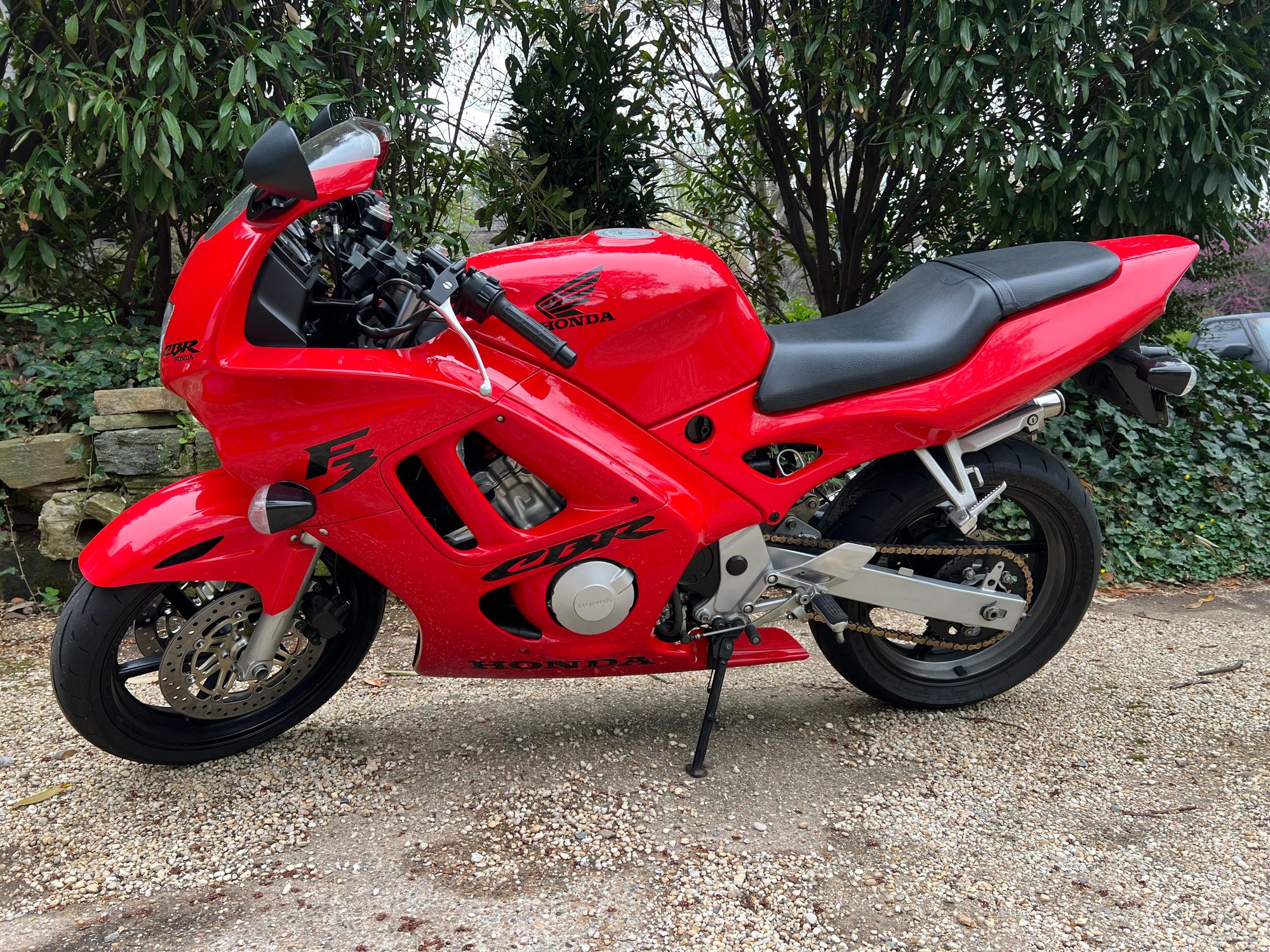

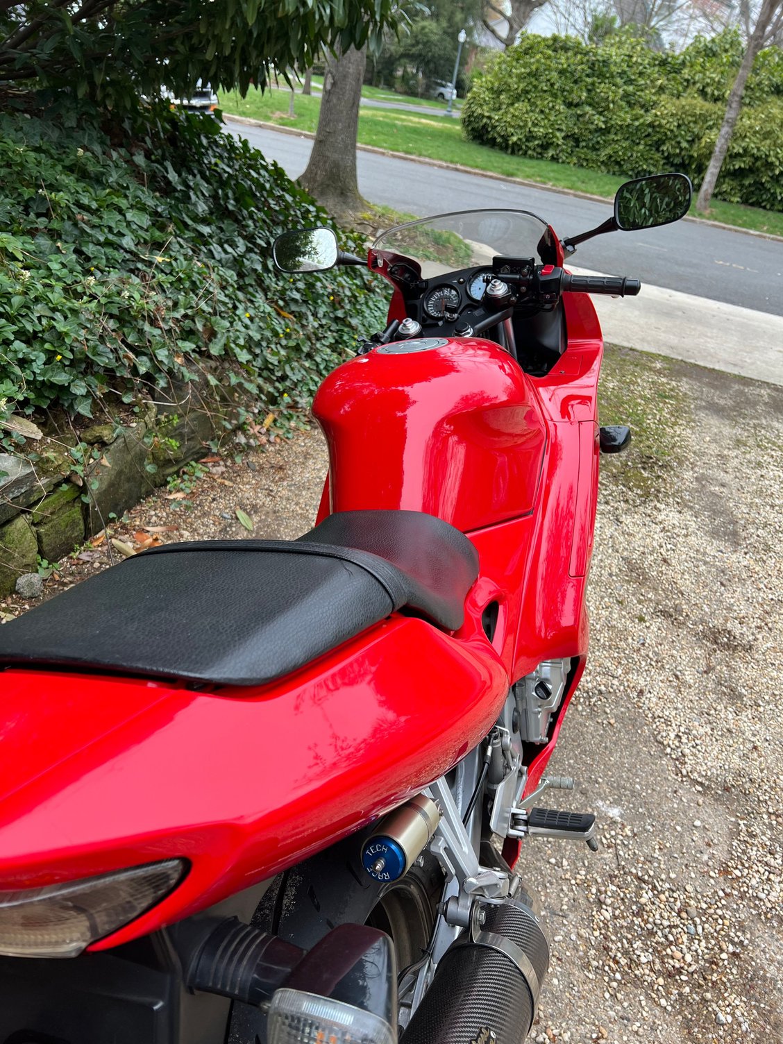

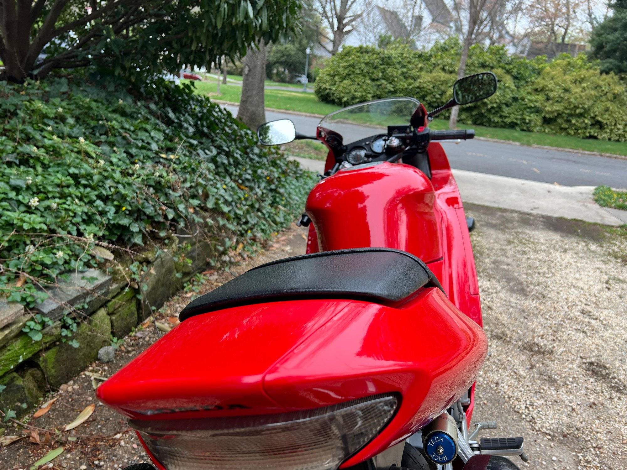

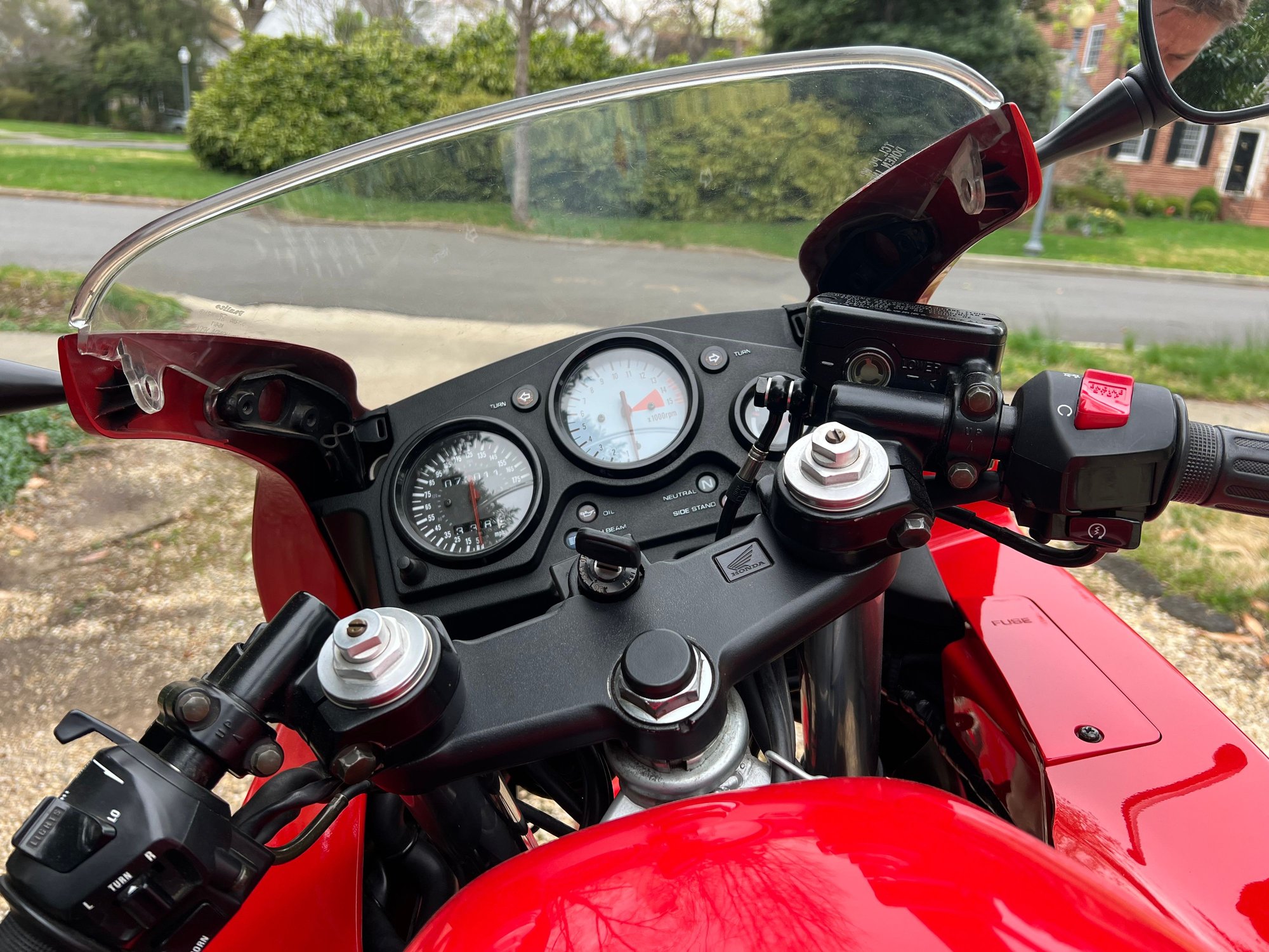

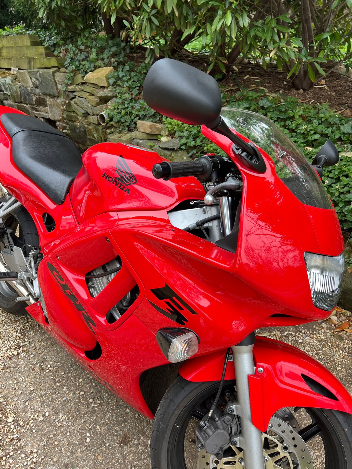

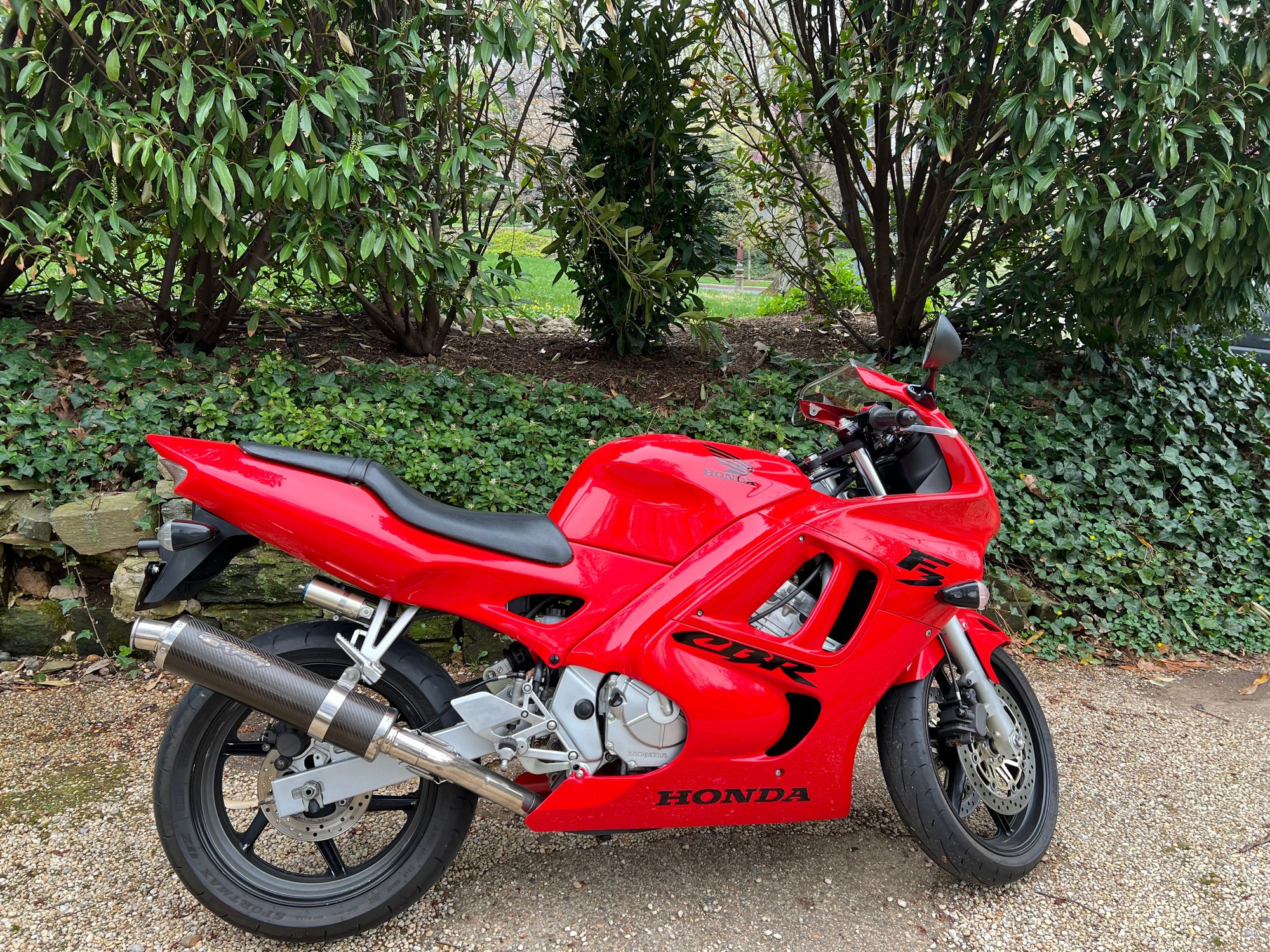

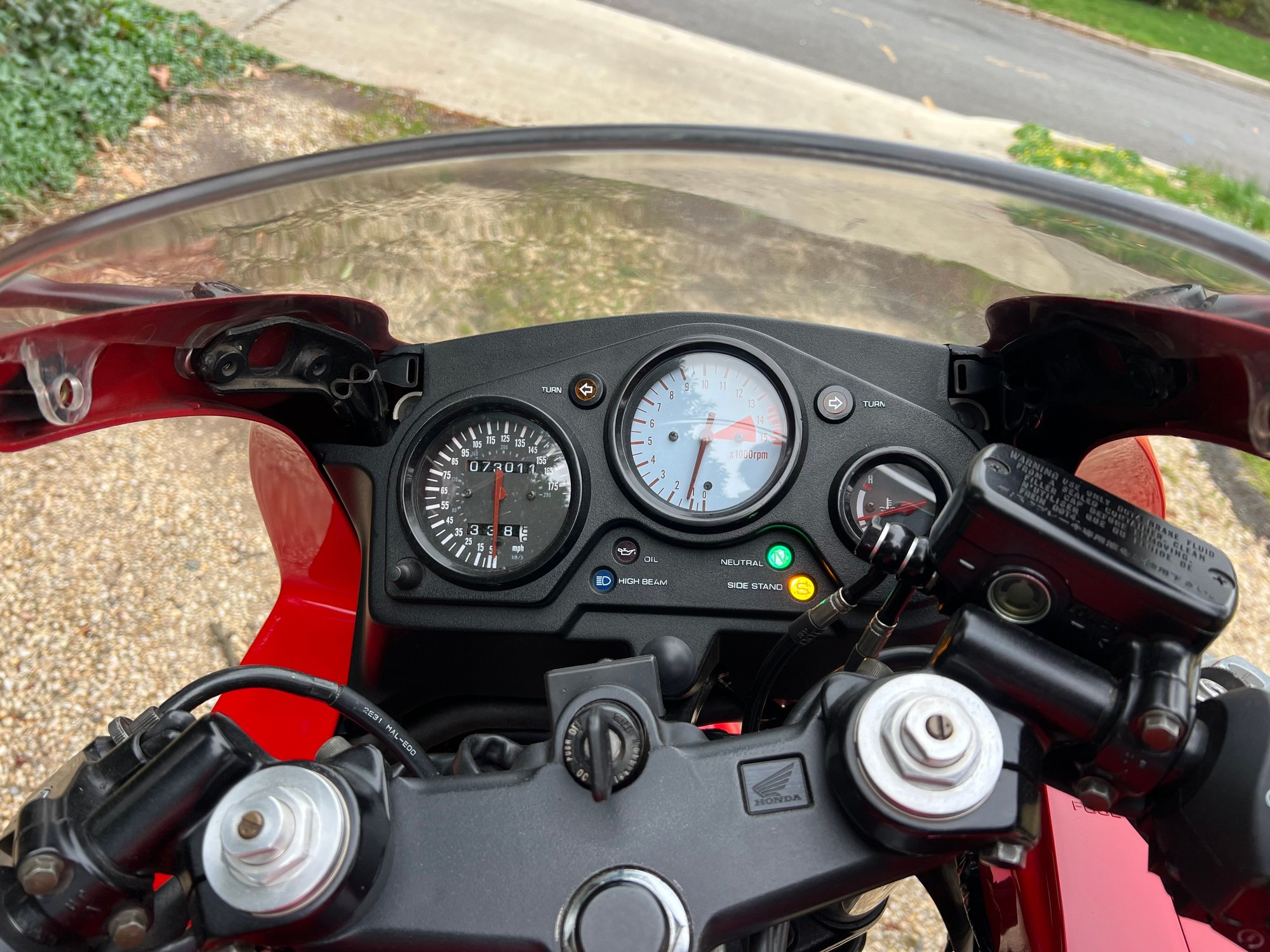

Old Apr 15, 2025 | 01:47 PM
marc0011's Avatar
Joined: Sep 2006
Posts: 1,266
From: Washington, DC
Old Apr 17, 2025 | 09:54 AM
Posts: 2,577
Wow, that is very very nice esp considering its age and mileage! Fantastic job.
Old Apr 18, 2025 | 07:29 AM
nvanvlymen's Avatar
Joined: Feb 2011
Posts: 285
From: Mississauga, Ontario
Wow, that is one great looking F3
I miss mine now. Sold her years back. I'd get another in a heartbeat. Great job, you can tell lots of love and dedication went into this.
