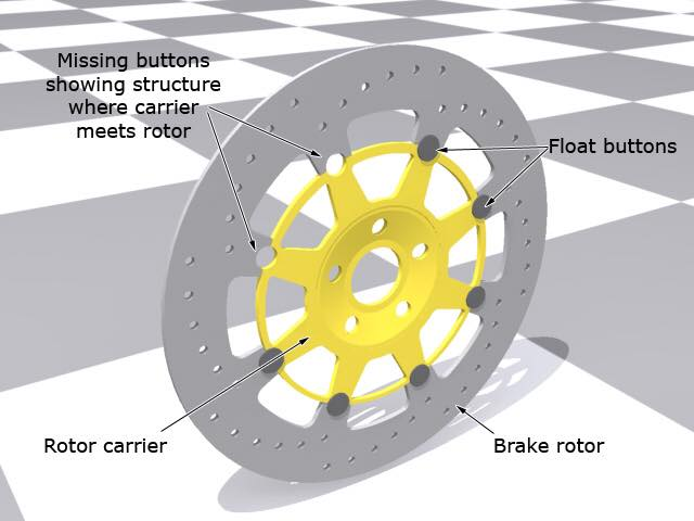

Anyone know where you could get new buttons for the F3 brake discs? Preferably from Europe.
I am missing some buttons but googling gave no results.
Maybe I could use some universal ones and don't need F3 disc specific ones?

We also love pictures, a picture of the 'buttons' would help immensely.

Hey Al!
Sorry for not posting a pic before. Was on my phone, when posting, so it was a bit complicated.
Found this with a bit of googling:
Talking about the "float buttons".

Check here to see if they match what you want...
https://www.performanceparts.de/en/b...r-14mm-x-5-0mm

Ordered these. Wasn't a perfect fit, but used a 13mm (smaller) drill bit to take a bit off the holes and they went right in no problem. Smooth breaking afterwards! 👍👍
Background: The bike was missing two of these buttons on one side since I bought it and whenever I used the brakes, you could feel it slightly making a weird movement.
