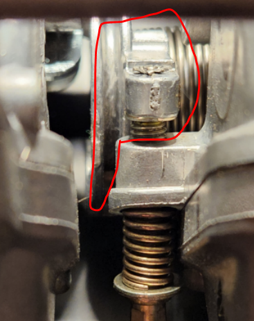

Fed1016's Avatar
Joined: Aug 2022
Posts: 5
From: Washington State
I checked and took a pic of the screw but it looks fine. Or am I missing something?
Old Aug 27, 2022 | 05:24 PM
Posts: 7,177
Yea sir. There should be a spring and washer in there.
Old Aug 27, 2022 | 05:51 PM
Posts: 7,177
Just as a follow up, check out #10 on this Link

Old Aug 30, 2022 | 12:15 PM
@Fed1016 I'm thinking that you might be missing part of your throttle linkage on the carburetor. It looks like it is broken off. Compare the two images.
This appears to be broken off of your carburetor.
Old Aug 30, 2022 | 02:35 PM
Posts: 7,177
Hey @IDoDirt that is a good catch. I was looking at that pic on my mobile and just assumed he had that tab pushed up out of the way for the picture. I didn't see that fracture line where it looks like it's broke off like you mentioned.
