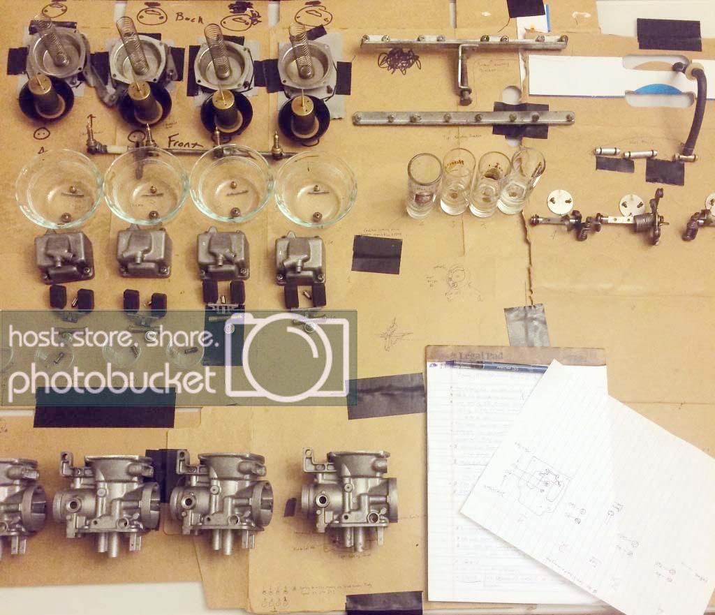

BTW - how were carbs "cleaned"? Completely disassembled down to every last nut, bolt and individual component? Secret hidden passages scrubbed with PEA-based fuel-system cleaner? Ultrasonic soaked? Micro soda-blasted?
