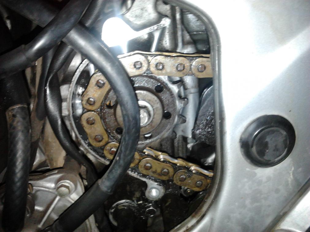

I took it to another shop here in town, and aside from him telling me "if I were you, I'd part it out", told me the oil splatter pattern looked weird, because its also coming from in front of the oil pan. He told me to degrease it/clean it and see where its coming from.
I took off the sprocket cover, and the inside is covered with oil on the bottom, so I'm pretty sure I've got where my oil leak is.
So how would I go about taking off the sprocket to replace the seal? Which section of the factory manual do I look at? 7: Engine Installation?

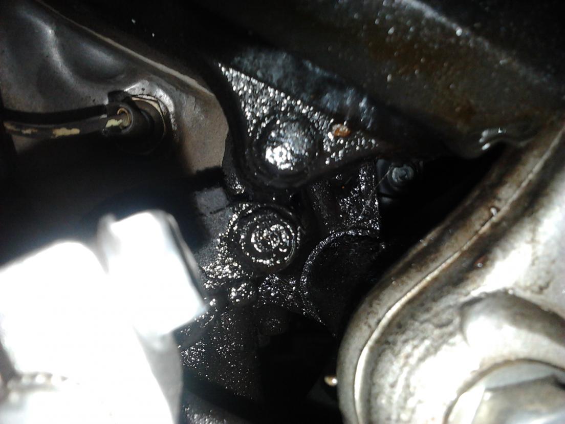

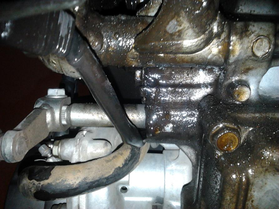

Here are some pictures of my issue.

well your probably going to have to start with removing the chain. im not sure how feasible that is without breaking the chain down. so your going to need a chain breaker/riveter..after you get the front sprocket nut loose, you can then break the chain down, and your sprocket will then be off..that should get you to your sprocket seal, but like dirt said, you may have to go deeper than that. ..
any of the external leaks you encounter are most likely going to always have something to do with failed o-rings, failed seals or failed gaskets. its just a matter of getting to them and replacing them. i would think if a leak doesn't fall into one of those categories, your probably dealing with some broken hard parts...(one of the cases). but doesnt seem the latter applies to you. I would get some purple power or brake clean and start knocking all of that sludge off so you can better inspect everything.
