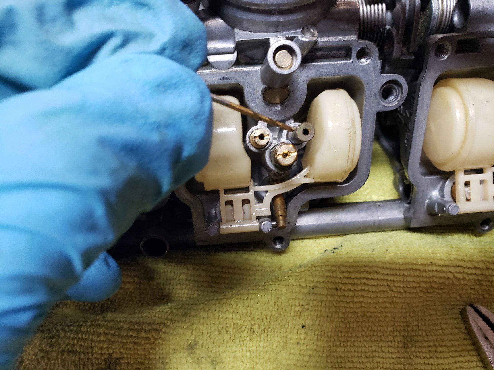

Choke actuation is good. I havent taken apart the plungers...should I?
Trying to see if these are clogged. If I hit them with carb cleaner I cant see where is comes out
