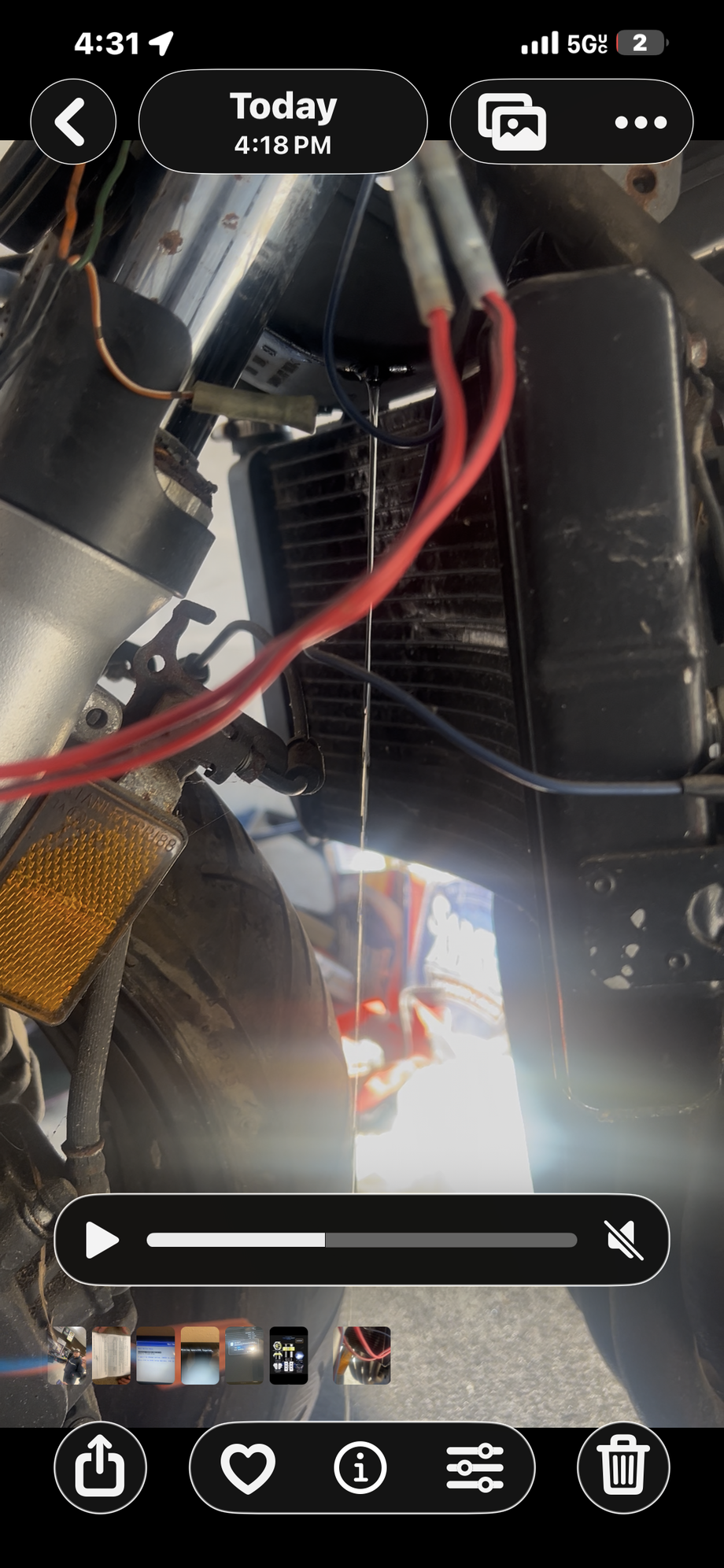

Hello everyone, I知 trying to diagnose my 1998 Honda CBR600F3. The bike starts for a few seconds and then shuts off, and sometimes when it does run it blows black smoke, but most of the time it just cranks (and sounds normal while cranking). Fuel is visibly dripping into the airbox from one side in large amounts, and I can also hear fuel moving when I turn the key or try to start it. The carbs were checked and look clean visually, and it will run briefly on starter fluid before dying again. The bike sat for about a year before this started happening, though I知 not sure of its exact condition before that. I知 trying to figure out if this is a carb float/needle issue, vacuum issue, or something else common on this model before I tear deeper into it. I致e used ChatGPT to help narrow things down, but I want real mechanical input. I also have a picture of the airbox leak if that helps.

It is definitely a carb issue. If the bike has been sitting as stated, don't waste your time trying to pinpoint a specific thing to fix. When you fix that, another will be revealed.
Time and effort are better spent just completely going through them. A visual inspection doesn't provide much, as there are so many tiny fuel passageways you can't get to with the carb rack still on the bike.
