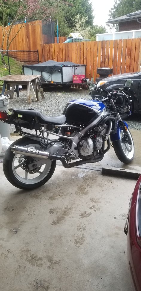

Default Finished Pulling Off The Janky Wiring
Got out this morning and finished removing the hacked up wiring harness under the seat. Whoever did the wiring didn't do that bad but it was still a hack job. Had a starter button off a tractor or something.
I removed the battery box and the tail light section. I can get in there and repair the wiring now. Put everything back where it goes and make sure it works properly.
i went back to where I picked up the bike and found the bottom of my air box. I was afraid it was thrown in the trash.
When I'm done with the wiring, I can start looking at mechanical stuff.
