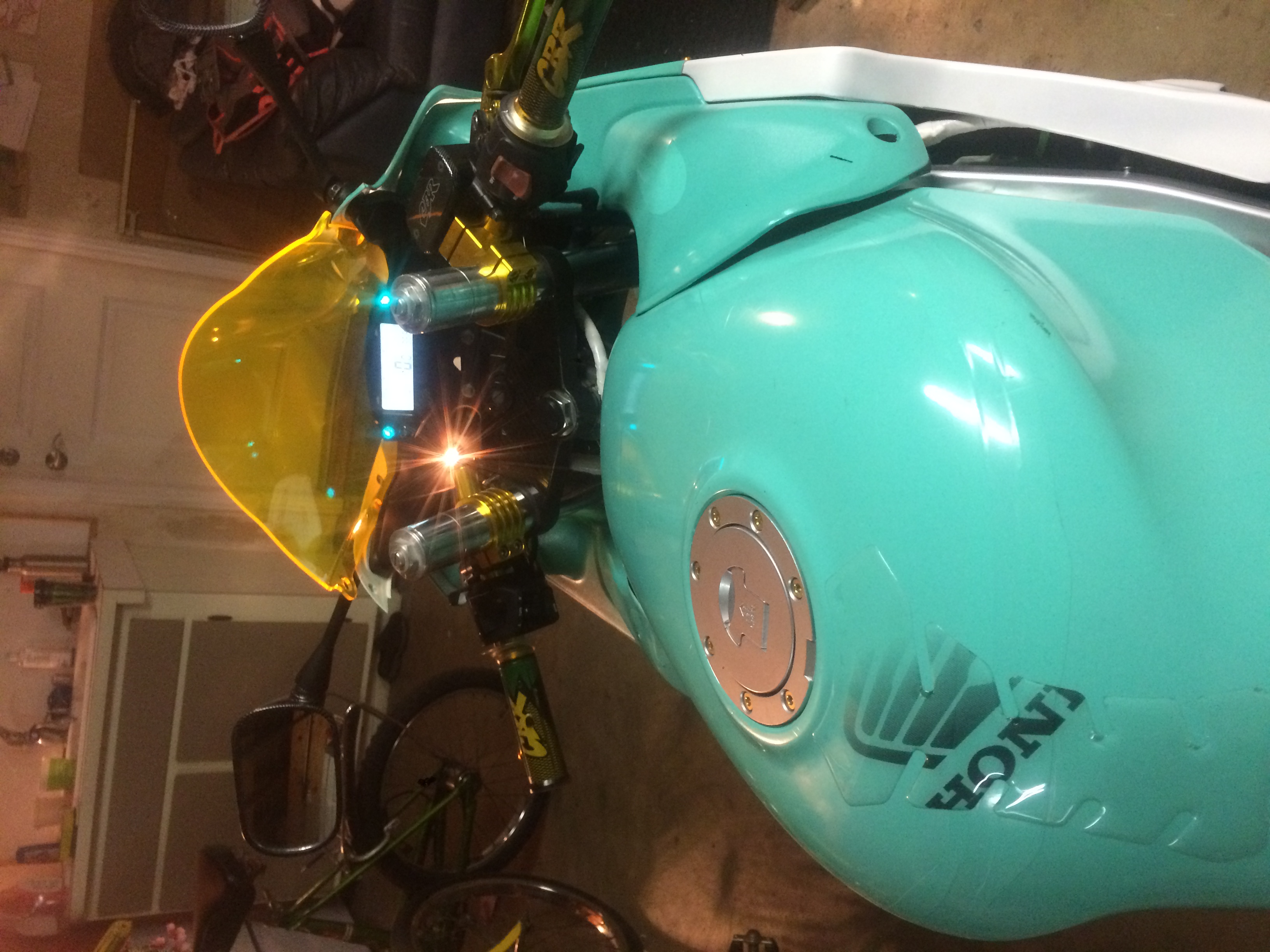

Still have a lot I need to do but my build is steadily coming along so here are some updated pics to check out and a parts/mods list f4i front stay,headlight, and custom cut side fairings to expose engine covers to give it a more modern kinda f4i /rr hybrid look, powerbronze 03 rr windshield , cut the f2 subframe off and welded tabs to just straight up bolt on the f4i subframe /tail to my f2 frame so that I wouldn't have to build a bunch of brackets on the f2 subframe to fit the f4i tail on and so that I would have the functioning f4i trunk, f4i under tail, f4i impacts have Tiffany blue powder coated sub cage rear pegs, pink as rear brake line, fox twin clicker, adjustable rear link, protein rear sets, billet gold rear brake red, gold billet engine cover bolts, shortened and rewelded kickstand,clear Honda tank pad, aftermarket rectifier cuz my other one literally caught fire, gold billet fairing bolts, carbon fiber triple tree cover , aftermarket gold clip ons with cbr grips, keyless star mod, on/off switch radiator fan switch , trail tech vapor with indicator dash, cbr front brake master cyclinder cover, clear front flush mount f4i turn indicators, Erion racing headers, shorty gp pipe but getting a bigger can.... Well I think tuts his ally everything so far, parts that I have but still need to install is 929 front end but still need wheel, ape billet cam chain tensioner, factory pro jet kit configuration 10 Cali kit and then other upgrades that I still need to order... But yah so far it's looking really really good and every where I drive it I get lots of compliments which is really cool that people enjoy my work
Attached Thumbnails Updated pictures of my 92 f2 to f4i conversion-image.jpeg

I appreciate the work you've done and all but.........just not digging the stance at all or the color for that matter. Sorry, I'm sure I'm not alone. Do you think you have enough fork sticking up through? Holy moly! There is just no way in hell that bike handles even on the slightly better side of decent.
