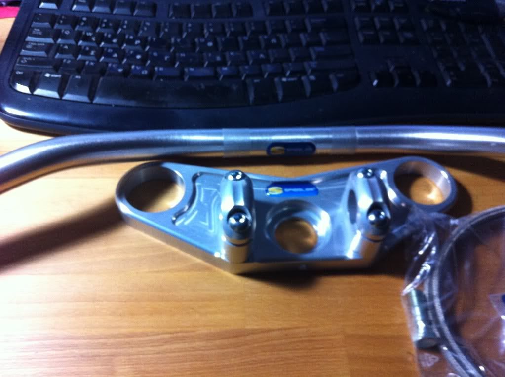

Default Finally here
Just got the Spiegler kit.
I cant wait to fit it on the bike.
The kit came with 2 brake lines but i am pretty sure i will be needing a longer clutch cable...Will know about this when i put everything on the new handlebar.
will post pics from the installation soon i hope.
Cheers!
