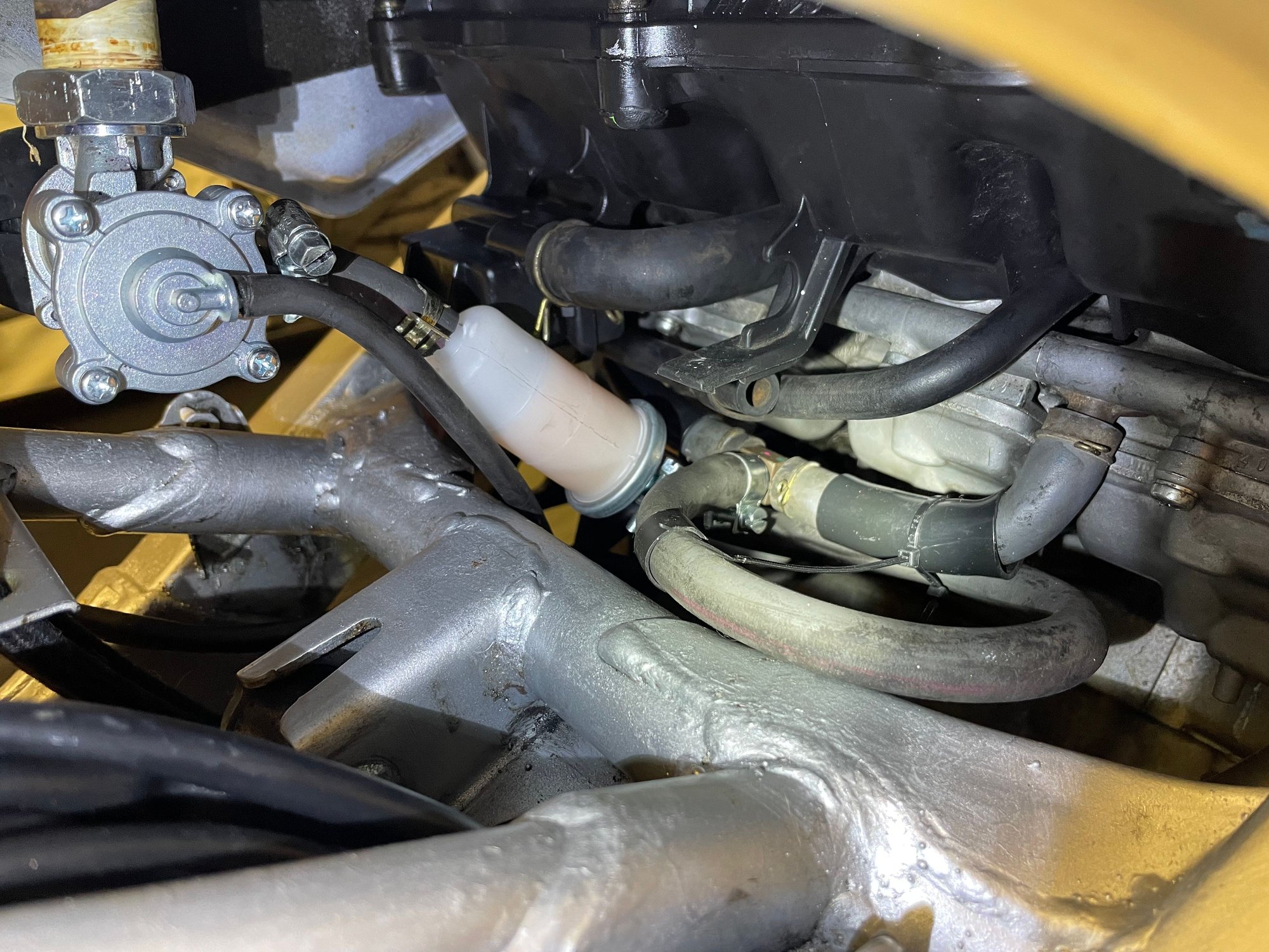

So I had a fuel leak on my 92 600 at a very small old filter on the tee which I replaced with a large oem one and new hose. I’ve had to loop the hose down towards the engine then loop it back round and up to the tee because the filter is quite big. The fuel is filling up the filter but it’s not getting to the carbs? Thanks don’t think my model had a pump so if it’s gravity fed will the loop below the carbs stop the fuel from being pulled in? Bike ran great before I stripped it all. I cleaned our my tank while I was at it there was a lot of rust in there but that’s sorted.

This is the current setup

That should be fine as it pertains to gravity. Try reversing your filter.

The tank is raised a bit there. You can see fuel in the bottom of that filter If you look closely. It does have an arrow on it pointing at the engine…

Well then, never mind. What happens if you remove the hose from the tee? How does the flow look then?

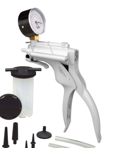

Looks like fuel is not reaching the fuel filter. I would expect it to be completely filled with fuel. It seems that the petcock is not receiving any/enough vacuum to open it fully. Do you have a vacuum pump you can attach to the nipple on the petcock? That will tell you 2 things. Is the petcock leaking (not holding a vacuum) and is the petcock actually opening and allowing fuel to flow when it does have vacuum.
Is that picture a mirror image? The petcock looks like it's on the wrong side.
