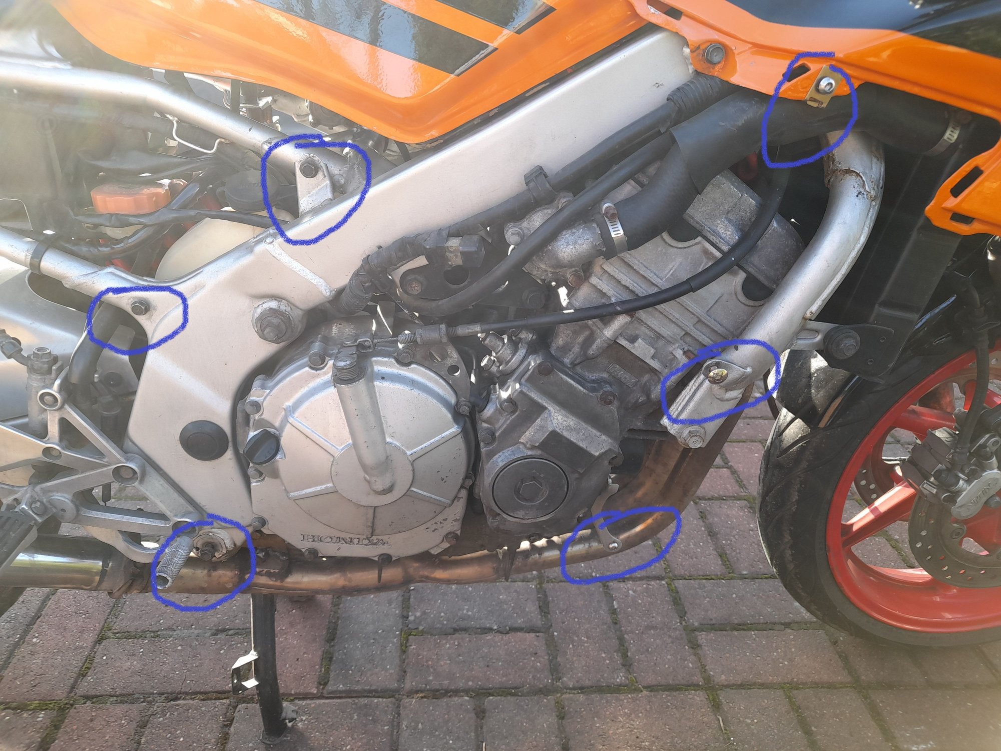

This is a 93 F2
Plus one on the front of the upper fairing

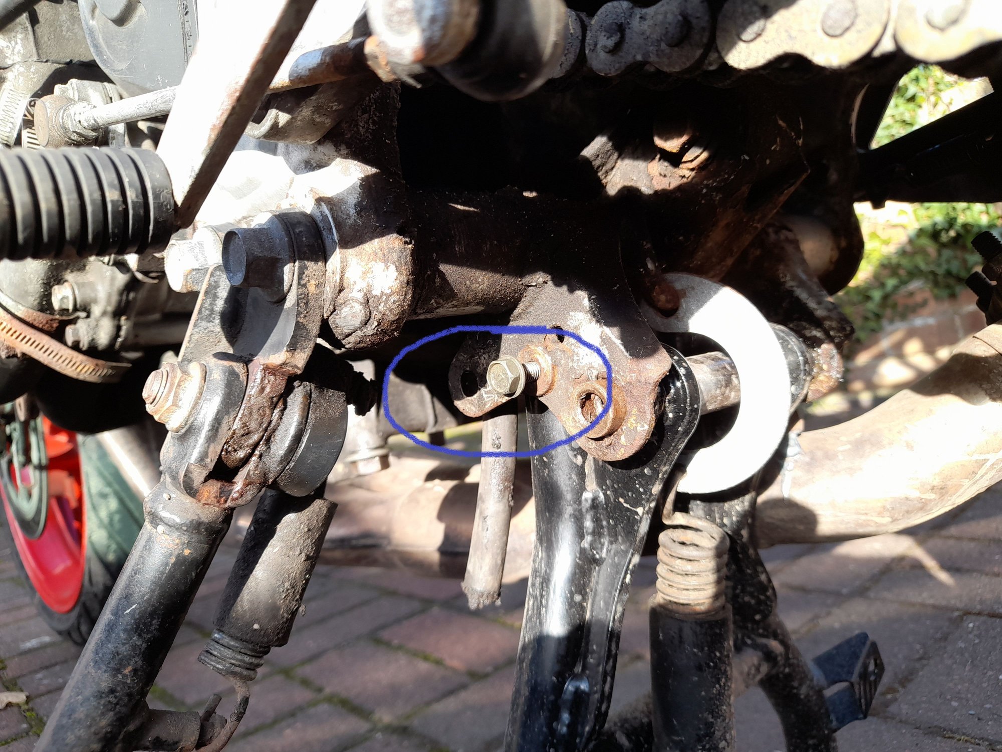

Plus one on the front of the upper fairing and one behind the side stand, see next picture
Well hidden :-)

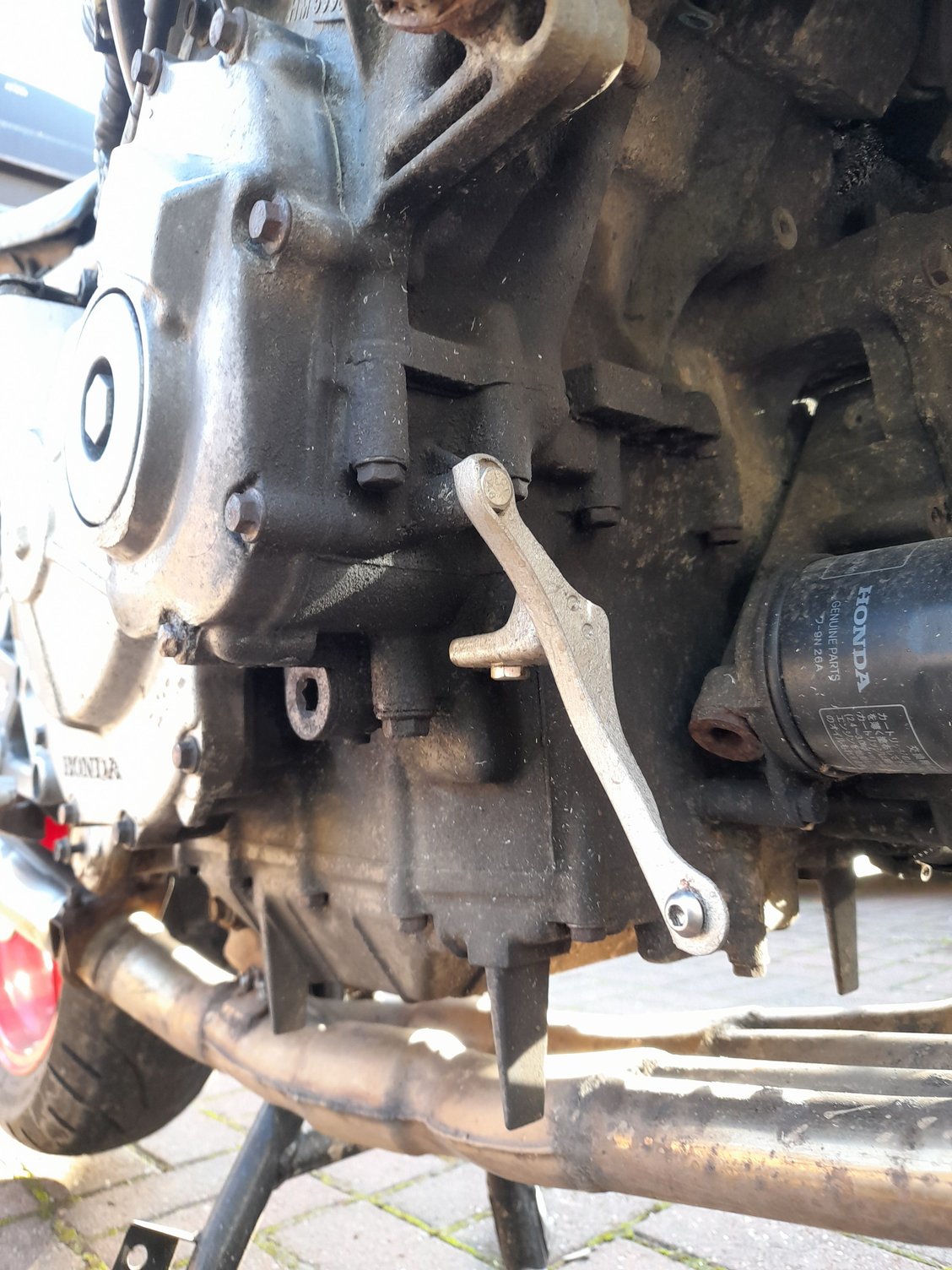

The left hand lower bracket
The right hand lower bracket

This is a 93 F2
Well hidden :-)
Thank you very much ! Well, it seems that things changed a little in 1994. I do not have a few of the main mounting tabs that are shown on your bike. But of course, why would anything be easy ??!! Since we already have paid for the 1991 set-up ( got a pretty good deal on them from a local shop), I guess it's going to take a little work mounting these up. Your pictures will be an invaluable resource for us, thanks again for taking the time and effort.
