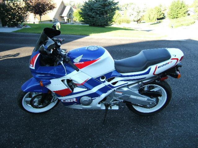

Ok got the Fairings. The proceedure goes like this. Once you order them, if they are not the ones in stock it goes like this
Order sent to their factory (18-23 days to make)
then ready for shipping (3 days)
then they go to US customs once they get here (3 days)
Then from customs to me in Idaho (4 days) so expect a month. Now about the fairings they are about 3/4 the thickness as the original. On the two back upper fairings you have to drill the hole bigger for the quick screw and then cut the small grove in the other fairings so the quick screw will hold. On the headlight you will have to buy two 7mm nuts as the upper two holes are posts and the lower two are the normal screw in. They also have two open holes for a grab bar at the back. Which mine originals don't have. Here's pictures of the finished product.They also sent me a new windscreen no charge and also a Honda racing hat, and a few other freebees.
Pic's of the finished product. Mine's a 1993 CBR600F2 2570 original miles
Attached Thumbnails F2 Fairings from Hong Kong-cbr-001.jpg   F2 Fairings from Hong Kong-cbr-002.jpg   F2 Fairings from Hong Kong-cbr-003.jpg
