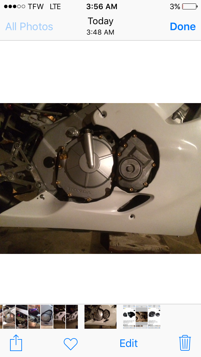

Custom cut f4i side fairings to show cases for a more modern look and to show off gold billet

Still need to polish covers
