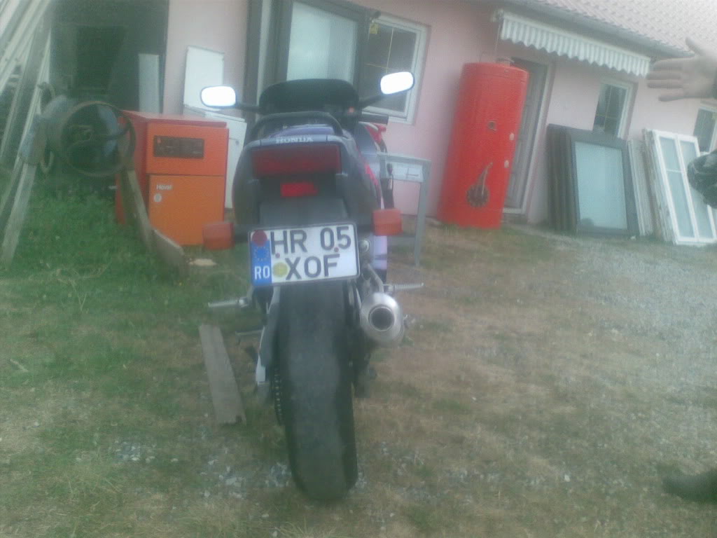

i have a question, how you change the back of bike, the place where are the back light and registration number. i put a photo whit my bike. thank you
