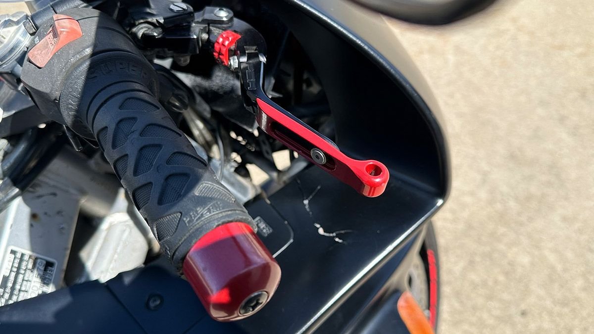

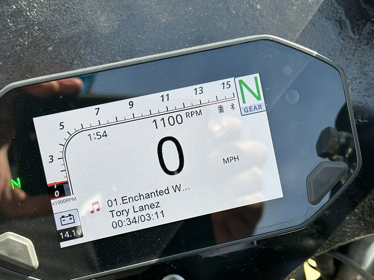

Powdercoated pieces came back: peg mounts, lever slides and adjusters, and bar ends. Should go well with the Red Bull fairings once they get here. CBR Wheel decals and red sprocket nuts came from MC Motoparts, red to match. Finding new things out about the Koso RX4 meter, your music info is displayed on it along with incoming text/calls.

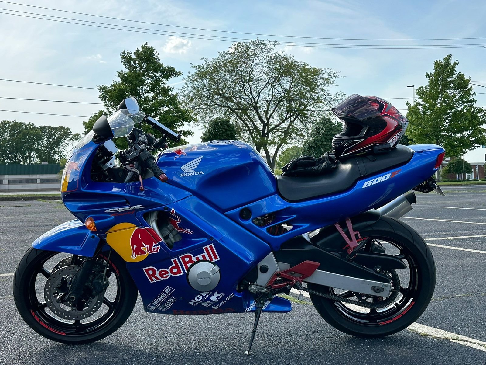

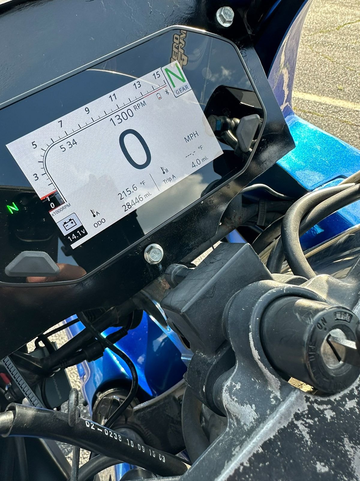

Got the fairings all installed, not bad. The chinese fairings have their usual issues, poor alignment, fragile posts, and thin plastic. Bad issues aside, they are not bad, up close you will notice things, far away not so much. Had to breakout the drill bits and open up all of the mounting points quite a bit, some were off almost 1/2 inch. Front turn signals are pain as the L clip that locks them in on the OEM panels are not on the aftermarket ones, had to use some epoxy, metal L bracket, speed clip, and washers. Speaking of speed clips, found a fairing kit off Amazon that literally saved a lot of work:
Amazon Amazon
The maintenance covers mounts for the quick turn screws are riveted in on the OEM panels, not included on the aftermarket fairings. Speed clips came in handy as a replacement. Used the supplied heat shield mat on the lower and inside pieces, let the bike run to 212 degress, no warping or melting. Side rear panels have a hole provision for a grab handle, gotta cover that up. Overall, happy with the look, not so much the fit. Curious if the UK spec F2's have different frames than US spec, or if the chinese fairing molds are off that much when they make these. Photos.........
