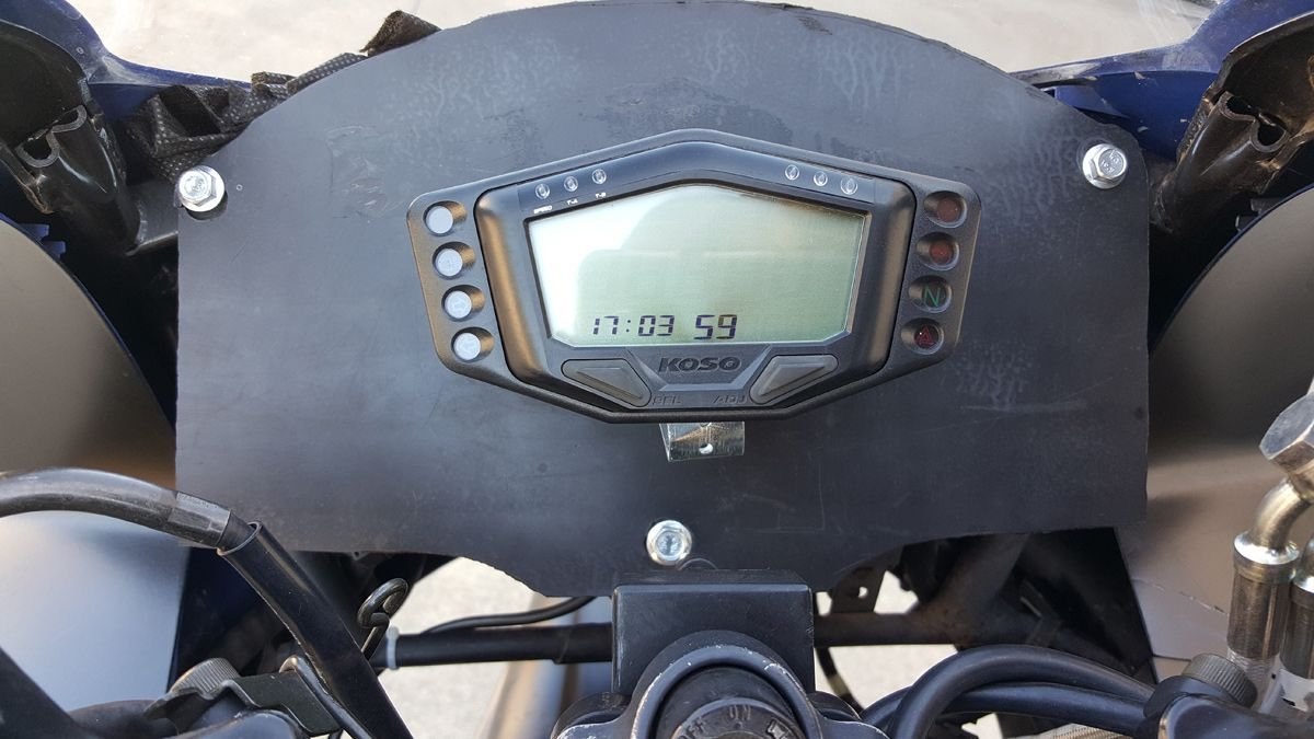

Shop, I work for a Honda dealer.
Originally Posted by ep224
...Display can be completely customized for 10-15-20K rpm, just about any cylinder config, temp, wheel size (for magnetic speed sensor), mph/kph, backlighting, and list of other things.
can you post a pic of the dash after the install? very cool.
I have some cleaning up to do, most likely replace the dash bracket bolts with black ones. I used backstrap pieces to make a sturdy base for the display so when the buttons are pressed it doesn't move.

Thanks, I bought the same one for my SuperHawk 996 a few years back, made it easy for wiring and setup for the CBR. So far have logged 3K miles on it, no issues.

Very easy, there is a bracket that ties or bolts to the front fork or brake bracket (either side), this bracket holds the wheel sensor pickup. Koso supplies these small magnets , you only will need one of these. It fits inside the the brake rotor bolt, and is picked up by the wheel sensor on the fork. Sensor plugs into the back of the dash and you can specify wheel circumference to get the MPH correct, I checked it with GPS on my phone.

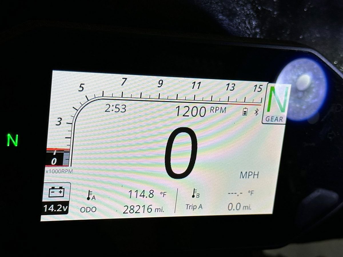

Back at it, with a new dash and some new bodywork ordered. 1st up is the new dash, Koso RX4 with TFT display, completely programmable, a/f ratio, immobilizer support, automatic display brightness, dual temp sensors, fuel level, gear indicatior, Bluetooth support, etc. Was time to upgrade from my DB-02R, gained a lot of new features. This display looks very similar to the one found on the new CBR1000RR, all you info at a glance: battery v, trip, odo, rpm, mph, gear, fuel, etc. The F2 only has 9 wires to connect: power, switched, ground, L/R turn signals, hi beam, oil pressure, neutral, and lastly rpm. There are 2 wire sets to connect, the temp sensor and the speed sensor (mounted on the front fork). It has a learning mode to calculate MPH. The display night mode has different colors to select, the day mode gives you the white background with black letters, and it has light sensor to change it automatically. So far I impressed with it, my 3rd Koso dash and the quality is top notch. Video below, I learned later after the inital startup screen, you get the condition screen, then if you start the bike it changes to it regular screen, I thought I had to press the 2 buttons to change, not needed I found.
https://kosonorthamerica.com/product...ter-universal/
