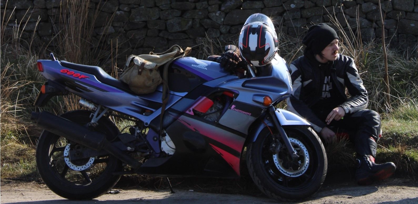

i've got a 1994 CBR600F2, UK model running what i believe to be a VP40A carb (based on google, not had a chance to have a good look at it)
And i've been trying to find out the information on what jets i'd need, and how in the world you replace the jets on a carb and adjust the pilot screws.
its currently running:
-stock airbox with a K&N filter
-200mm low tail shorty exhaust with DB killer (obviously not the one in the pic i posted :P )
-standard carb, no idea what jets are in it currently, could be standard, could have been changed by previous owner.
My reason for wanting to get it sorted is that its got a rough idle, and sometimes feels underpowered at low RPM's, it occasionally bogs on the motorway too, when cruising around 5000-7000rpm (this might be a seperate issue, it only happens for <0.5s or so. but its still noticeable)
basically, what jets do i need, and is there anything i'm missing which could be wrong based on the info i've given above (if you need any more info, let me know!)
Thanks in advance!
-Vaughan
