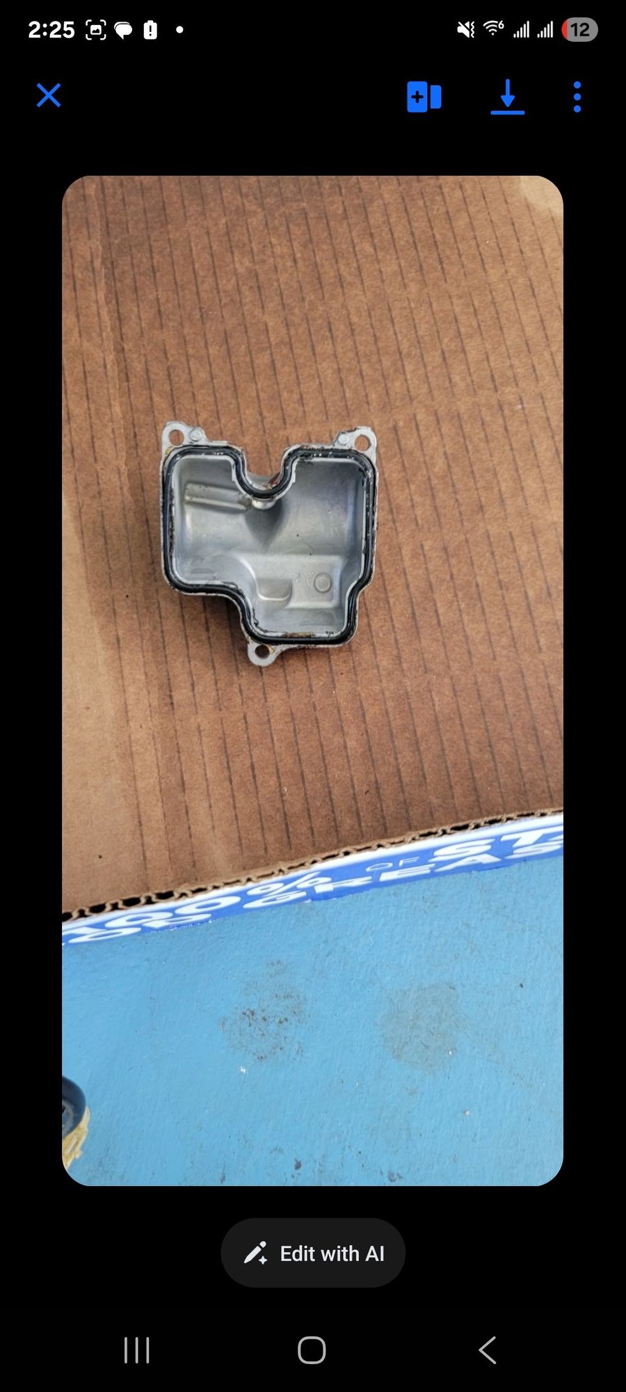

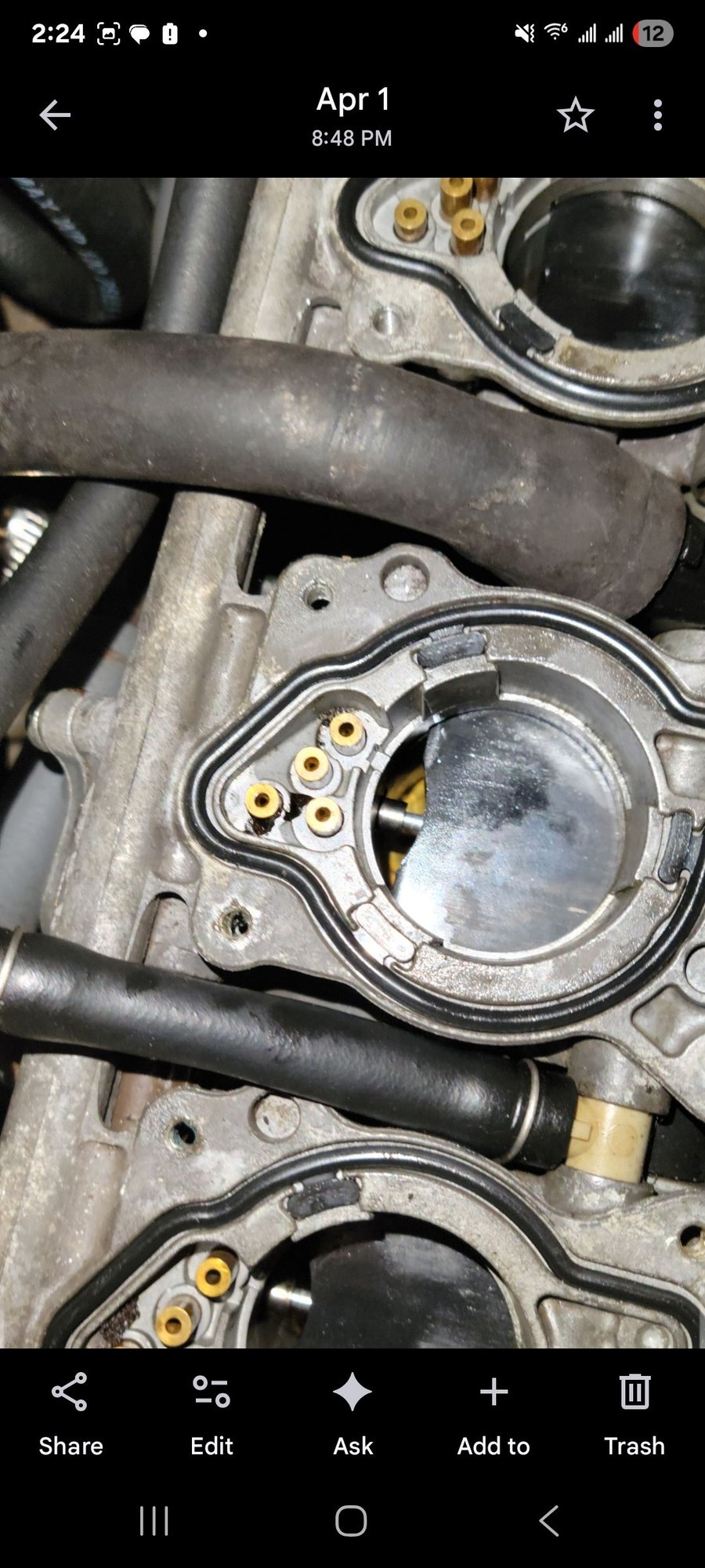

They said they rebalanced the carbs and wanted a copious amount of money for them to rebuild the carbs . The bowls were clean no varnish at all and the floats and everything were fine. I'll attach some pics

Oh please be nice this is my first post and I know nothing about the bike besides the odo saying 1200 on it 😂 Sorry the pics are garbage . The high res ones are too big to upload so I have screenshots for you
