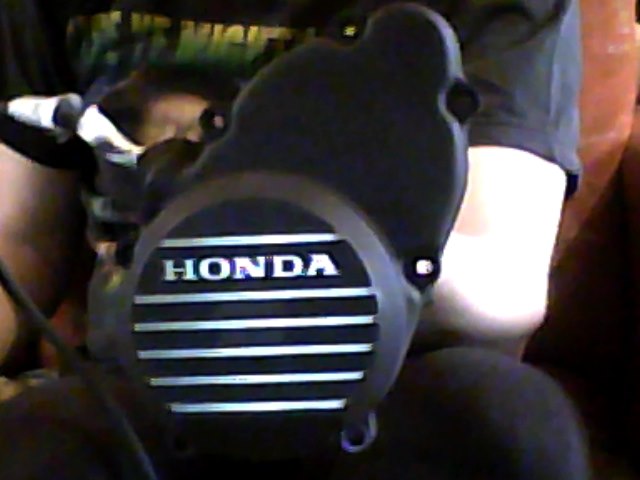

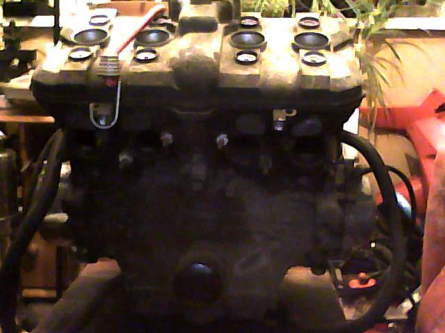

sorry dennisgb i have a 27 yr old engine i want to clean up for my restoration bike and was asking what you guys thought about how to restore it either by polishing or painting engine has not been touched since it left the factory so quite messy

Clean the engine good. Use brass wire brushes to get all the crud off...I use the small ones that look like a toothbrush.
Get a good paint prep solvent to do final clean because most cleaners leave a residue that has oil in it and will mess up your paint job.
On my engine I used VHT Flat Black Engine Enamel. You can get it in silver to match the stock color pretty close. I chose the flat black to emulate the RR color.
Doc and I used VHT Nu-Cast Aluminum Engine Enamel for the side covers. I chose the darker one to emulate the RR color. They make this in three shades and the medium silver would look pretty close to the original Hurricane color. I would suggest the whole engine in this paint if you are trying to restore to original look.

Now that's a pretty lump of motor! Almost a shame to hide it under the fairings! :-)

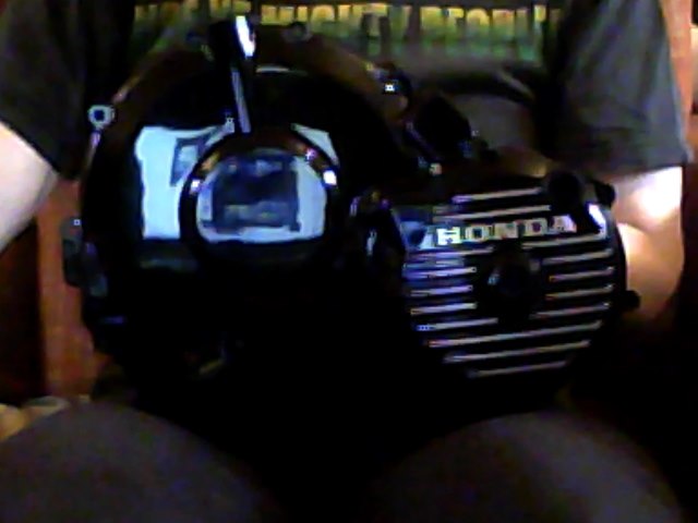

well i finally got the engine painted what you all think looks best for sides gloss or matt black ty

I am a fan of the matte black/silver dennisgb used (although by now it is probably long done). Have you finished putting the bike back together now? Thanks for logging this build by the way, it was great to follow.
