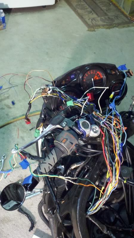

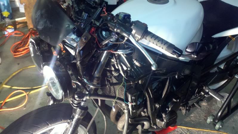

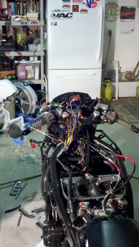

well, here's a picture of my build. everything goes under the tank basically. i stuffed all of my stuff infront of the carbs under the airbox.

After all that your still going to have two wires going to the stock gauges unless you go aftermarket with them.

If your running your wires through the intake did you cut a hole on the tube running into your airbox for your wires to come out of?

i cut the snorkel short so that it didnt have any added restriction.
