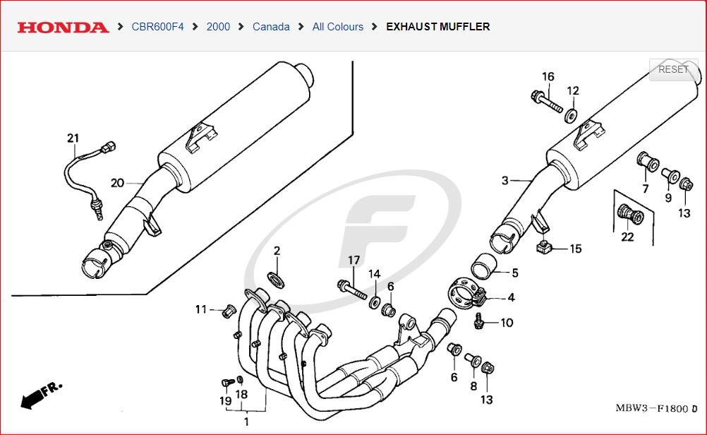

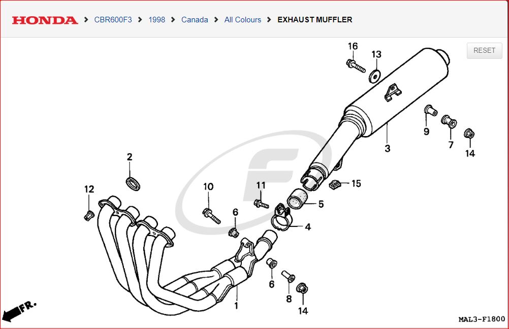

Hi , as you can see the muffler is slightly different with the brackets on top and underneath.

Not really ,you only need a strap off the passenger peg for the muffler , and adapt the other bracket
