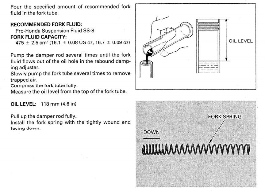

You don't happen to know how much oil per leg?
Old Dec 10, 2022 | 11:14 AM
Posts: 2,573
No worries, happy to help. Here are the details.

Excellent stuff, Cheers for your help mate.
