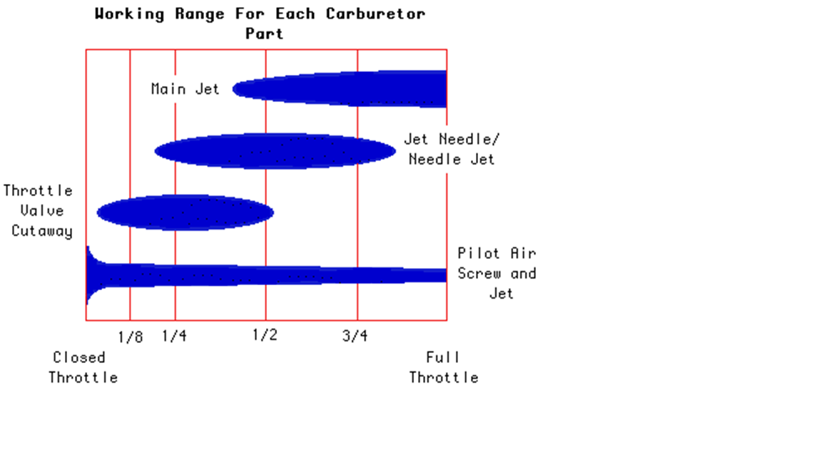

SO NOW MY ISSUE -> After finally running her after an almost 3 week nap she is SPUTTERING again like crazy but this is where it's weird, I don't think it's a fuel delivery issue because the FIRST THREE GEARS she has INCREDIBLE acceleration (like perfect even under serious load) and only starts sputtering in 4th, 5th and 6th gear. Once it starts sputtering though... It's like she gives up and almost every gear she continues to sputter, even with the throttle at the middle or low position (well maybe not 1st gear but the sputtering is crazy). Has anybody ever seen this before?? I'm pretty handy with tools and have a little side hustle fixing & repairing scooters and other small CC engines (for fun & profit).

Hey there,
It does sound like you've got some gunk in there somewhere. The fact that you noted the throttle position is a big help. I've attached a pic of how the different circuits work inside the carb for reference.
About your question about the vacuum, you do not remove the carbs when syncing them. The bike actually has to be running to perform this maintenance action correctly.
