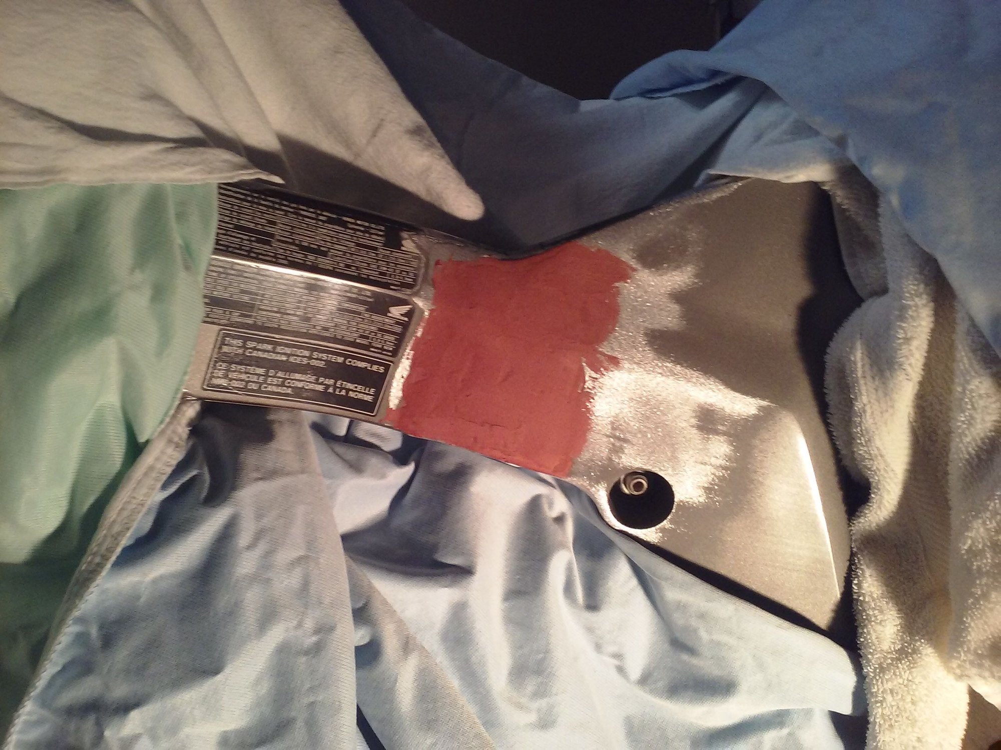

NEAR COMPLETION. GREAT TRICK I LEARNED IN LATE 80'S MAGAZINE CYCLE WORLD "BEST TRICKS FOR QUICK REPAIRS". BAKING SODA AND CRAZY GLUE! APPLY SMALL AMOUNT OF CRAZY GLUE TO CLEAN SURFACE THEN SPRINKLE BAKING SODA ON THE GLUE... UPON CONTACT THE BAKING SODA TURNS HARD AS "CEMENT" AND YOU REPEAT THE PROCESS! IT IS SANDABLE AND PAINTABLE.
THIS WILL NOT WORK ON NON POROUS OBJECT SUCH STEEL OR GLASS.... ALSO USED THIS TECHNIQUE TO REPAIR QUITE A FEW BROKEN FAIRING AND PANEL TABS! WORKS LIKE A CHARM! EASY SIMPLE AND QUICK! HAVE FUN!

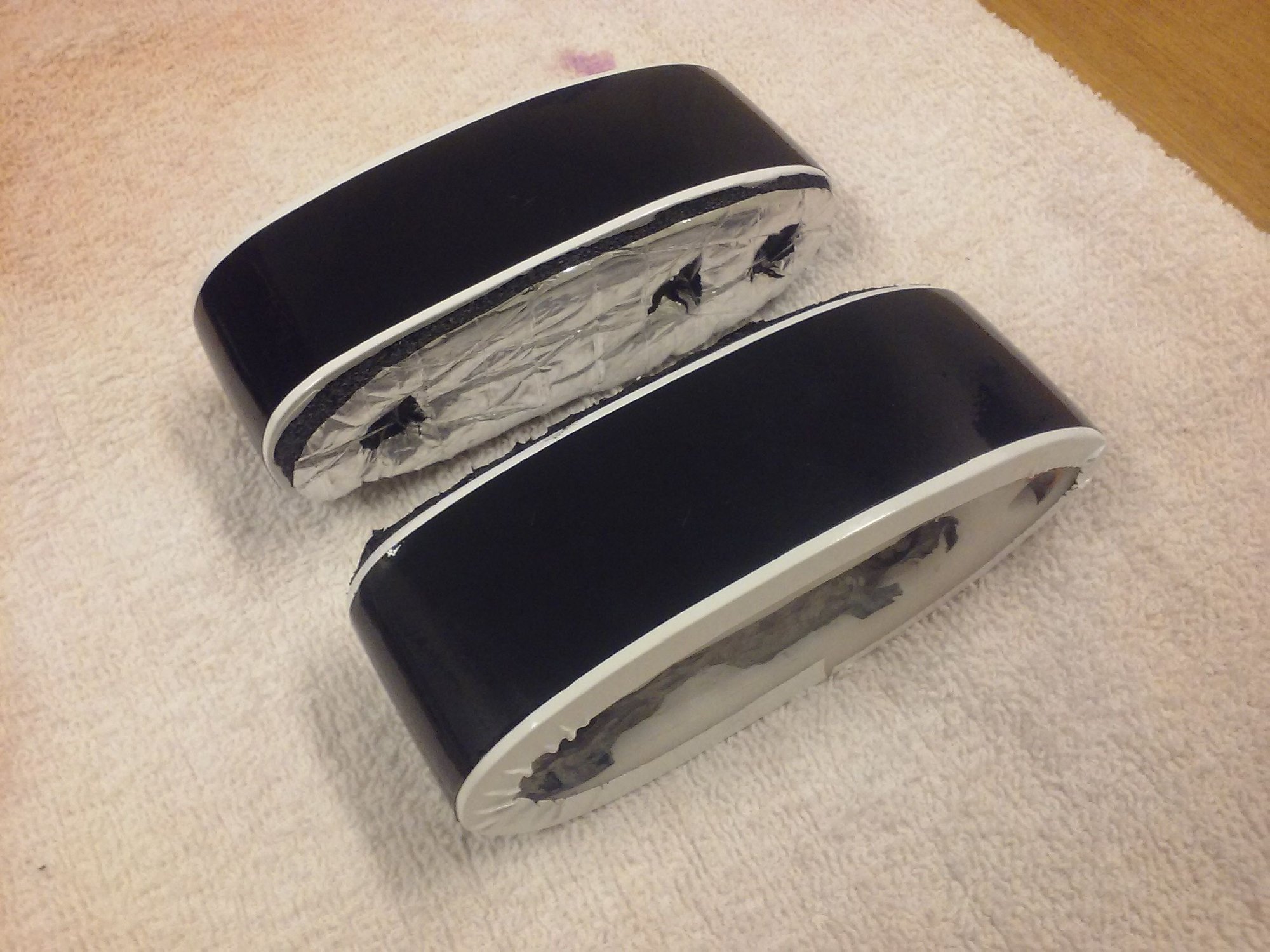

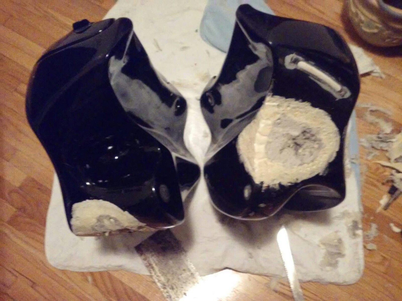

PREPARING RIGHT SIDE BEETLE BAG FOR TRANSFORMATION

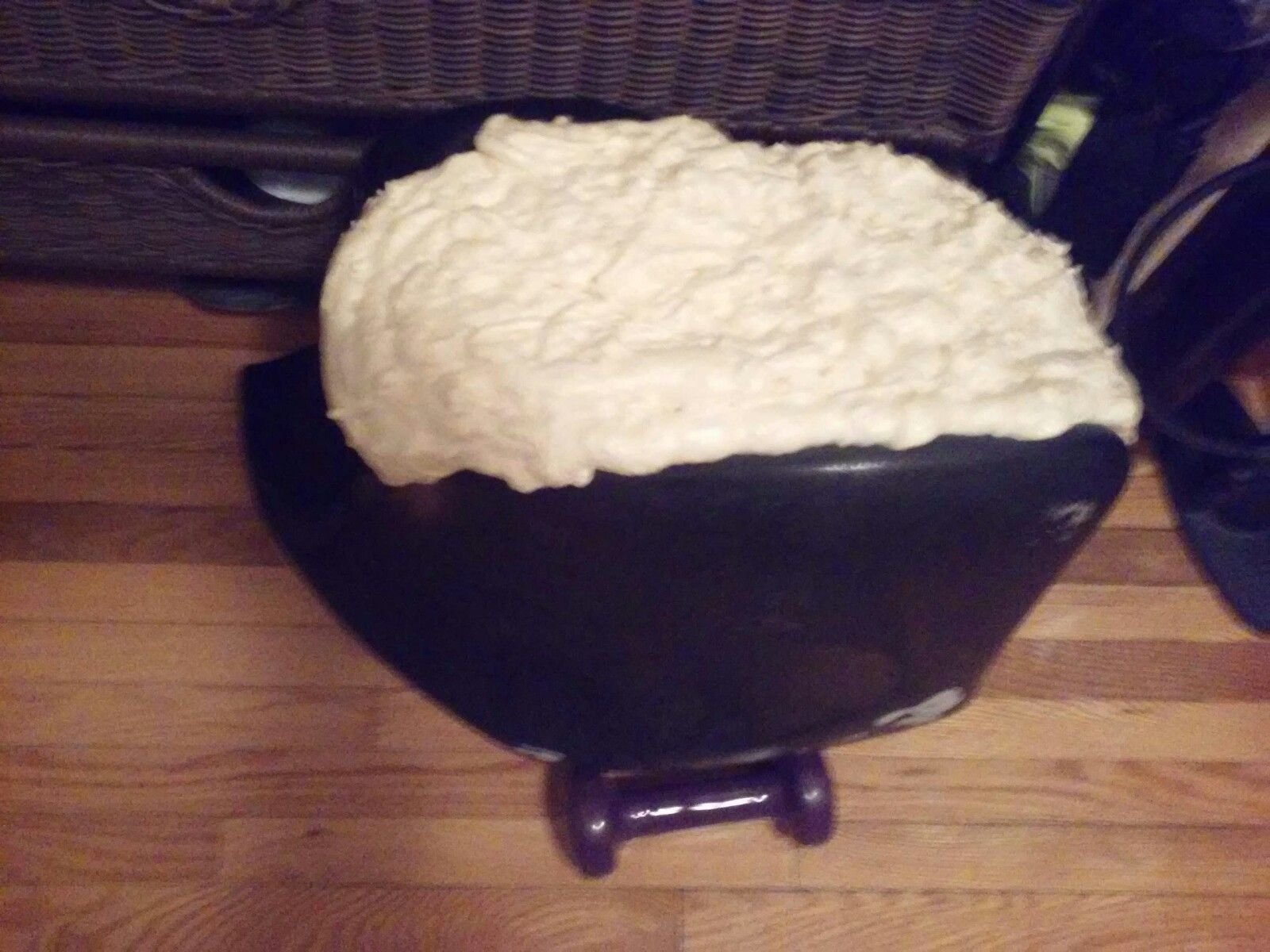

GAP FILLER DID A GREAT JOB OF FILLING HOLES
GAP FILLER DID A GREAT JOB OF FILLING HOLES! THIS IS THE LEFT SIDE BEETLE BAG. DECIDED TO FILL IN THAT HUGE GAP SINCE THE BIKE HAS 4 INTO 1. AND LOOKS "CLEANER". FROM THE BACK...
CUTTING AND SHAPING THE FOAM ALSO INSTALLED LED LIGHTS ON BOTH BAGS
GETTING READY TO INSTALL LEFT LED STRIP.

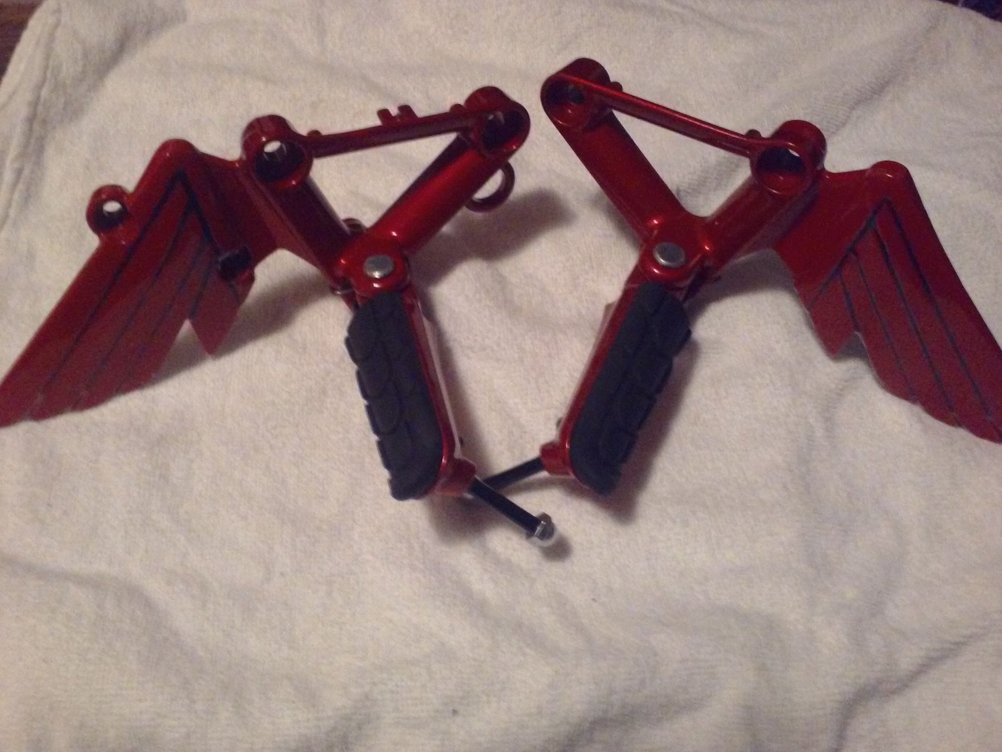

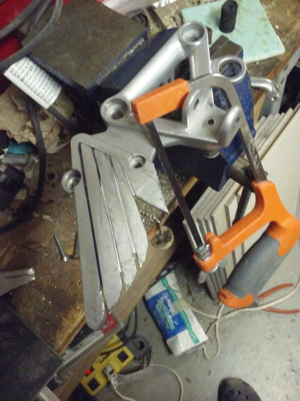

REMODELED RIGHT SIDE FOOT PEG BRACKET
REMODELED RIGHT AND LEFT FOOT PEG BRACKET

FOOT PEGS COMPLETE! WING PORTION PROTECTED WITH CLEAR VVIVID VINYL. CAP BOLT WRAPPED IN BLACK...

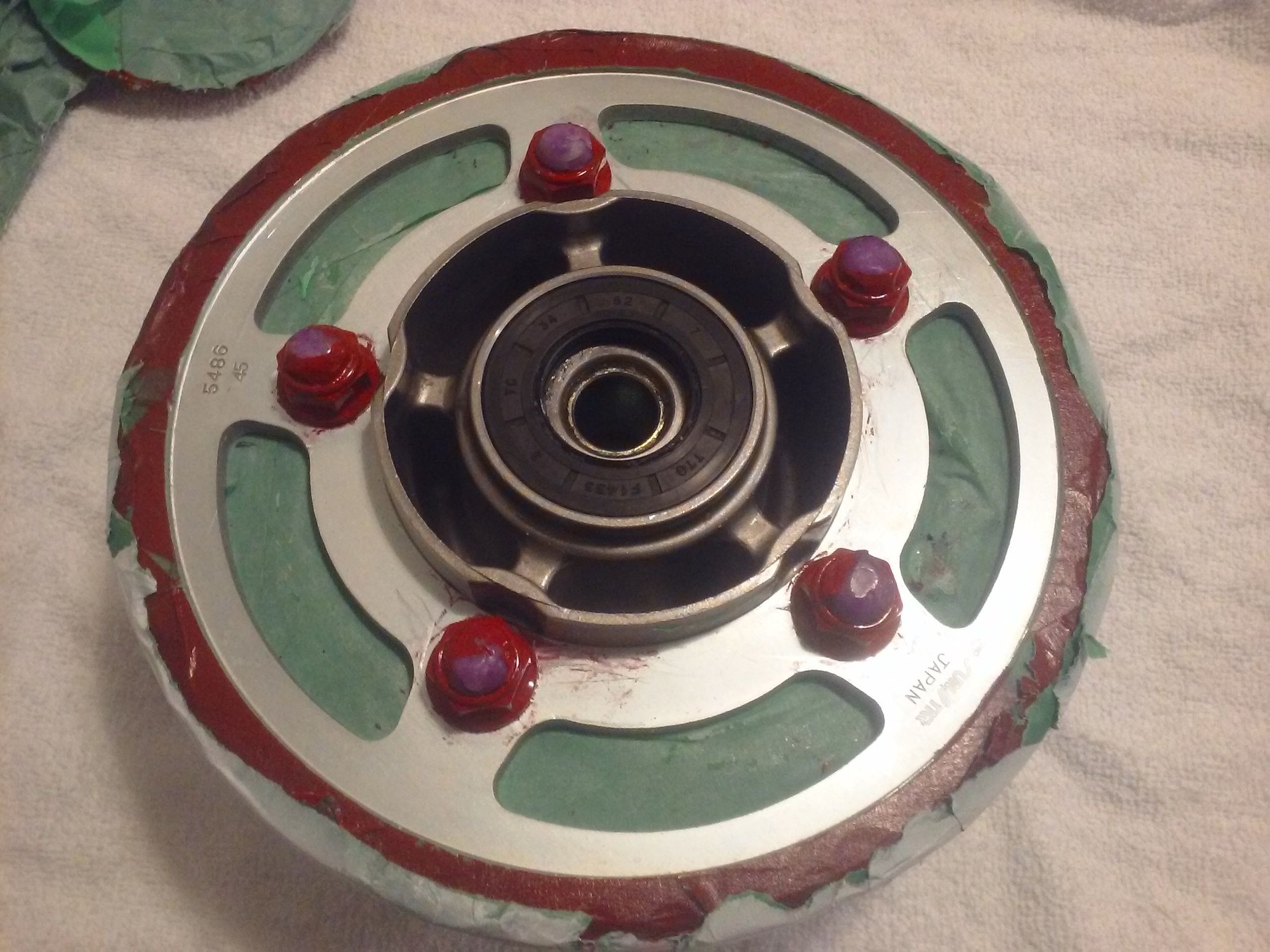

PREPPING HUB FOR BLACK PAINT, USED WAX TO PROTECT BOLTS THREAD FROM RED PAINT THEN WAXED WHOLE BOLT TO PROTECT FROM BLACK PAINT.
HUB PAINTED, USED WAX TO PROTECT BOLTS THREAD AND SOCKETS HOLES FROM RED PAINT THEN WAXED THE WHOLE BOLT TO PROTECT FROM BLACK PAINT.

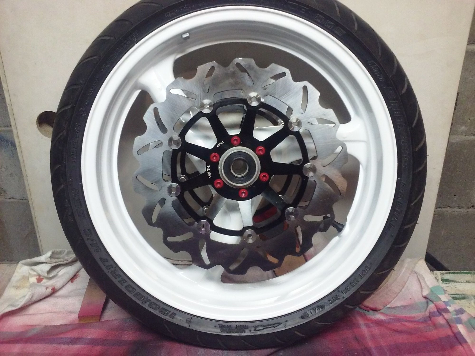

FRONT RIM READY FOR INSTALLATION! BALANCED AND PAINTED SOCKETS HOLES AFTER TORQUING.

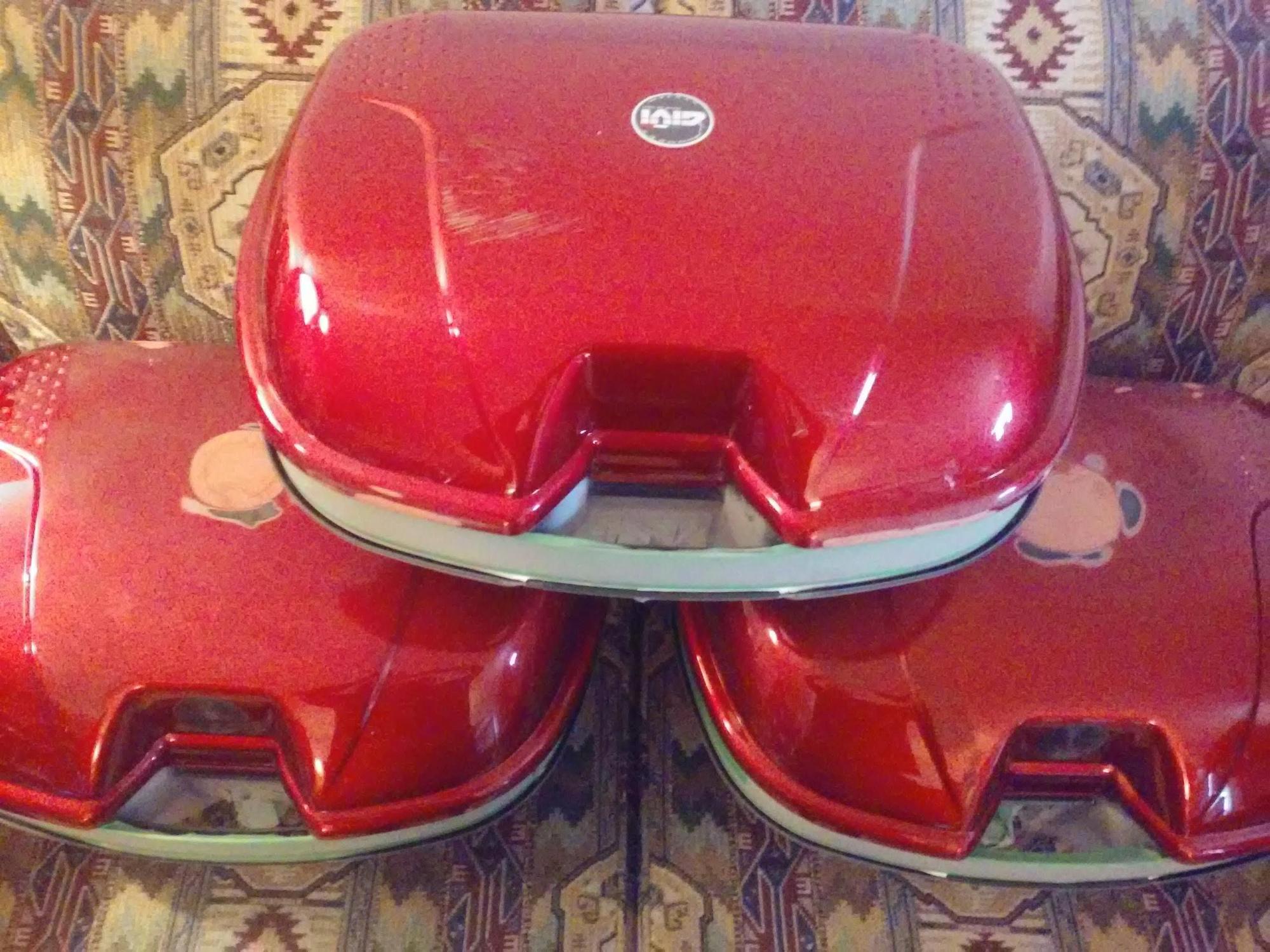

MODIFIED GIVI 360E... READY TO BE PAINTED
BACK SIDE GIVI SET 360E READY FOR PAINT SHOP. ONCE PAINTED WILL INSTALL LED TRIPS ON ALL THREE BAGS. LEFT RIGHT TURN SIGNALS AND STOP LIGHT ON TOP CASE...
MOVING GIVI BADGE...

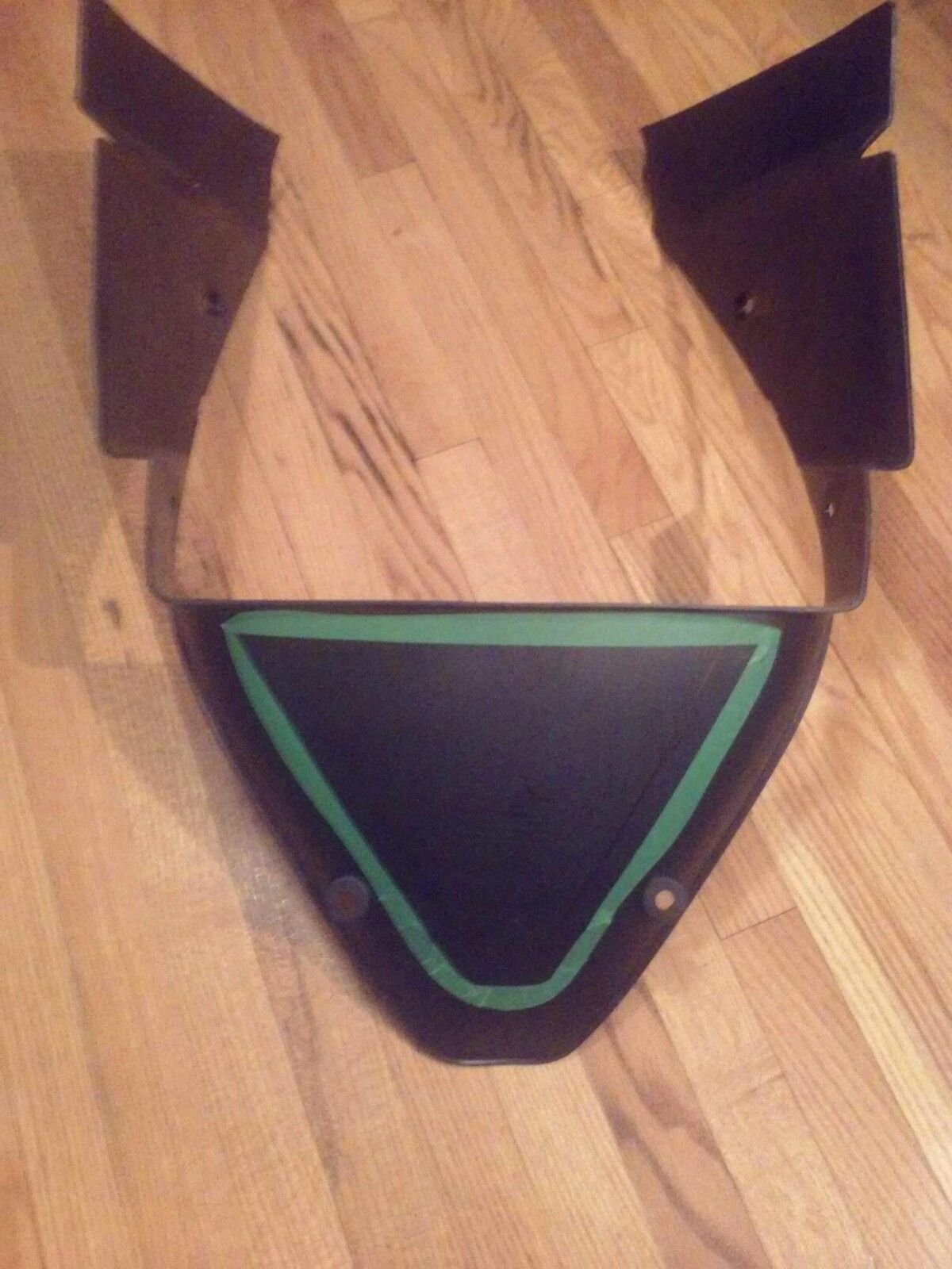

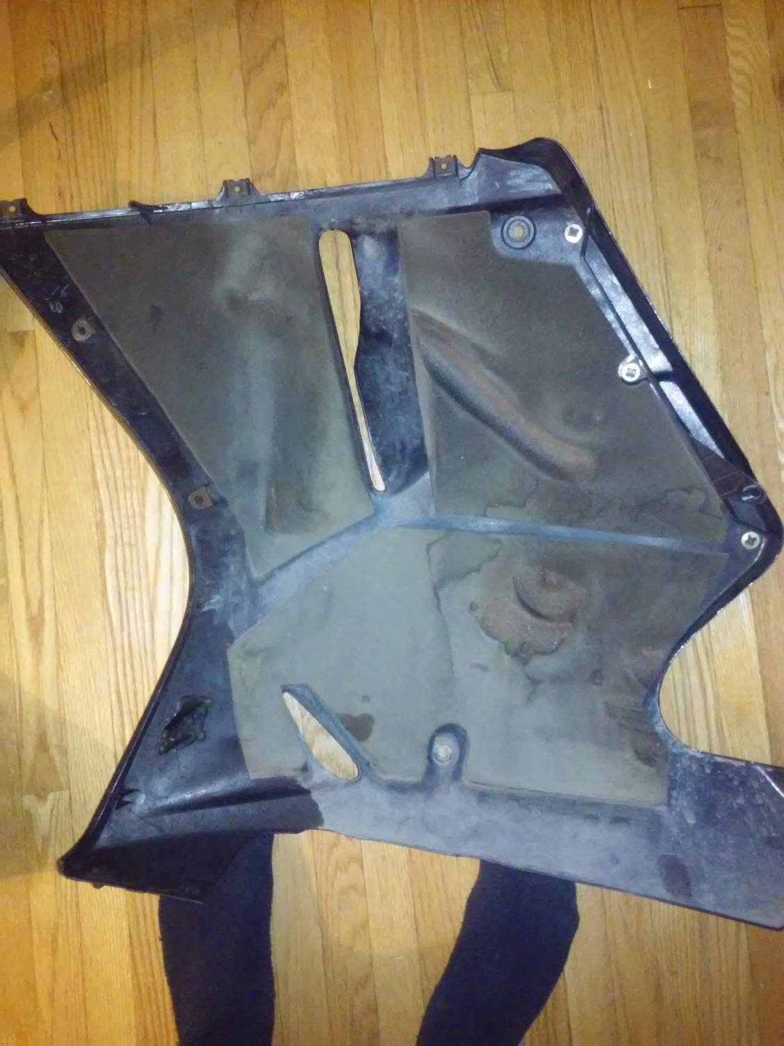

PREPPING LOWER FRONT COWLING FOR CUTTING.
RED HEAT RESISTANT SILICONE

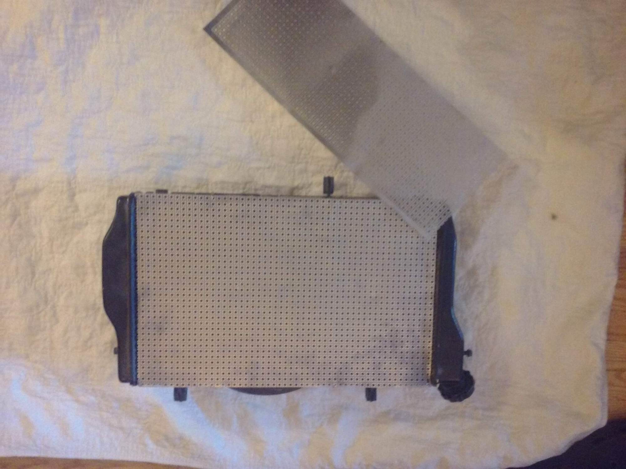

$200 BUCKS! PLUS SHIPPING, PLUS IMPORT TAX, PLUS LOCAL TAX , PLUS! PLUS! NAW!!! MAKE MY OWN RAD & OIL COOLER GRILLS!
COMPLETED RAD & OIL COOLER GRILLS! COST? $0 LANDLORD HAD THESE GRILLS LAYING AROUND IN HIS SHOP! ACTUAL COST? 4HRS OF TIME. DUE TO THE POSSIBLE RESTRIVENESS OF THIS GRILL SET UP I WILL BE ADDING A BYPASS SWITCH FOR THE FAN. MAY ALSO ADD A FAN SYSTEM FOR OIL COOLER...

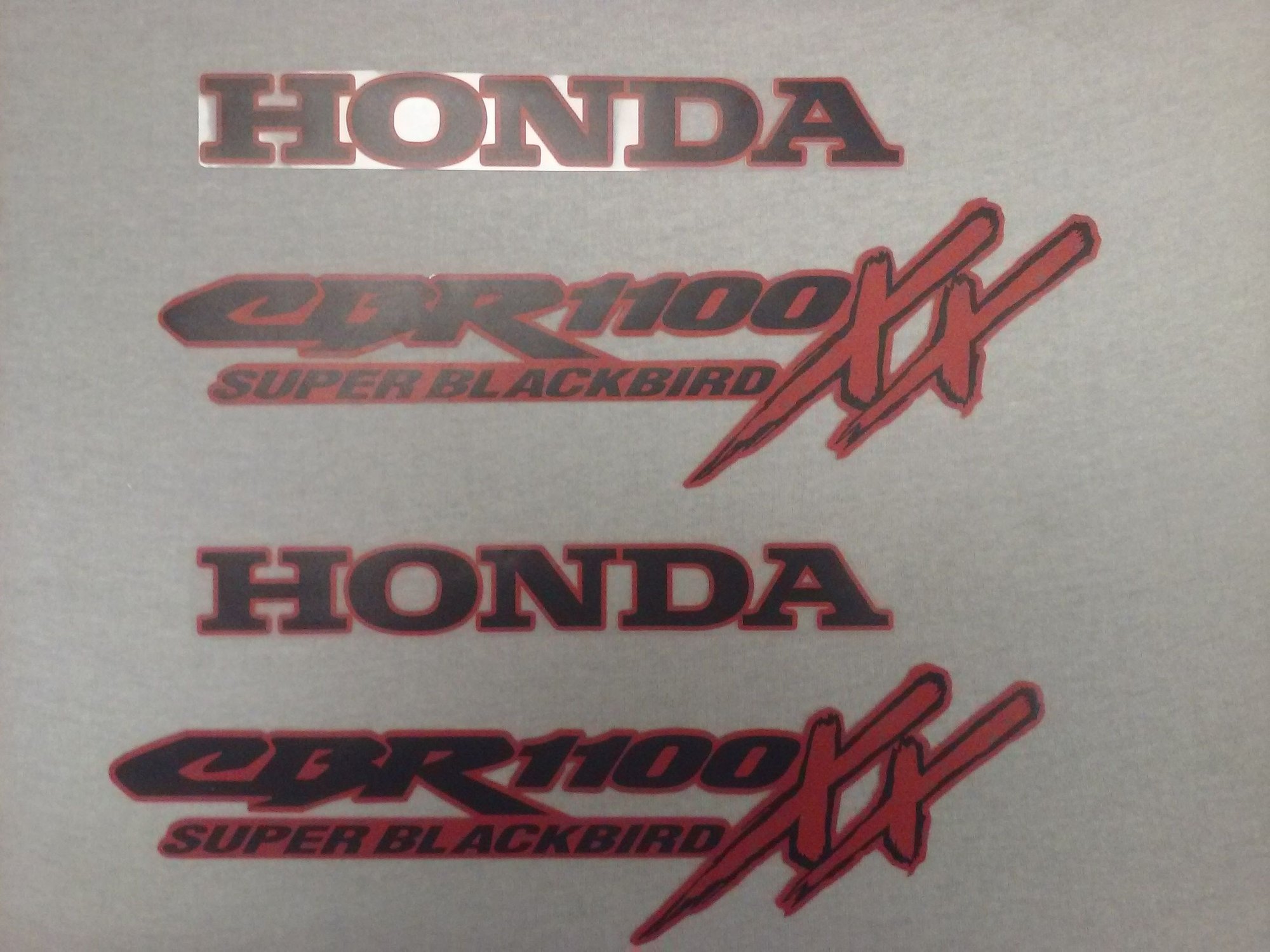

CUSTOM DECALS! SECOND PRINTING ON CLEAR COMPLETE! NOT SHOWN IS THE HONDA TANK WING! CAME OUT AMAZING! IT'S SICK! BUT WILL SAVE THAT FOR LAST! HAVE MY GRAPHIC ARTIST BROTHER TO THANK FOR THAT ONE! BASICALLY TOOK EXISTING DECALS AND SLIGHTLY MODIFIES THEM.

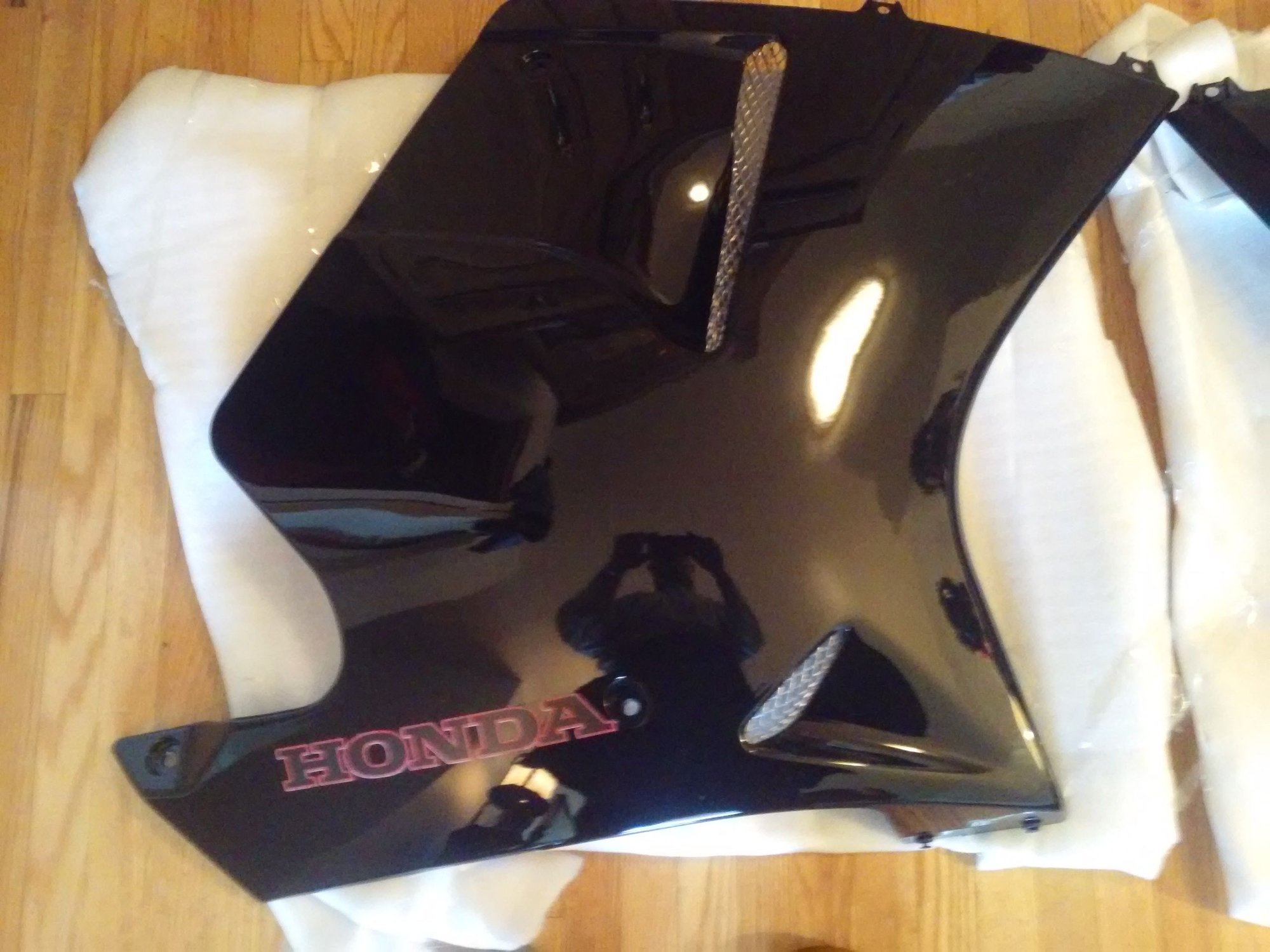

LEFT SIDE PANEL NEW. HONDA DECAL INSTALLED THEN WAXED AND BUFFED. "BLACK FRIDAY"

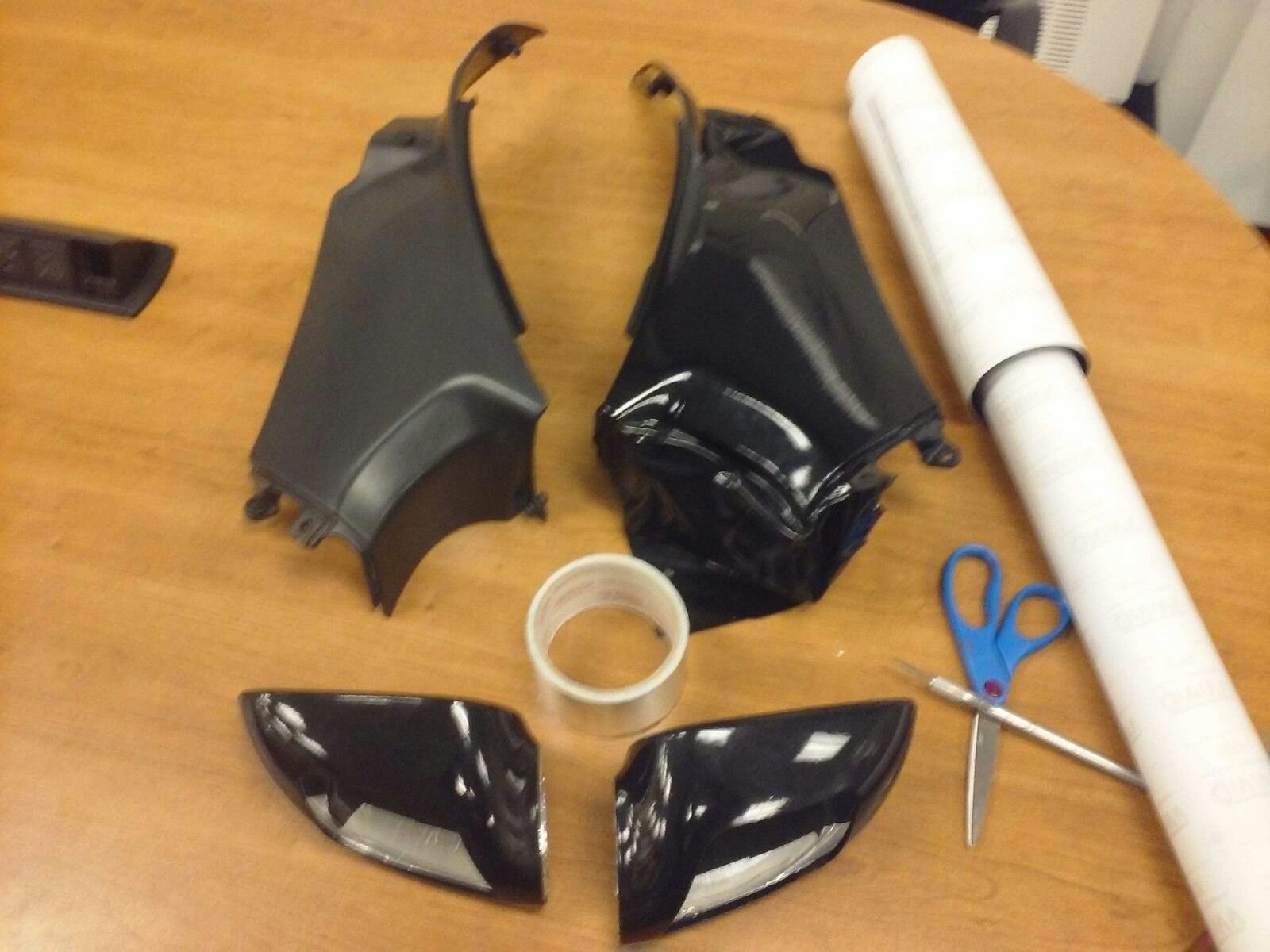

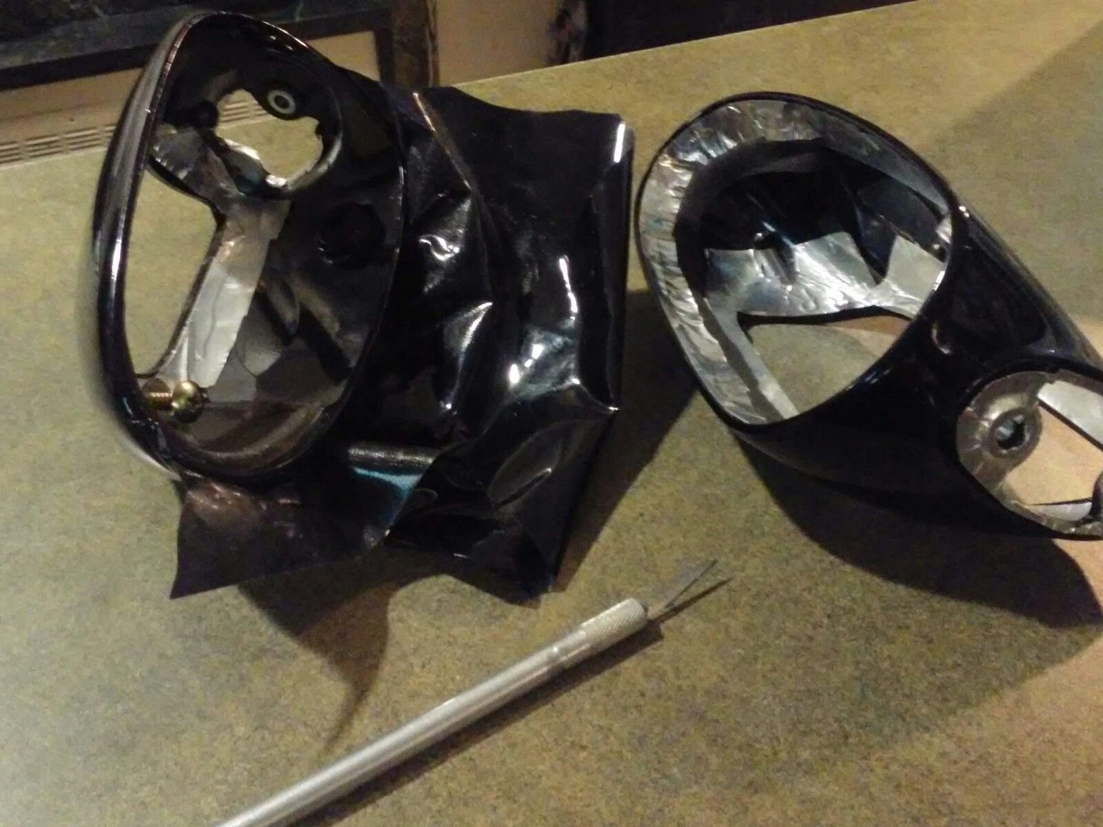

PREPARING FOR VVIVID VINYL BLACK GLOSS WRAP APPLICATION ON SIDE PANELS AND TURN SIGNALS. TOOL OF THE TRADE- HEAT GUN, EXACTO BLADE AND ALUMINUM DUCT TAPE. AND PATIENCE! LOL MEDIUM SKILL REQUIRED...
ALMOST DONE!

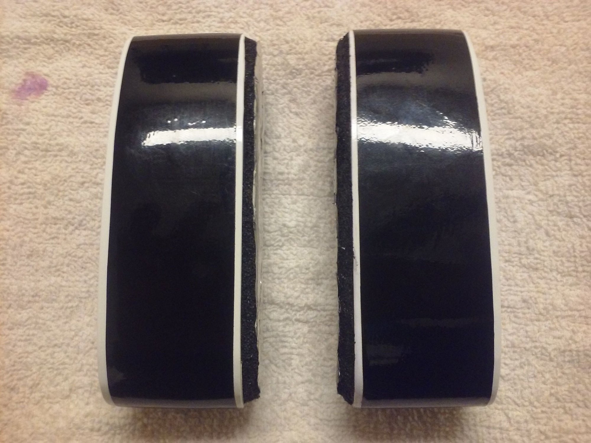

COMPLETED PANELS AND TURN SIGNALS. TURN SIGNALS HAVE SWITCH BACK LED BULBS

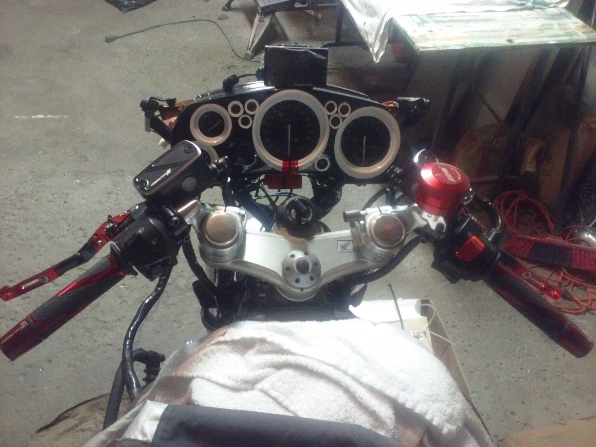

SLOWLY PUTTING THE MONSTER TOGETHER... NEW BLACK & RED GRIPS, NEW B & R LEVERS, NEW B & R BAR ENDS, NEW RED CHAIN OILER(Half turn after every 3rd or 4th fill up at the pump), NEW BLACK RESERVOIR COVERS, BAR RISERS, INKED IN HONDA LOGO, REMODELED DASH WITH 3" SCREEN FOR FRONT AND REAR CAMS AND GEAR INDICATOR. SIDE NOTE - Right top of clamp portion above bar riser is a cylindrical 3/4 inch magnet. Old trick! Whenever I lock up my bike even with my alarm system I place the magnet over the ignition key hole to remind me of the disc lock! Fell over many many moons ago with my girlfriends 500 Interceptor. At lunch time near a crowded downtown square. Oh gawd! The laughter once they saw me remove the lock! Never again! Lol

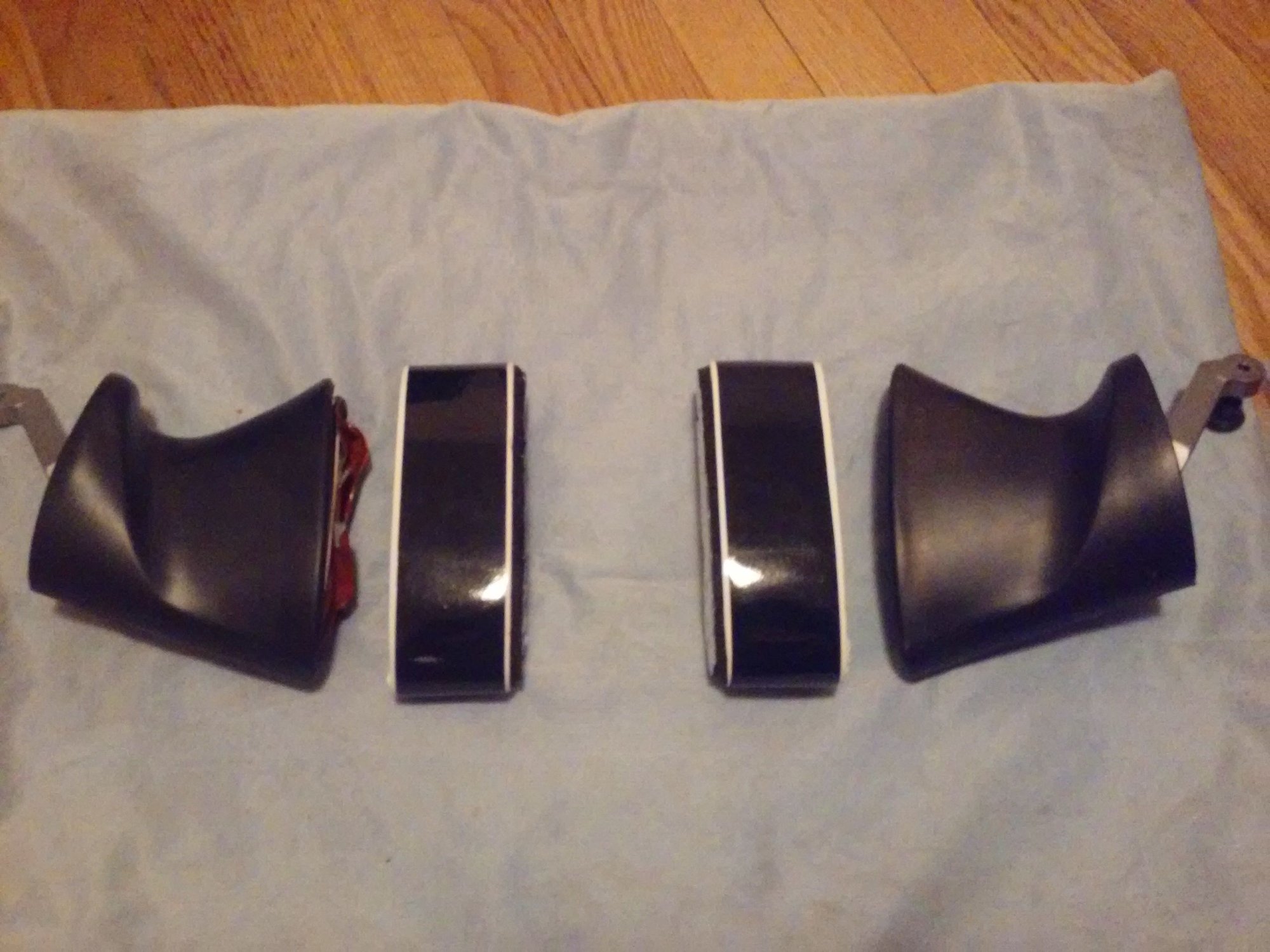

$80 BUCKS! PLUS SHIPPING, PLUS IMPORT TAX, PLUS LOCAL TAX , PLUS! PLUS! NAW!!! MAKE MY OWN MIRROR EXTENDERS!
COMPLETE!
COMPLETE!
COMPLETE! MADE THEM A TOUCH LONGER...
ALMOST DONE!
