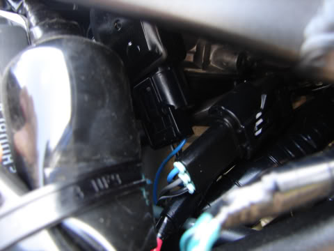

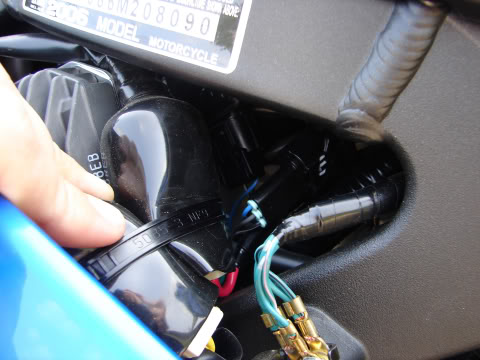

I must be realy dumb. I got allmy injector conections done but I don't know were the TPC is to hook up my power comander. NEED HELP

I bought the service manual. It is super detailed! It shows the connector below and slightly behind where the idle adjust line meets the throttle body. Its a black three prong connector. With the gas tank moved you should be able to look at the side, just below the top frame rail, and see it. Hope that helps!
i took these pics for another forum member when he was trying to locate the tps. hope it helps.
