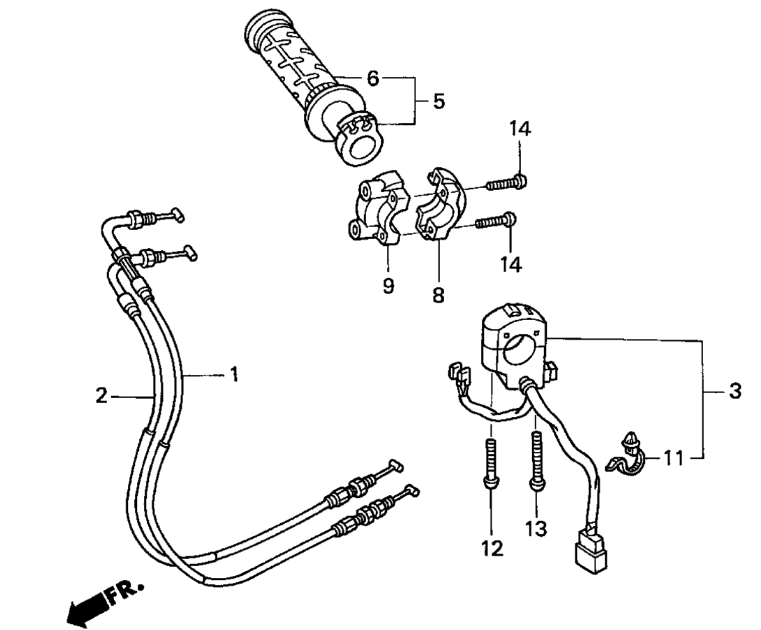

I have ordered a new Start/Stop Switch and hope that I can just remove the handle bar weight, open up the throttle and remove the throttle cables, slide the throttle and grip off, unplug the start/stop switch from the wiring harness, loosen the screws and slid it off the bar. Then install the new one.
I sure don't want to remove the right fork to get the clip on off and then disassemble the throttle and the start/stop switch.

Undo the two screws, 12 and 13, disconnect the wires from the front brake switch and the wiring connector from the headlight nacelle and the switch assembly will come away. The throttle cables stay with the twist grip, the weight stays on the handlebar etc.
In fact, it would have been worthwhile taking the switch assembly off and cleaning it out before ordering a replacement.

To replace switch, get entire assembly #3
Disconnect 2x wires to brake-lever switch
Trace start/stop switch wires down until you find its connector plugged into harness. Will be somewhere near right fork-tube under bodywork. Keep on removing panels until you see it.
