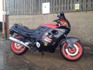

Got the speedo working off the sprocket cover drive now, not much left to do for this season now, oil change and plugs and a few other bits and pieces.
