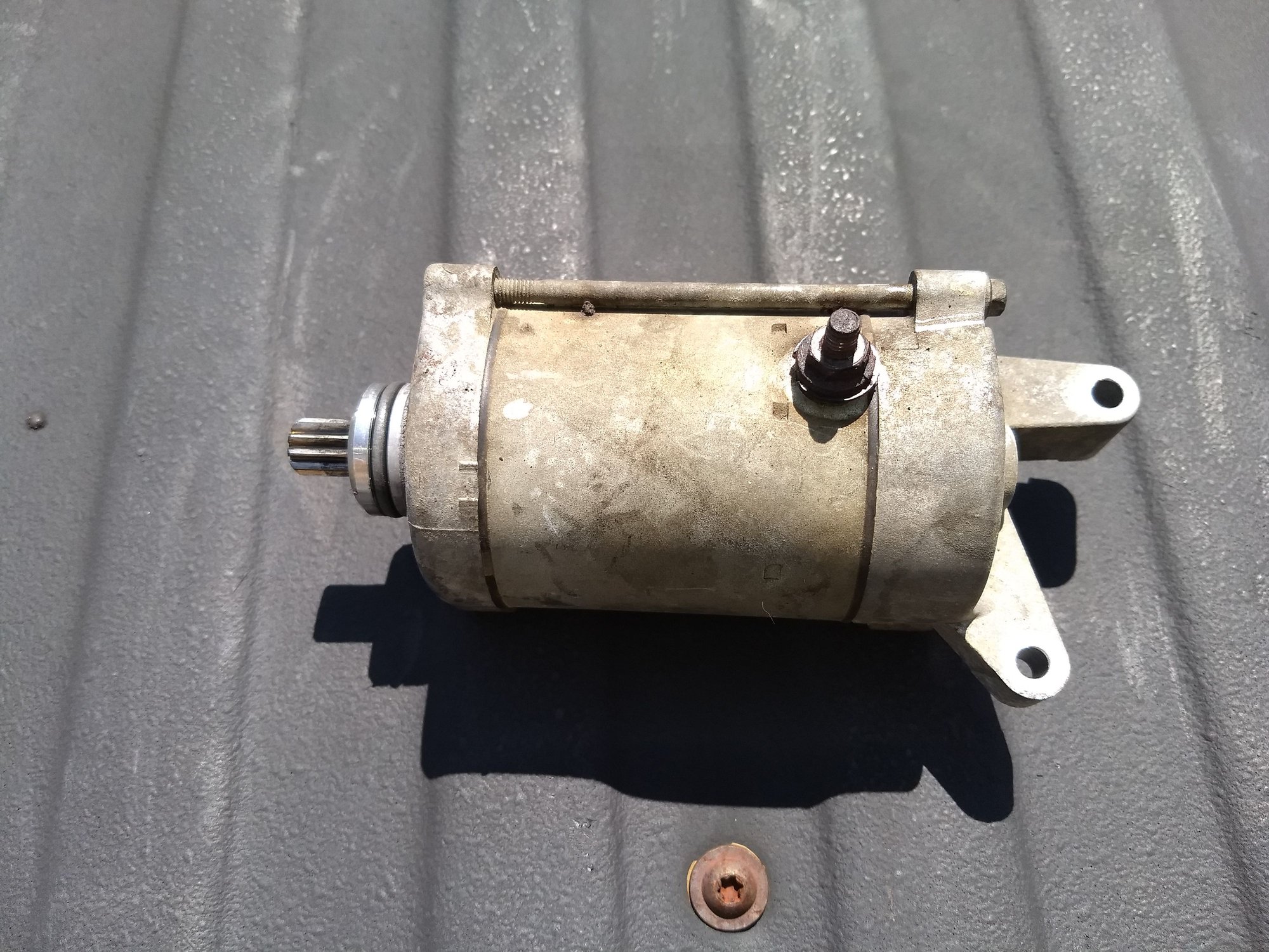

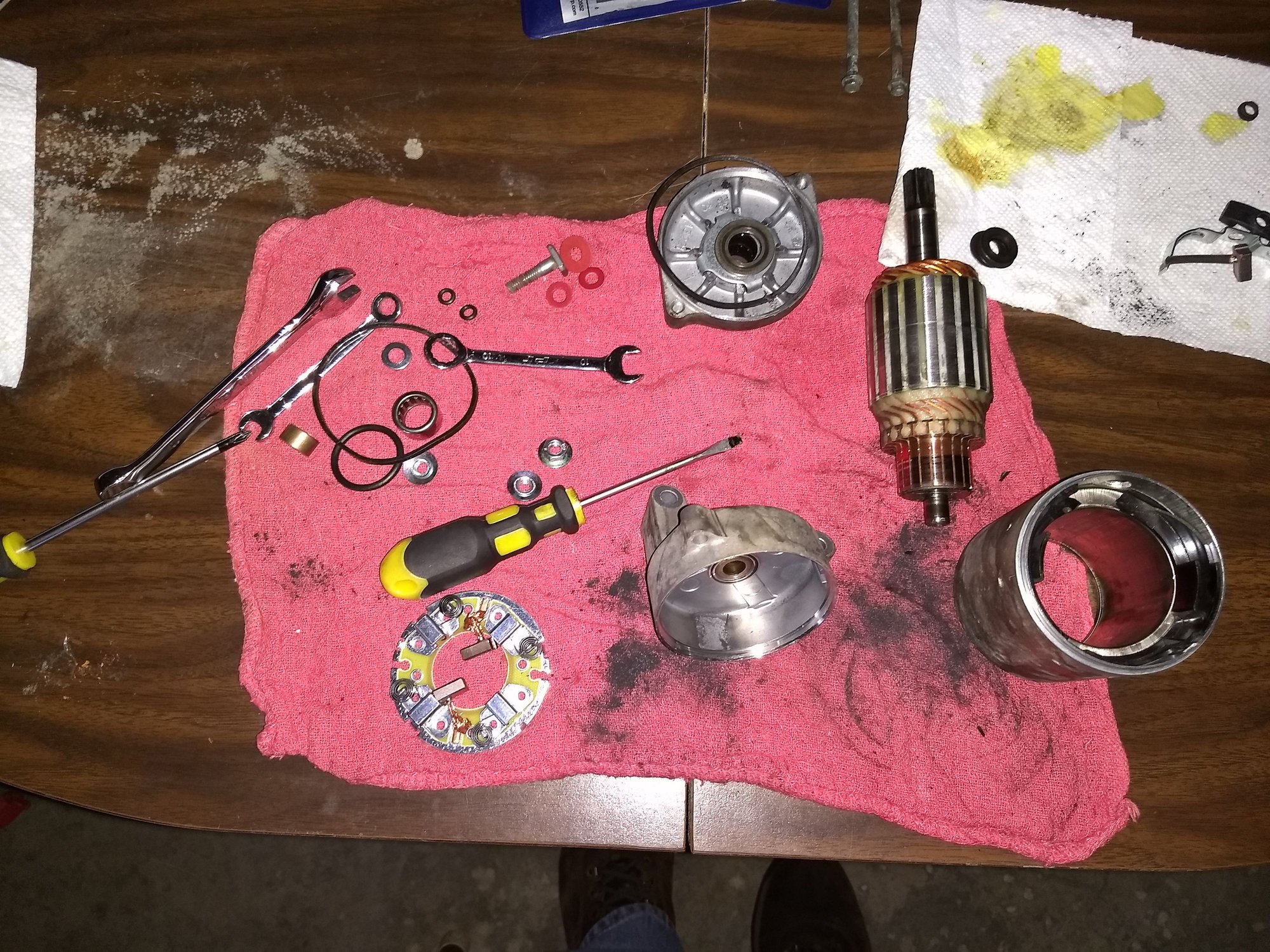

Joined: Oct 2017
Posts: 193
Also, I really think that my hard starting problem is no spark due to the starter sucking up all the juice and the ICM cuts out from that. I'm still going to completely clean my carbs as they're off, but when I crank it over with the kill switch engaged, while it's cranking over disengage the kill switch and it the engine will sputter. If I just crank it over normally I get nothing (Well, it eventually starts). New battery and recently replaced R/R by PO. The starter wire and nut is rusty an crusty from heat due to previous owners whirling the dumb thing over endlessly instead of of trying to fix the problem. I bought a rebuild kit and and it didn't come with a new stud so I had to soak it in evapo rust gel.
That was a pain to disassemble

Better photo hopefully

How did the Evapo-Rust gel work? Was looking to get some.
Old Aug 20, 2018 | 08:38 PM
  #27
GronkFries's Avatar
Joined: Oct 2017
Posts: 193
It works really good, in the photo with the starter all apart you can see the stud has much cleaner threads. You can spin a nut right on where before I was worried about snapping it when taking it off the starter housing. It took a bit of waiting time and two apply and rinse efforts, but I was able to keep reusing the gob I had on the paper towel. Works better than sandpaper or a wire wheel I think, because it only removes rust.
