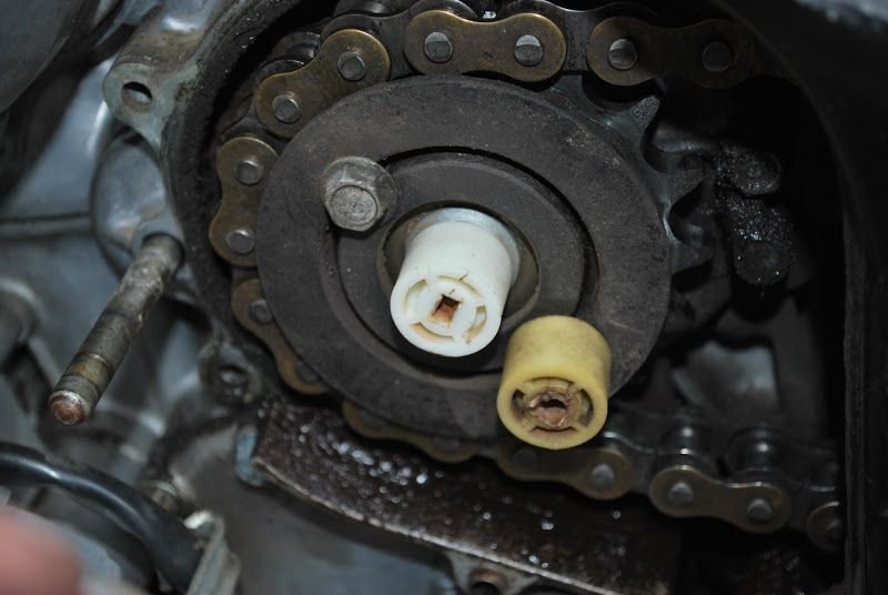

This is what I have at the moment.- see the 2 images
I only pulled this cover off to see why the cover was flexing when depressing the clutch
after I fixed the seized clutch slave cylinder. Glad I did.
1 long bolt was missing and also the bottom mounting tab was broken - so I had to buy a replacement cover which is underway
Then I noticed no bolt on the sprocket. so I'm not sure of the sprocket has been put on backwards or
I am missing the damper ring and bits if thats what you call it as well as the main washer and bolt?
Old Jul 16, 2020 | 06:35 AM
TimBucTwo's Avatar
Posts: 4,237
Likes: 15
From: Bir Tawil
The sprocket is OK.
Your missing the chain retainer. Honda put the chain retainer on in case the chain came off. It should in theory retain the chain.
However, I doubt a chain will actual come off unless it is extremely loose. So, you don't need it. When you buy a replacement sprocket, it is usually missing those two bolt holes that mount the chain retainer.
Don't worry about the retainer. Just use the sprocket retaining washer and bolt.
Here is a LINK with that plastic speedo part. If your in there, you should replace it.
