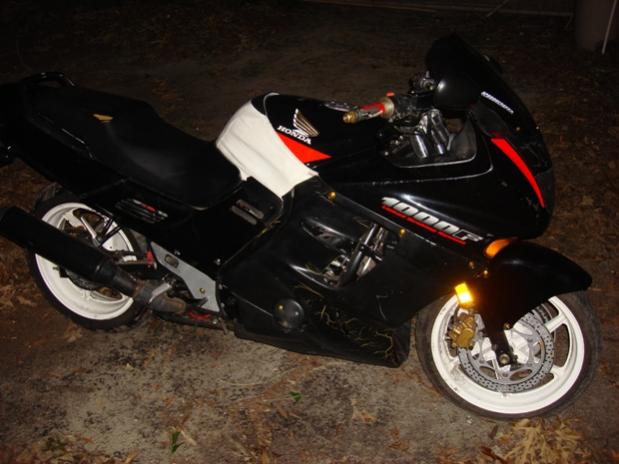

Ok maybe I'll do a photo tut on my current 1988 CBR1000F, on what brackets need to go and what needs to be made, where to drill and so forth. But only if somebody really wants this, as it takes time away from getting other things done, (Racebikes prep, CBX project, Fighter project, pro street car, off road Jeep racer, Classic Mini Cooper S restoration, and so on, plus my real job that pays the bills and takes 60-80 hrs a week, when home and gone alot, but gives me money for toys) So does anybody want this? If they do I'll get started on this today. Just give a vote here if you want it.

Attached Thumbnails F1 to F2 or F3 conversion...-1988-cbr-1000f-current-project-web-1.jpg

Me too, thats why I went this route, and the lighting is so much better, Also when I first did this the 1 gen CBR 1KF body work was more costly and harder to find than 3rd gens.
I'll count that as a Yes vote, and get started on it on Sunday.
