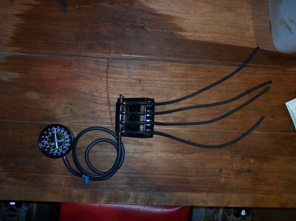

You can easily build one using some parts from the pets store and a gauge from Harbor Freight. $20.

Two? I did it with only 1 gauge. What you need is a fish tank air pump maniflod that has 4 seperate valves. Then a metre or so of tubing and a cheap gauge. You can only open the blue valve in the pic a little or else the the needle will bounce too much. #2 carb is not adjustable so you need to use that as a baseline and adjust all the other ones to the same level. Here are a couple of pics of the contraption I built back in '09. I've syched two 1000Fs with it since.
