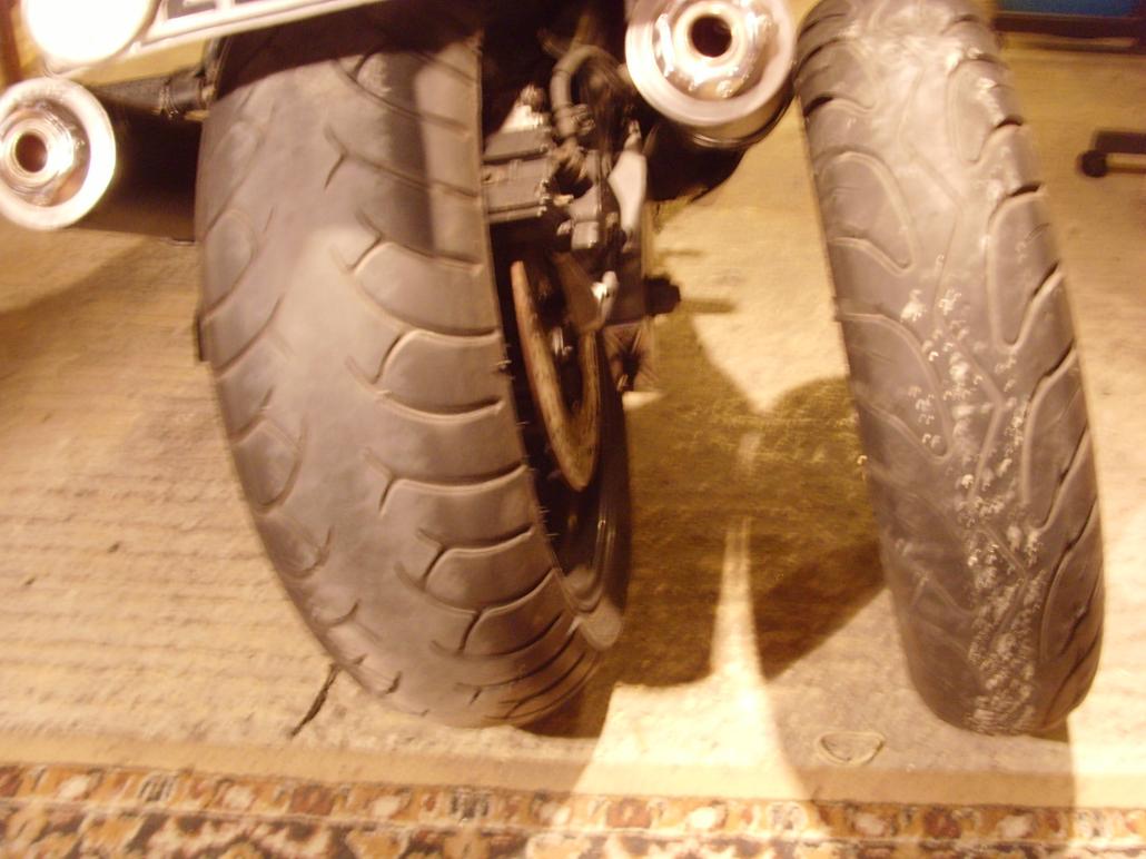

Yep can do - with keeping the original chain guard and the torque cover but removing the mudguard part of the rear hugger there is 5mm clearance on each side - I couldn't get a 190 section tyre in there. Without the chainguard or the torque cover there is 10mm clearance each side.
Here's another pic;
Here's another pic;
