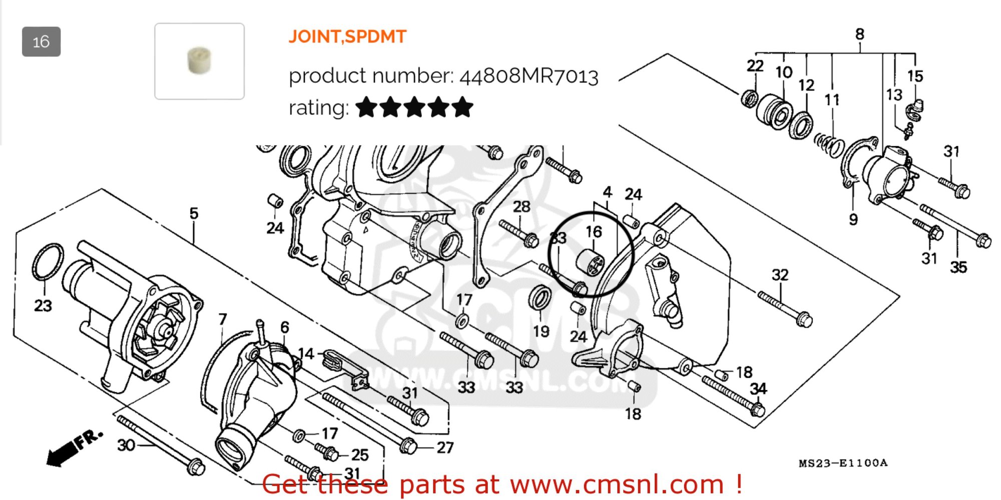

I'll take the easy one, the speedometer. The most common reason for speedometer failure is a plastic connecting piece that's easy to get and fit.
It's item 16 in this parts diagram, just behind the cover where the speedo cable ends on the left side of the motor:
My bet is that you'll find your 'joint' is chewed out where it interfaces with the countershaft sprocket. They all go that way sooner or later.
I'm sure other members will assist you with your other problems.

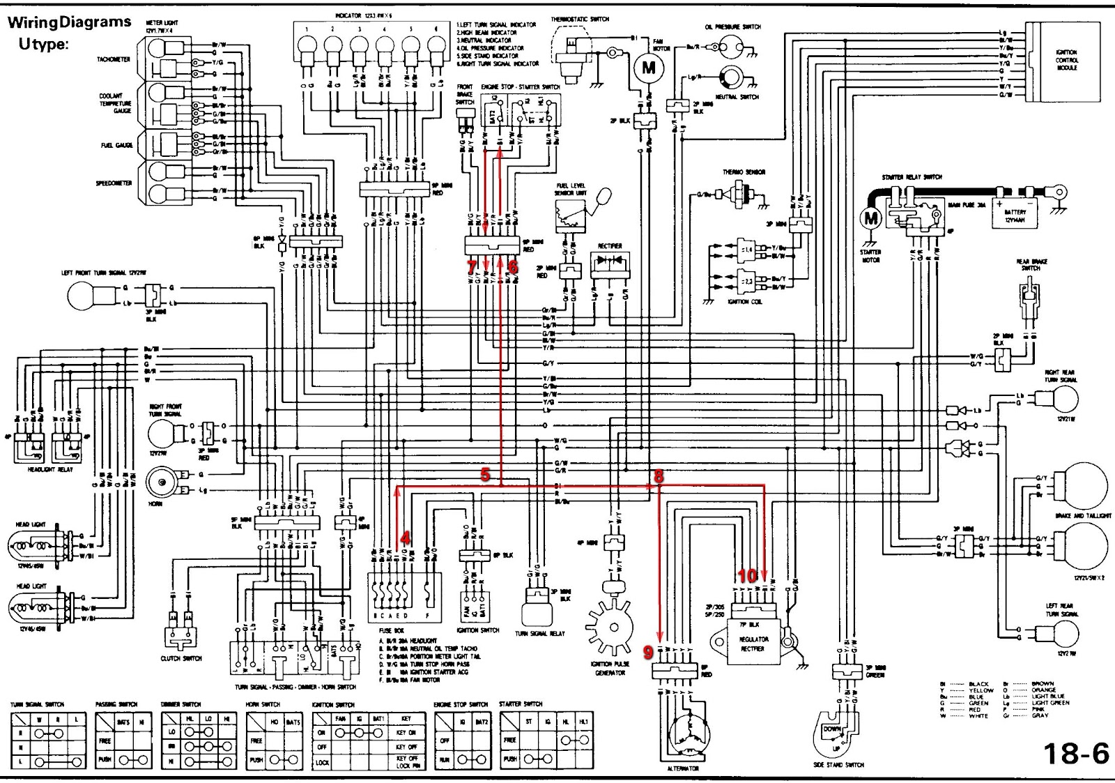

Here’s diagram.
1. Trace each and every wire and make sure both end-points connect ONLY to where they belong on diagram.
2. Remove ALL extra wires and connections that don’t exist on diagram. Disconnect blk wire from headlight ground. Is this factory or extra wire you installed? Where is other end connected?
3. Then measure resistance of ALL wires end-to-end to make sure wire isn’t broken.
- stator wht wire only connects to regulator, so it shouldn’t touch anything else, hopefully you didn't fry regulator by applying power to this wire.
- stator blk wire also connects to regulator turn-ON terminal. This comes directly from fuse E. If you’ve got power on blk wire at fuse box end, and no power on same blk wire at other end by RR & stator, obviously you’ve got broken wire in between!!!
Unless you’re Superman and can see electrons moving inside wires, there’s absolutely zero way any human can just look at wires and determine its ability to conduct electricity. Luckiky, we have instruments that can.
4. Key ON, measure power at blk wire leaving fusebox, volts = ???
5. measure power on blk wire at junction splitting off to start/stop switch, volts = ???
6. measure power at blk wire at connector of right-controls, input start/stop switch, volts=??
7. Start/stop=RUN, measure power at blk/wht wire at connector of right-controls, output start/stop switch, volts=??
8. measure power on blk wire at junction going to stator & RR, volts = ???
9. measure power on blk wire at stator connector, volts = ???
10. measure power on blk wire at RR connector, volts = ???
You'll make series of measurements like this:
fuse E 13v -> 13v -> 13v -> 13v -> 13v -> 13v -> 13v -> 13v -> 13v <- 0v AHAH!!! <- 0v <- 0v <- 0v <- 0v stator/RR
These numbers in proper sequence will tell you exactly what problem is and how to fix it. It's between where you measured 0v and previous test-point that did have power. Most likely corroded or broken connector or wire along way.
If you measure full battery power for tests #6 and 7, then start/stop switch is perfectly fine. It doesn't have anything to do with power to RR and stator blk wire anyway, so stop wasting time on that. If you can crank bike, have power at igntion coils and ICM, start/stop switch is PERFECTLY FINE!!!. Doesn't have anything to do with power at blk wire @ stator and RR anyway. In fact, you can completely remove start/stop switch from bike completely and you'd STILL have power at blk wire @ stator and RR.
But… if you don’t have full battery power at blk wire at RR and stator, then you’ve got broken wire between fuse E and RR/stator. Replacing start/stop switch won’t fix anything because you’re replacing perfectly-working parts with brand-new perfectly working parts and nothing changes. And it doesn’t have anything to do with power on blk wire at RR or stator anyway!
Find actual problem before you make any changes to system. Otherwise you’re wasting time & money without any fixing anything. What measurements have you made where? And what are the numbers you measured?
btw - yel/grn wire drives tach directly from ICM. Measure resistance of that wire end-to-end. Then trace it from end-to-end to make sure nothing else touches it. Most likely there’s an extra wire someone strung to dash that’s interferring with normal power from 10a fuse.
Remember, don't get cause and effect mixed up. The result/effect you're seeing, no power, no tach, etc. is just by-product of real problem. Find what's causing problem, then fix that only (broken wire), and all effects of no power & no tach automatically fixes itself!
