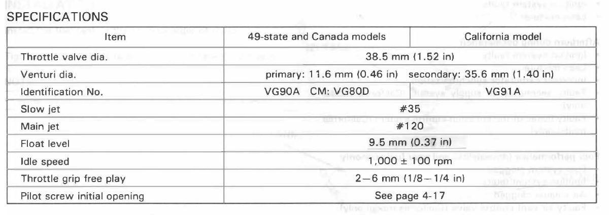

Hey guys, so I have a 88 Hurricane and just a single question to ask...
Do you guys know what size of gas nozzles should go in the carbs?? I need both sizes, the nozzle for the low end and nozzle for the high end. I will put a picture of what Im talking about, in case i didnt made any sense.

It should be in the manual. This is what I see for the '87-88 stock carbs/jets

They are jets - not nozzles.

go with 125 or 129 mains and 40 pilots with 2 1/2 turns out on the air/fuel mixtures.
https://carbjetkits.com/bikes-with-j...alculator.html
