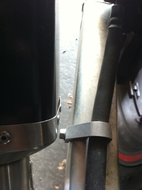

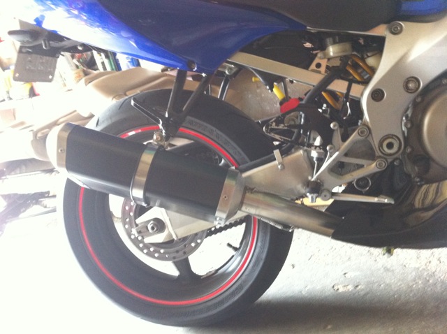

Here are some pics of the revised install.
As mentioned earlier, the clearance is minimal... the canister had to be rotated (which actually looks more trick to me)
The hardest part is getting the midpipe clamp bolted onto the passenger peg as there is some elbow grease and finess involved...
Or you could just get a new longer clamp..
