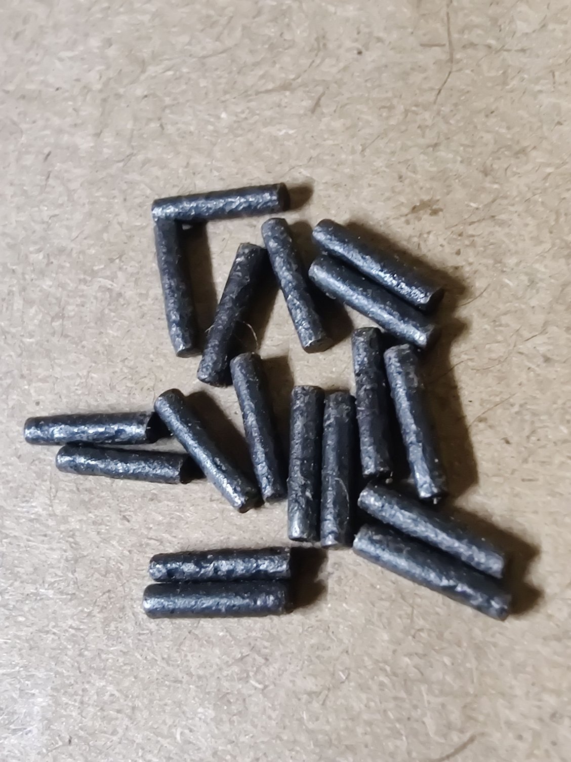

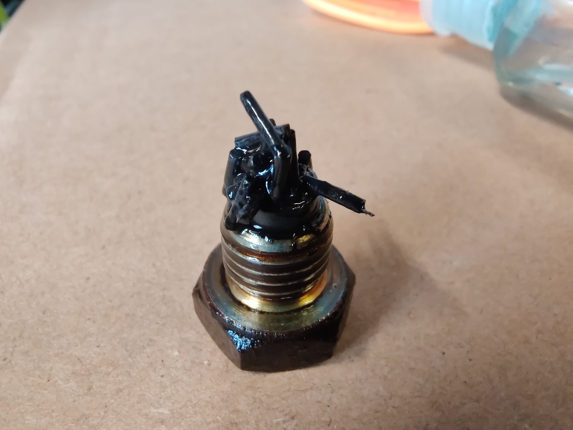

Changing the oil yesterday on my 2005 CBF600S (Shares an engine with CBR, but detuned) - Found a load of what seem to be needle rollers on the sump plug and in the sump when removed.

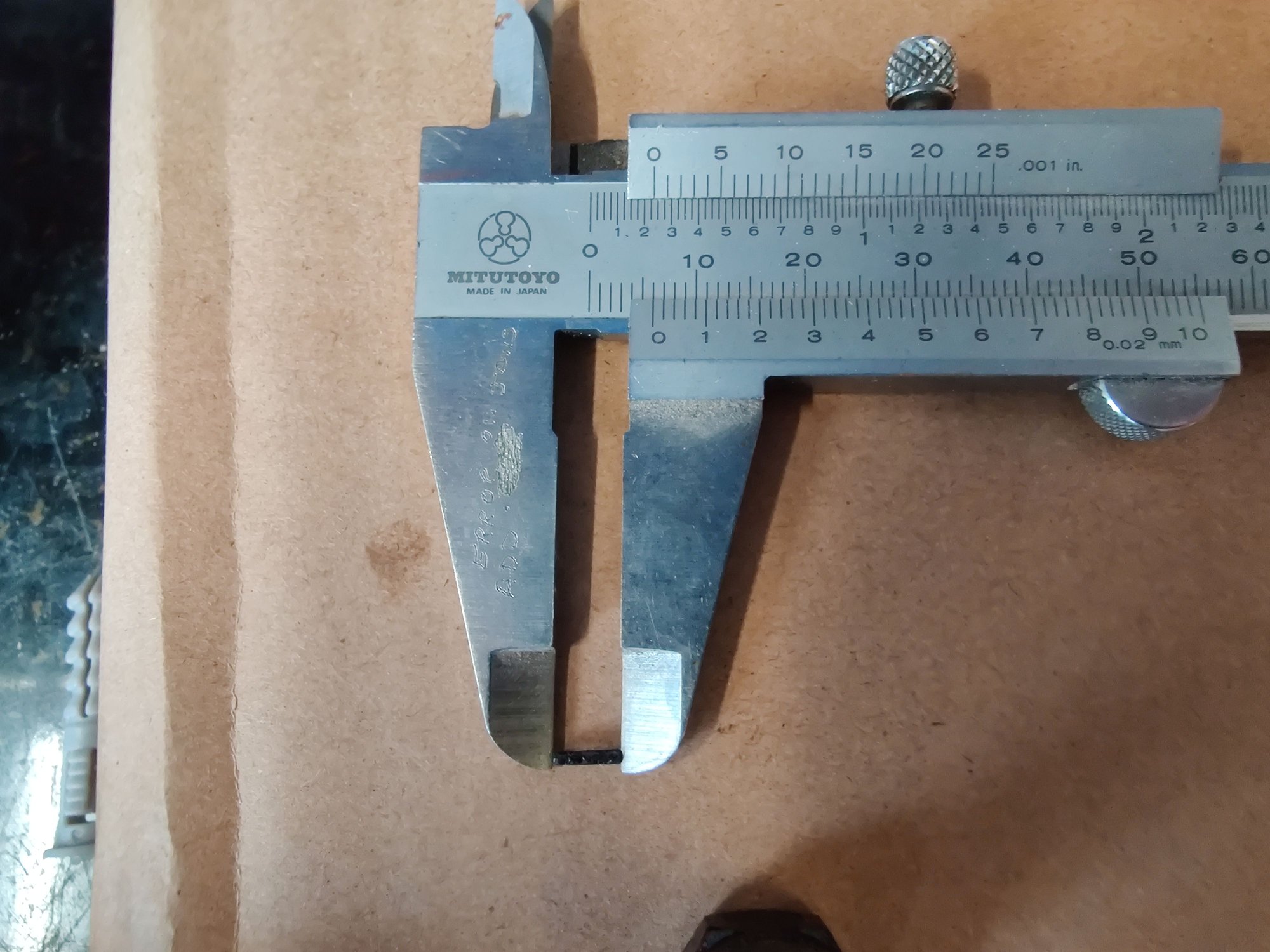

1 or 1.25 diameter x 6mm length. 18 found.
They look a bit chewed up, and like they've been there forever... so hard to determine original diameter
Can anyone help identify which bearing they might have come from?

Found the culprit - one of the needle roller bearings for the clutch lifter lever in the clutch case cover.
18 needle rollers, all recovered.
