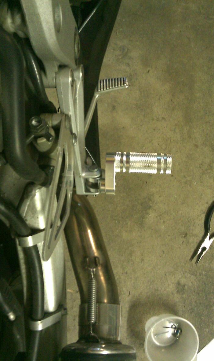

Originally Posted by gotcbr
So, how did these work out for you? Got pics & feedback on them?
They are probably the best solution for what I was looking for. Much cheaper than replacement rear-sets and very easy to install. I moved the right pet forward about an inch and raised it slightly so my toe wouldn't rest on the brake pedal. (Cycle Pirates carries adjustable brake pedals for some bikes, but not the F4. The adjustable ones let you extend the length). I don't have issues with my left knee, but I moved the left peg forward about half an inch, just so the two sides feel about the same. I might go back to the stock position on that side later.
The only thing that keeps the whole assembly from rotating around the mounting bolt is the torque you put on it, some lock-tite, and a small metal dowel that serves as an indexing pin. I don't know how durable this would be in the long run if the pegs frequently touch down, but it would be a very easy fix if the dowel pin breaks.

Thanks for the pics & info. Was wondering how these would work out. Very interesting. Glad these are allowing you to keep riding your bike.
